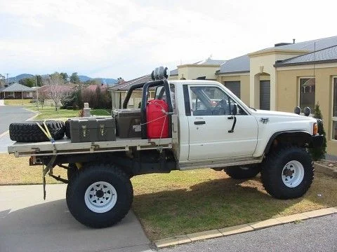

I see that on almost every Aussie rig and cannot find out why myself. :confused: The Man-a-Fre catalog shows one in every pic almost.
Does somebody know something I/ we don't? :confused:
Inquiring minds want to know.
