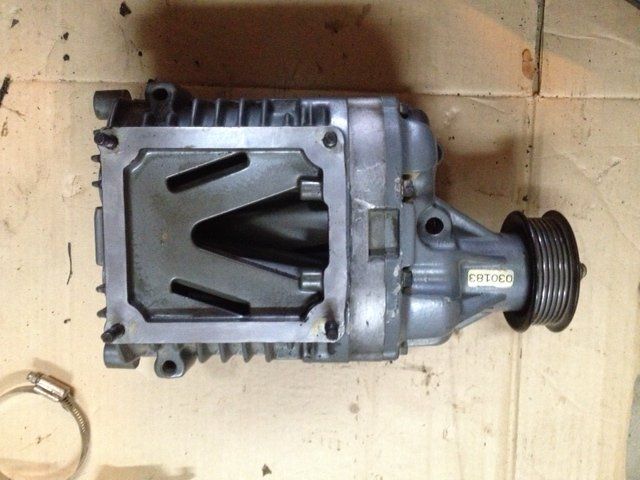

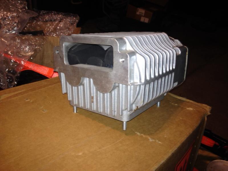

Pics for clarity. First one is generation 3. Second one is generation 4. I assume the plenum included with the kit must be different depending on the generation.

It looks like the bolt pattern might be the same, so perhaps some sort of adapter could be made if necessary.
An adapter would move it up the height of the adapter, causing potential hood clearance issues, and belt length might need to be longer if it's more than the tensioner can accomodate, so sourcing a proper belt could be a problem as well. Just some things to watch out for.
Supercharger is on it's side so it would only move over not up. Belt length may be an issue. The snout of the new one is longer too so the adapter would need to move it back. Probably buying a new kit is the only answer. I bet the throttle body adapter is different too.

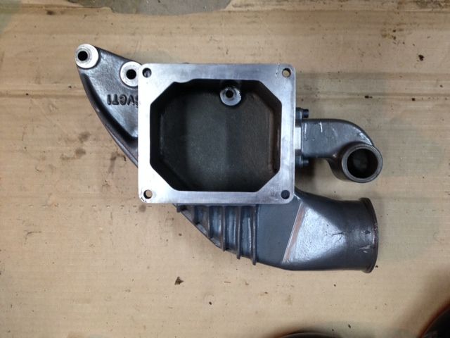

Here's some pics of the older style plenum and throttle body. Can someone with the new style plenum and throttle body post up some pics please? It would be nice to see how close they are in case some sort of simple adaptation is possible.

Back of the 4th generation supercharger (which is called an MP90 by Eaton). There doesn't appear to be anything significantly different here. Perhaps the throttle body adapter is the same between the old and new kit. If that's the case, then adapting the newer supercharger to the older kit would just require adapting it to the plenum so that the pulley winds up in the right spot and it is sealed.
You can not fit an old adapter to the back of the new blower. I found this out the hard way.
I was told by my TMS connection that you basically need to start all over.
If a guy has a first gen blower and it grenades, he gets to buy a whole kit to make a current gen blower work.
