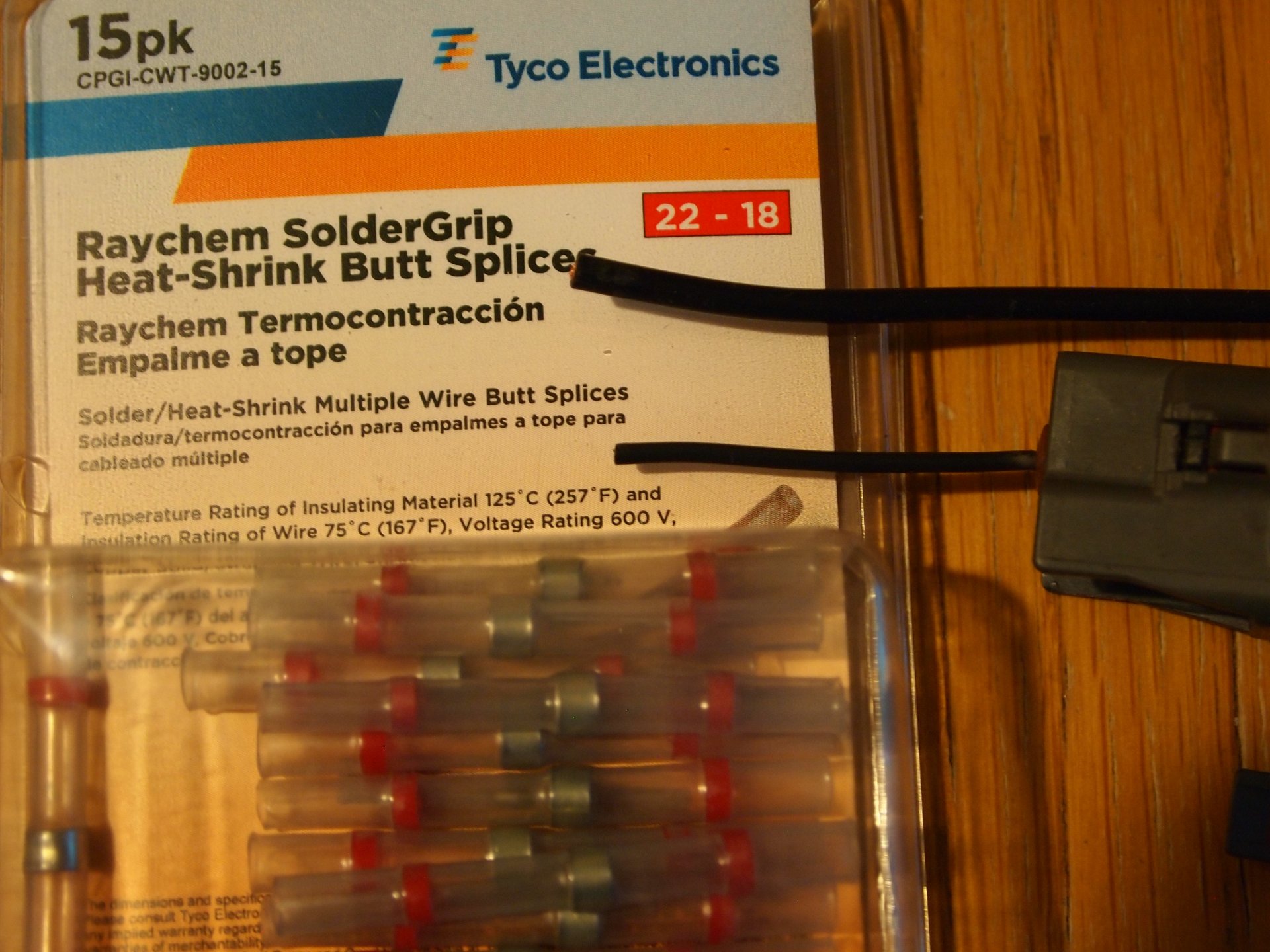

Anyone have a part # for the oil pressure sending wire pigtail/plug?
BTW: To fix that one wire, with a few cooper strand cut. Toyota sell the pig tail. You remove the one pin w/wire from the wire housing block. Slip in a new pin w/wire and splice.

I need to do this for both camshaft position sensor and oil pressure sending unit. Does Toyota sell pigtail/plug for both?
oil pressure sender connector is 90980-11363 repair wire with terminal is 82998-12440
cam sensor connector is 90980-11016 repair wire(s) with terminal are 82998-12440 same as above. Both 2.3 terminals
I have those terminals but only for 18-24 gauge wire not sealed.
Trick when wire smaller than butt splice. Place a shrink wrap on smaller wire sheathing, to increase OD. I think is was @flintknapper tough me that one.
