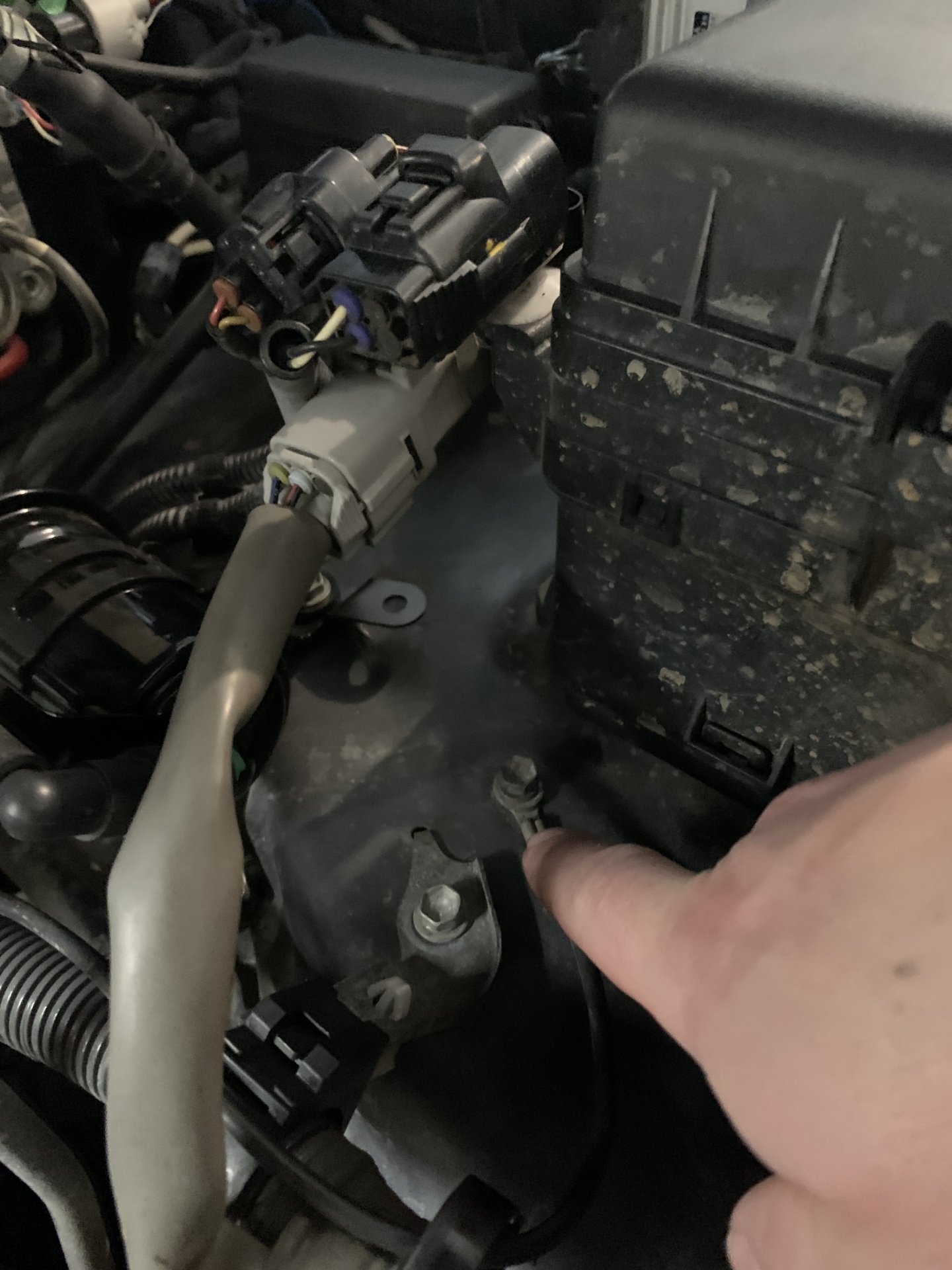

And then I found this ground wire that connects to the hoist bracket super loose.

Body grounds, it doesn't hurt to clean metal bare and tighten.
