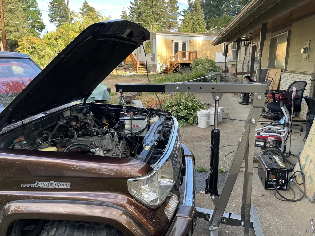

Getting ready to pull the head with exhaust and intake still attached

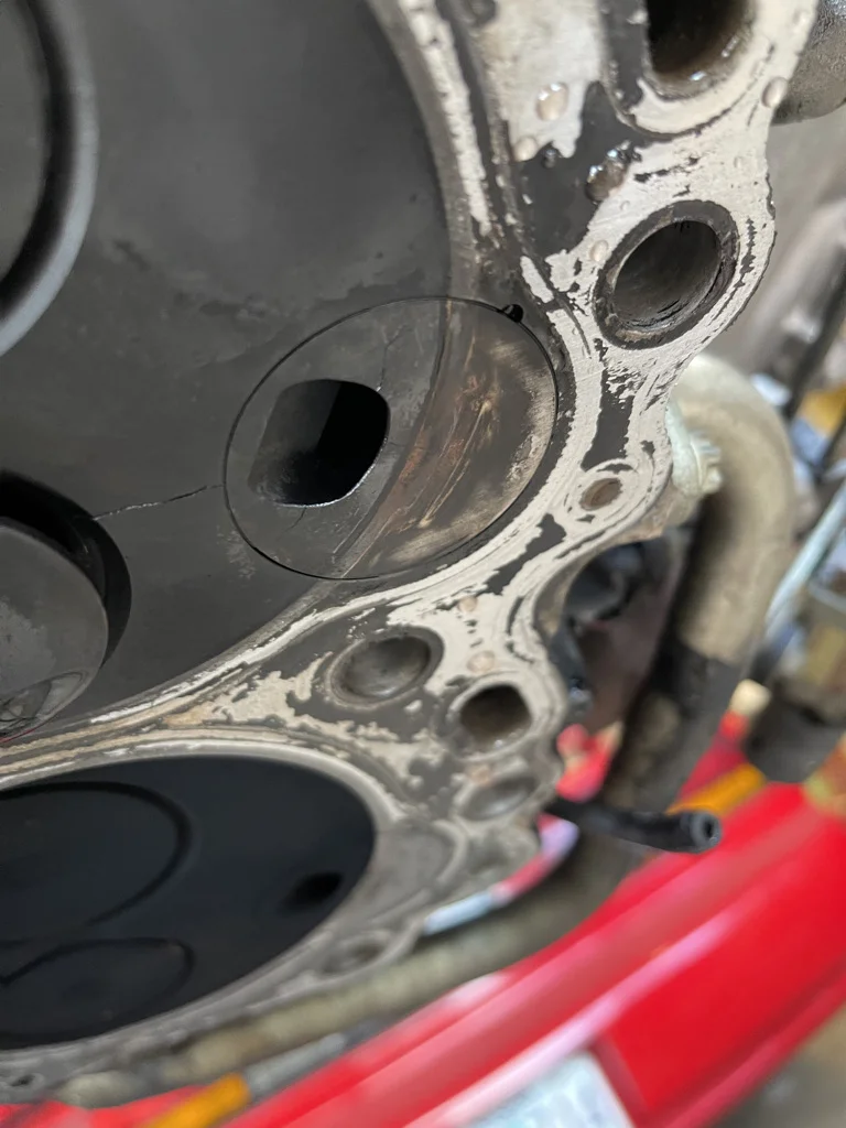

Crack was easily visible coming off this valve on number 3. Also less carbon, indicating coolant getting into the cylinder.

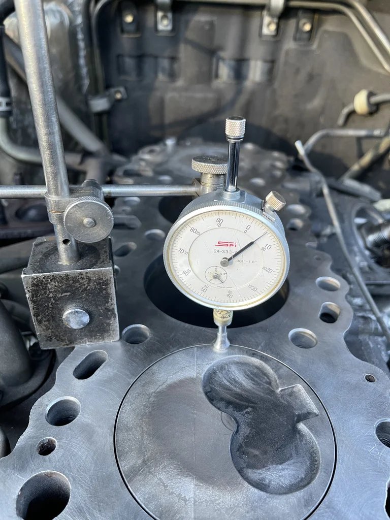

Block surface cleaned - taking Piston protrusion measurements to determine which head gasket to get - it was the No.3 (3 hole) gasket.

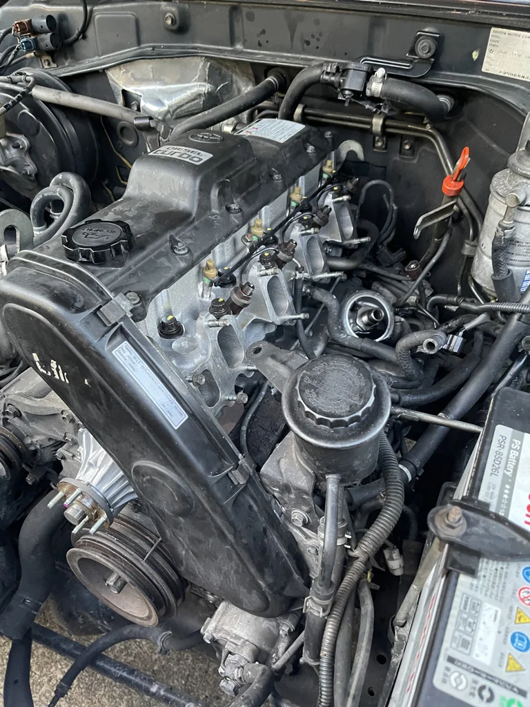

New AMC head and head bolts, on and torqued. New water pump and pump housing, new glow plugs. New timing belt, timing belt idler and tensioner. Just the intake & exhaust manifolds, radiator/fan, and some electrical plugs remain in this pic. Hopefully she is good for another 100Km.

1KZ-TE cylinder head crack is very common for EFI engines. same with the 2LT-E .
they always crack although the engine is standard. when it is not EFI the head dont crack.
The problem is more related to IDI + turbo = issues. It's pretty consistent across the board. Even 1HZ has issues with turbo added. The reason it seems to happen more on the EFI ones, is they have EGR etc. too which clogs up the motors and make them run even hotter.
Fueling is really important . 1hz they always have problems like overheats, crack cylinder head , oiling issues. Turbo or n/a . With turbo 1hz die faster&earlier.
Would never consider turbocharging a 1HZ without also adding an Intercooler.
