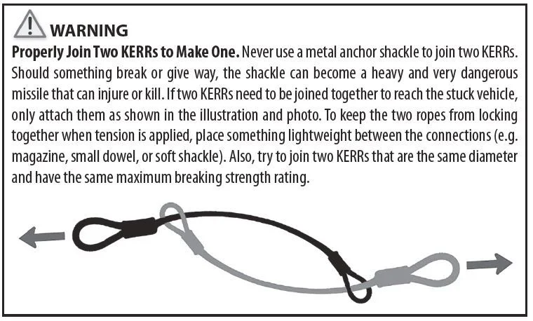

I have some solid guides from extremely reputable sources, and they agree it's ok and even good practice to use a static strap like a tree saver to create a bridle and attach a kinetic strap to it. Here is an image directly from a handbook on best practices. Something to keep in mind is they suggest tying kinetic straps directly to each other instead of joining with a metal shackle for obvious reasons - see second screenshot below. Recovery is one of those topics that can be discussed forever, and everyone will have a slightly different opinion. I personally think you should always adhere to best practices when possible, but there are times when the situation calls for being creative and using whatever you have to extract a vehicle. I once had my 100 stuck in a marsh that was quickly filling with water threatening to drown it, and after 5+ hours we eventually got it out using the winch, winch line extension, kinetic strap, and tree saver all daisy chained together to attach to a truck over 100' away with tow truck wheel chocks under it because it would just sink into the ground or slide backwards under any tension. We literally used every single piece of equipment in both vehicles to get it out, so keep in mind in the real world you need to be resourceful and creative sometimes to get the job done.

Be careful when you are combining static and kinetic lines to ensure that you have a plan for when the kinetic rope unloads. When it's just two vehicles tied together it's not going anywhere, but with another line, potentially a shackle or other connector, plan for what is flying when the rope unloads. Also, you wouldn't want to use a kinetic rope for a fixed anchor such as mounting a snatch block etc.
