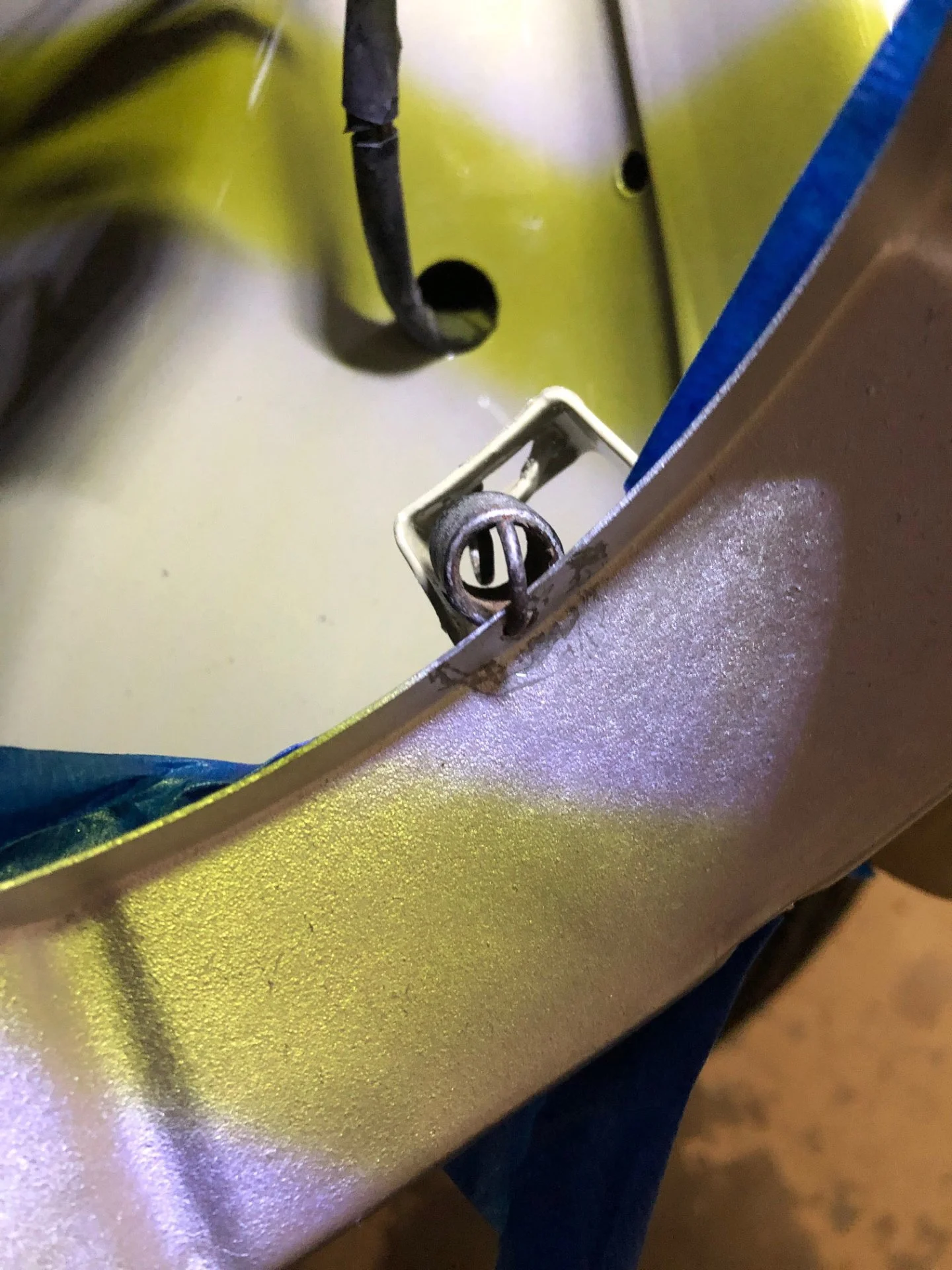

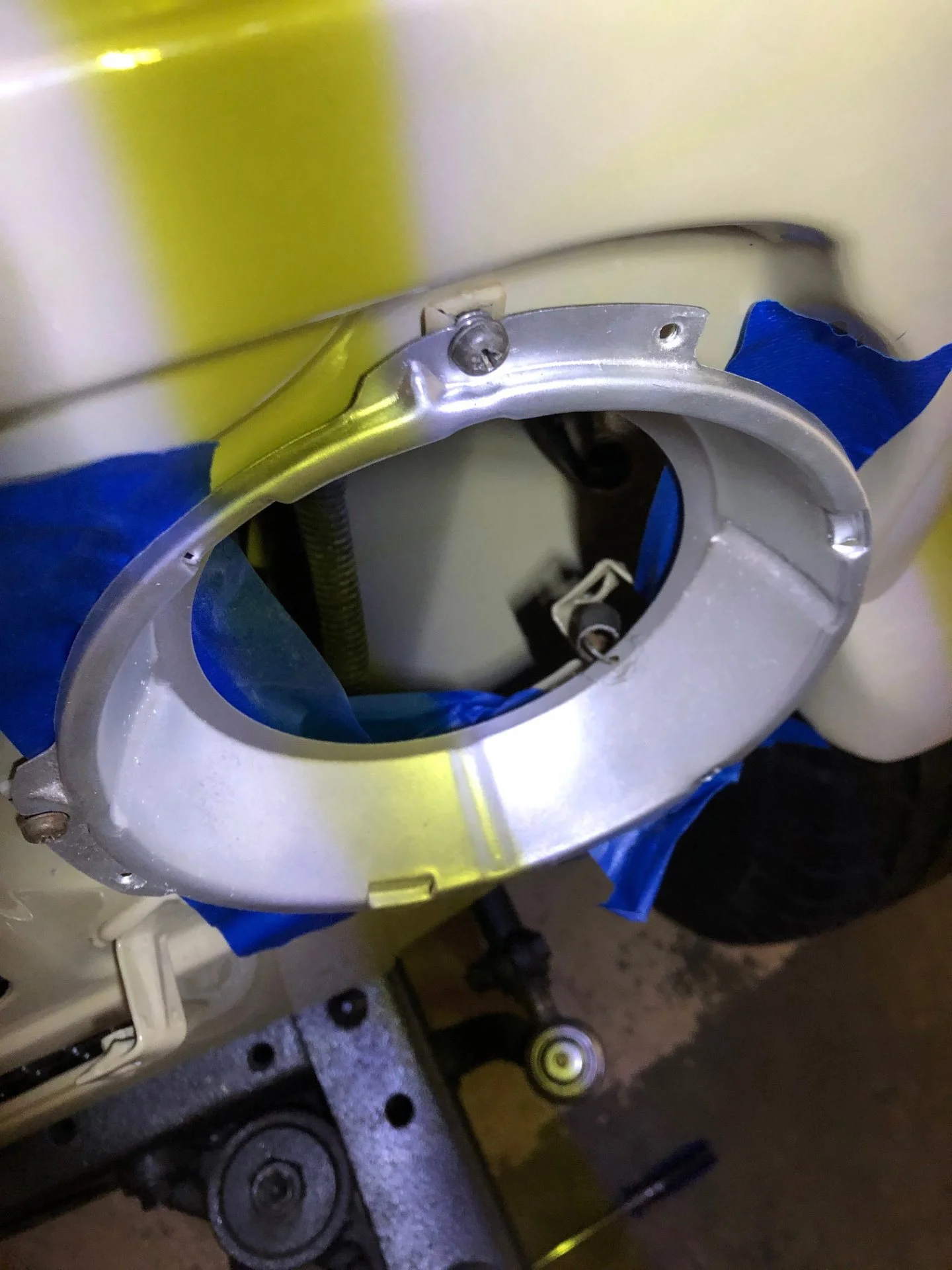

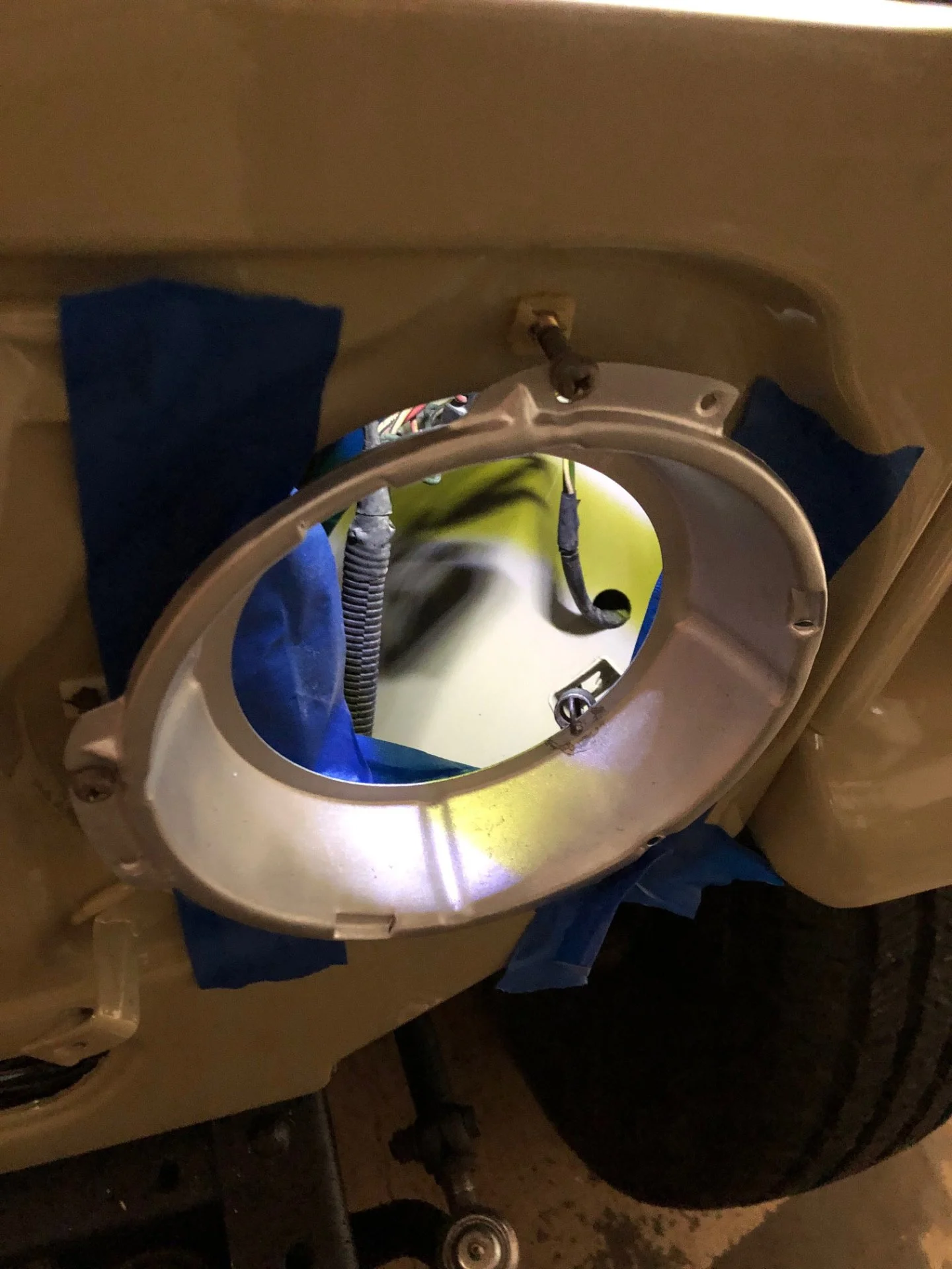

I must be missing something SUPER easy here....but took my headlamp units out to paint the buckets with rustolium and when trying to put back into place, the springs are no longer creating any tension....leaving the bucket loose. This is for a 81-83 FJ that was the single spring as shown. These were applying a good amount of tension when I took them apart, but now even with the adjust screws all the way in, it is still loose. Bucket slots are in the correct channel/groove on the adjuster screws.
Do I have something backwards here? The spring looks uniform, but does it clip in one way or another?
Pictures below of one installed - but bucket has a lot of play.
Very. Stumped.
UPDATE: Nevermind - I had my spring in the wrong hole......Heeeeeyyy-Yooooo, filthy jokes all night folks!

Since there only appears to be only one hole, would elaborate as to which hole it was supposed to be installed in.
As @1MAC says below, 2 holes and one spring. Was further hole. Ok I’m done with holes and springs ;-)
