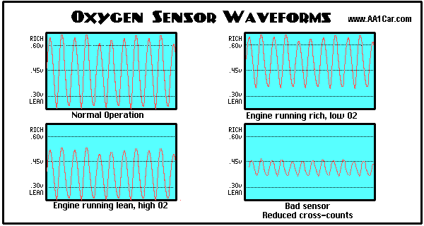

Keep an eye on it, I'd be willing to bet a shinny nickle your problem come back even with the o2's unplugged. It is possible they are the culprit but I'd be surprised. Do yourself a favor and get that oscilloscope I posted previously and you can actually test the o2 sensors while the engine is running and you can see if they are indeed providing the correct waveform or not. O-scopes are one of the best diagnostic tools you can buy yourself, its worth having.
O2 sensor waveforms look like this
