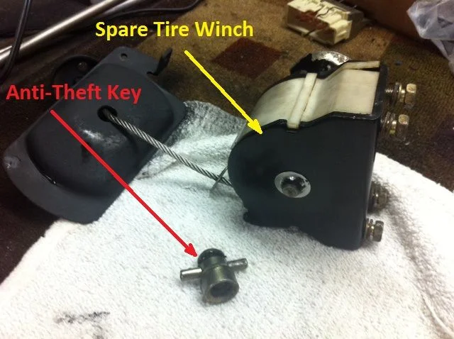

Let the air out of the spare (so you can move slightly). Then get a 12 mm ratcheting wrench, crawl underneath and remove the 4 bolts holding the winch to the cross-member. The tire won't crush you when it comes down, use your legs and knees to deflect it.

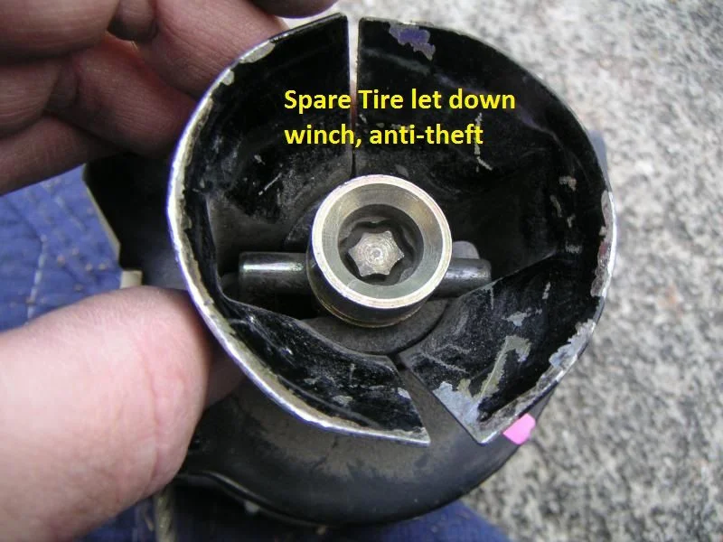

Once you have the winch down, REMOVE that stupid anti-theft key. It is just 'pressed' into the bore of the winch and held in place with an external washer. Once you've done that....you can use your tire 'let down tool' (the hook portion) to operate the spare tire winch from that point forward. IF thieves want your spare tire they will snip the cable (in all of about 5 seconds) and be gone with it anyway.
...remove the 4 bolts holding the winch to the cross-member....
Or, just take down the crossmember to get access, also 4 bolts, that you can get to.

The first pic shows the anti-theft key in place. Once removed (second pic) the hook portion of your Jack/Tire let down tool...will fit in the slots that the 'roll pin' is occupying in photo #1. (as originally intended by Mr. T.)
