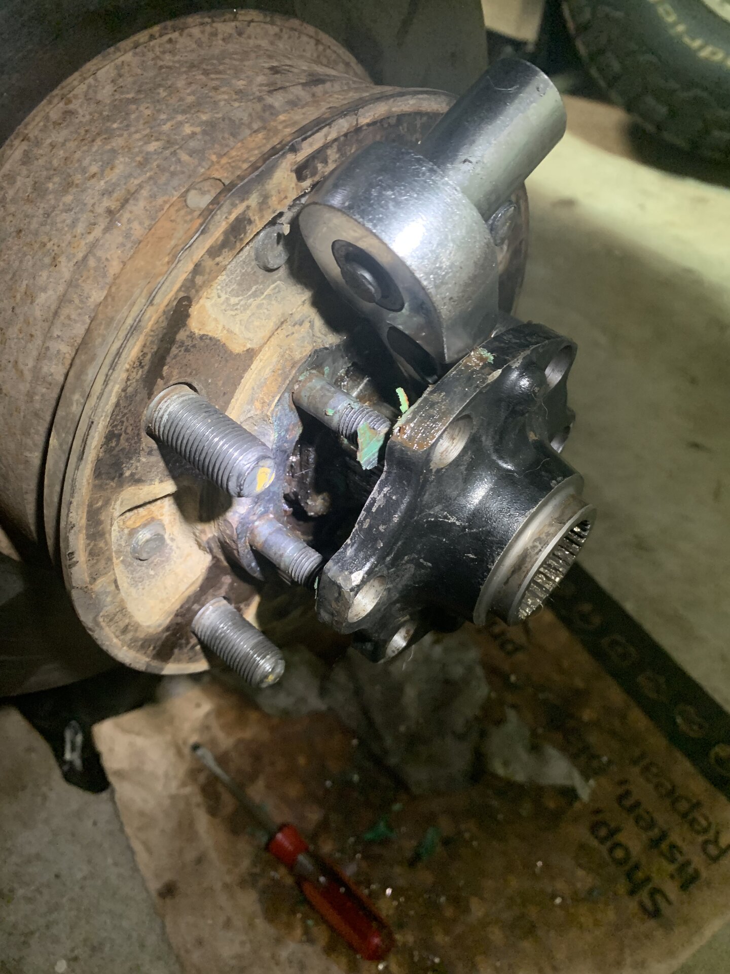

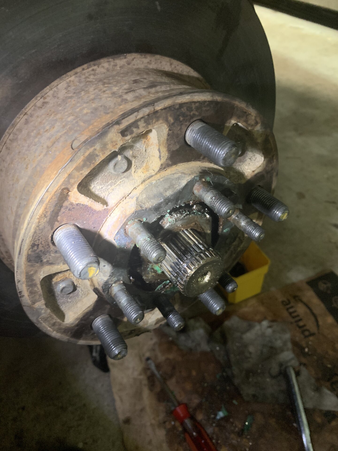

These are aftermarket CVS so maybe that’s the problem. I decided to try the other side and I’ve made more progress but it still ain’t coming off.
Passenger side:

Partial victory! I got the passenger side flange off. Wasn’t brave enough to swing the 8 lb sledge so just kept going with the the 2 lb hammer. At one point it didn’t seem like the axle would move any further inward so I put a spacer between flange and hub (see ratchet). That did the trick. Still have to get the driver’s flange off but not sure my drift-holding hand can take any more blows from the hammer. If this nightmare is due to aftermarket CVs and incorrect tolerance on the splines, I would pay whatever Toyota wants for a CV to avoid this. Thanks for the help everyone.

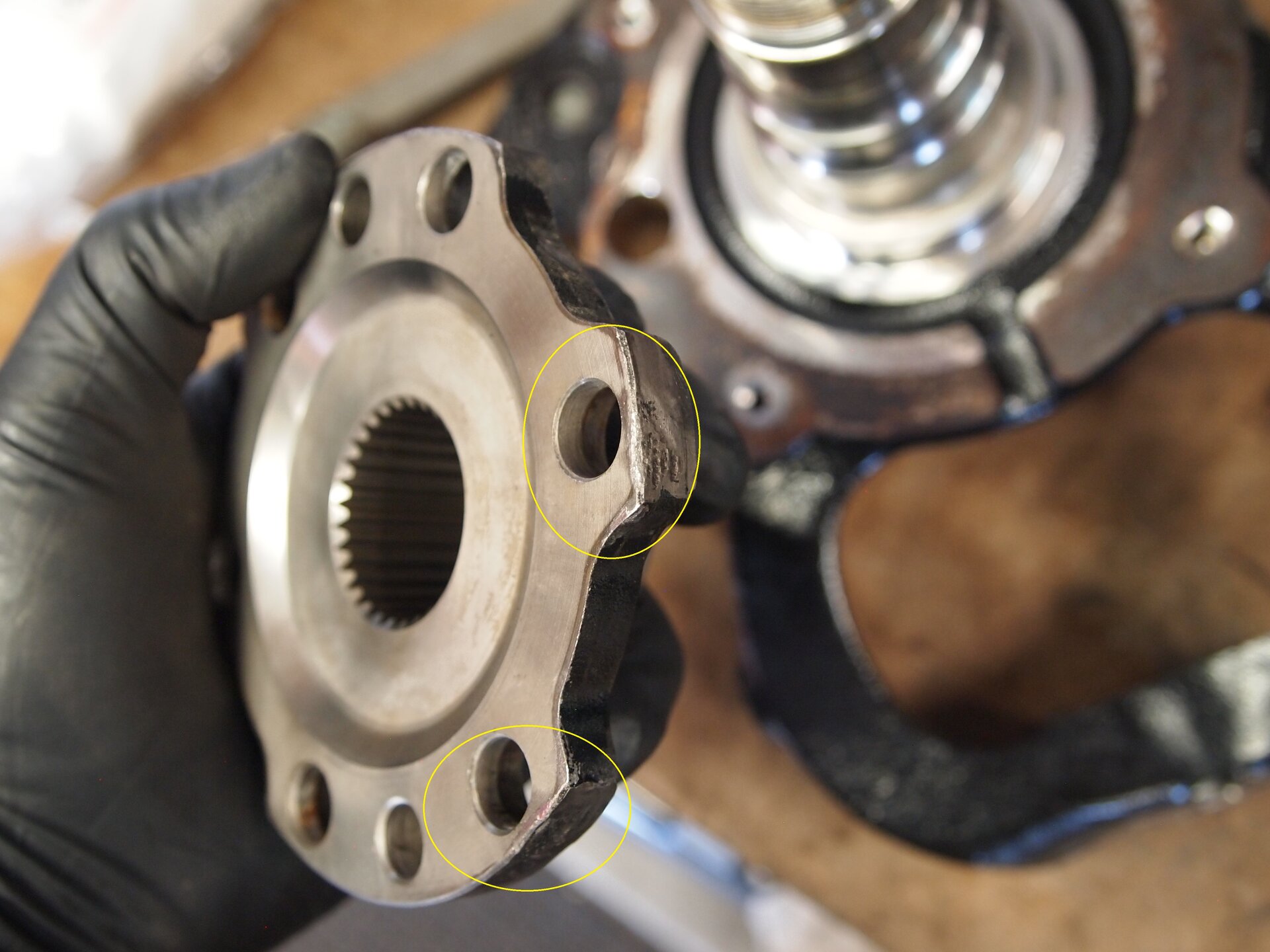

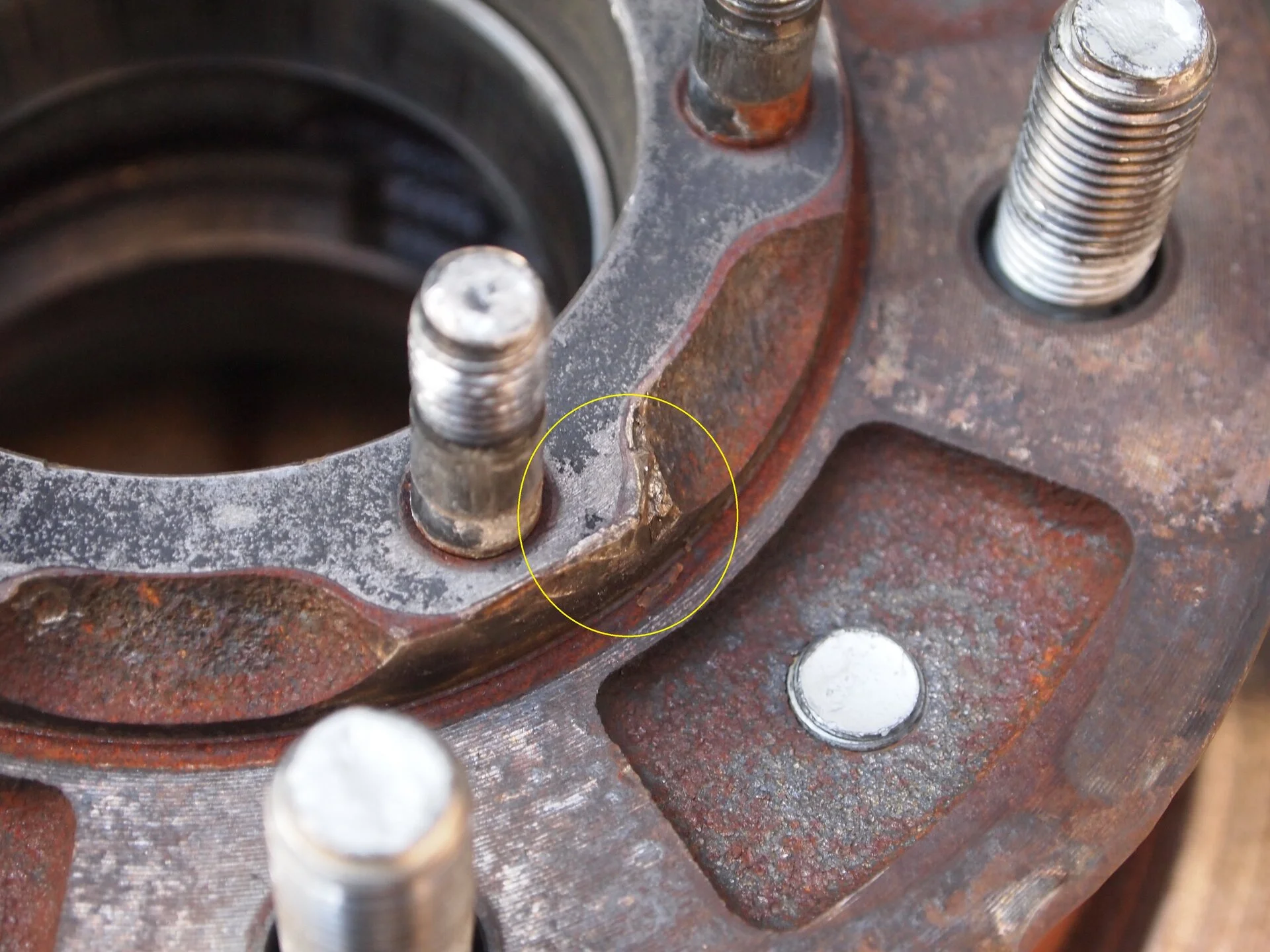

Risky using a steel spacer between hub flange and wheel hub. Brass and spaced unevenly on each, reduces rish of damage.
Alternative to brass drift and hammer:

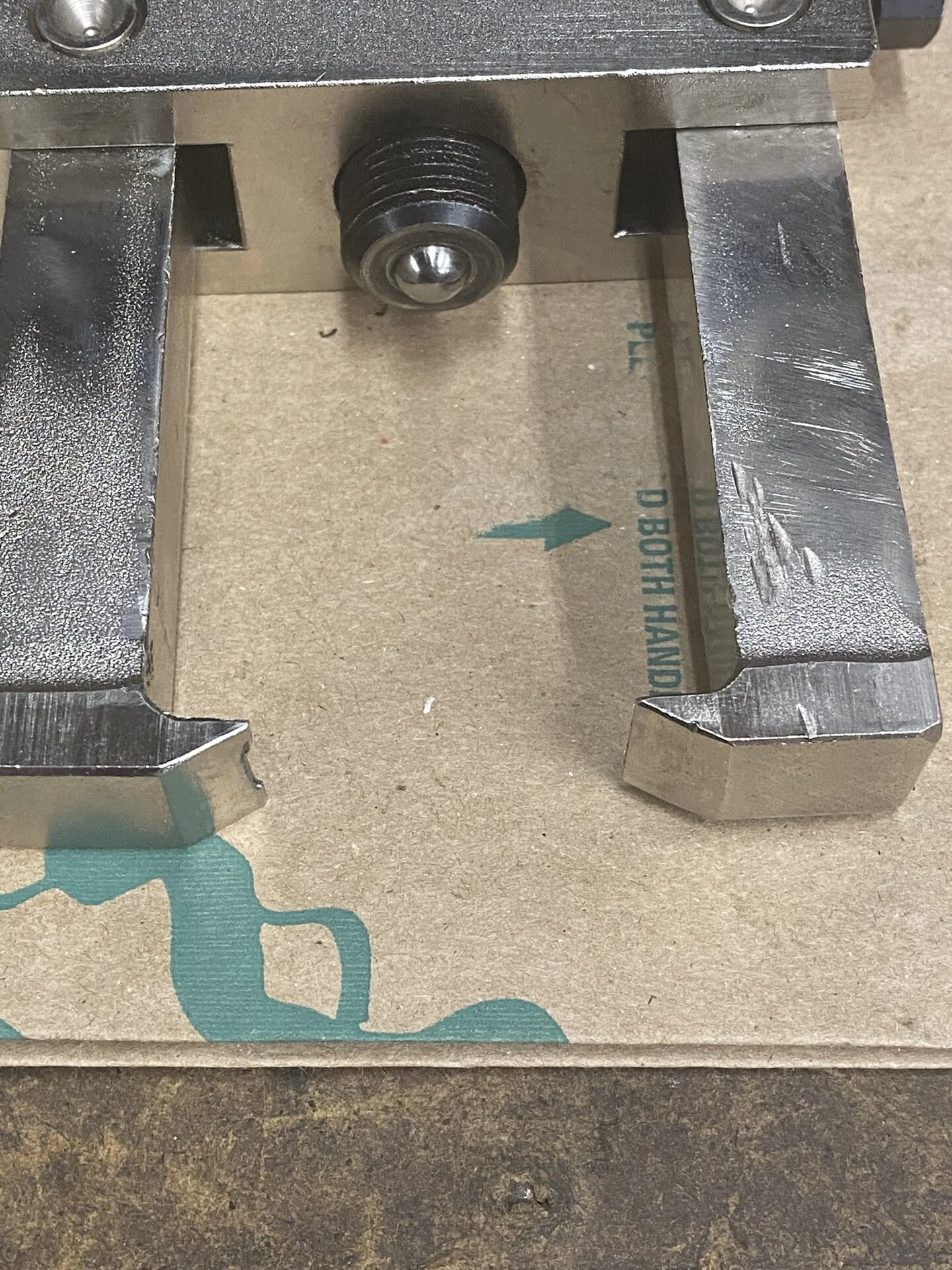

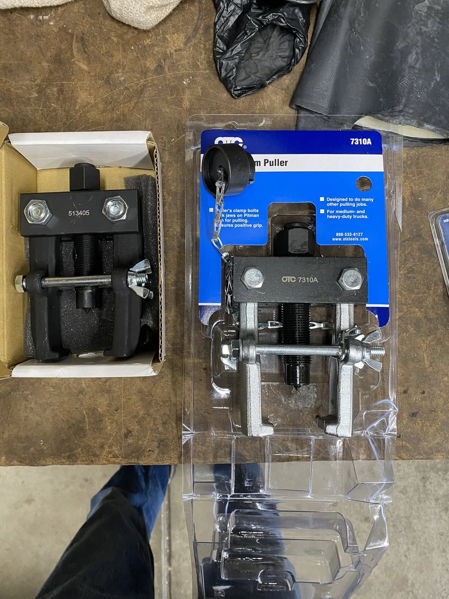

You can also use a 2 or 3 leg puller, w/adjustable legs. Local parts stores loan them out. Attach the legs to back of wheel hub when use very large puller. Back of hub flange, when using smaller puller (note may damage hub flange). Then drive end (screw) into center of axle.
We need to avoid warping or distorting mating surface of wheel hub or hub flange. Otherwise we risk water leakage into bearings. This is why we should never pound on hub flange, especial with hard metals.

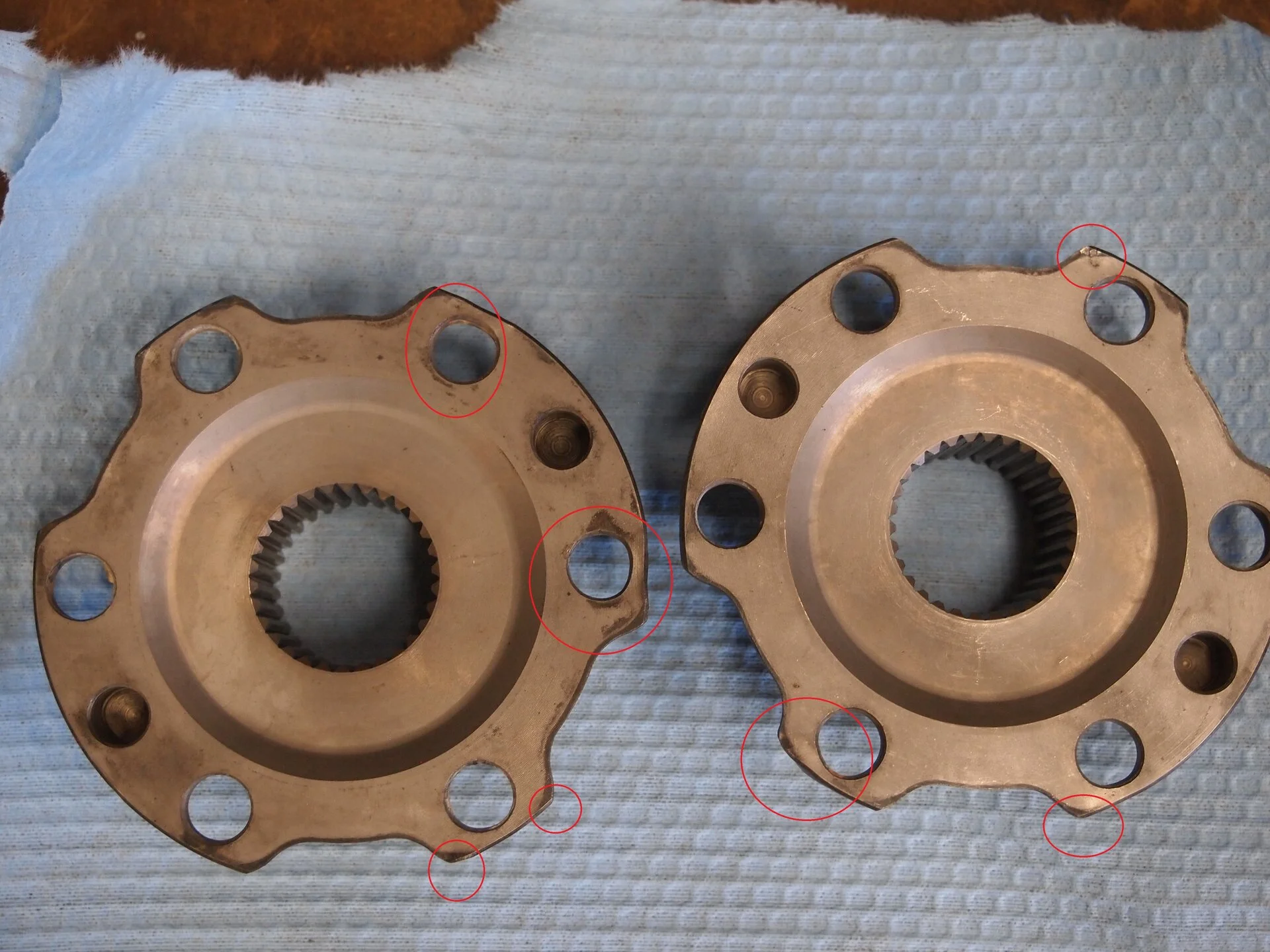

Thanks for suggestions. I’ll try the puller method this afternoon. The previously recommended LC shop is who installed the aftermarket CVs. Not sure why they would have installed a part that required a flange to be hammered on. My fault for not specifying OEM I guess. Send me a PM with a price for those CVs and flanges if you’re willing to sell. I may go that route.

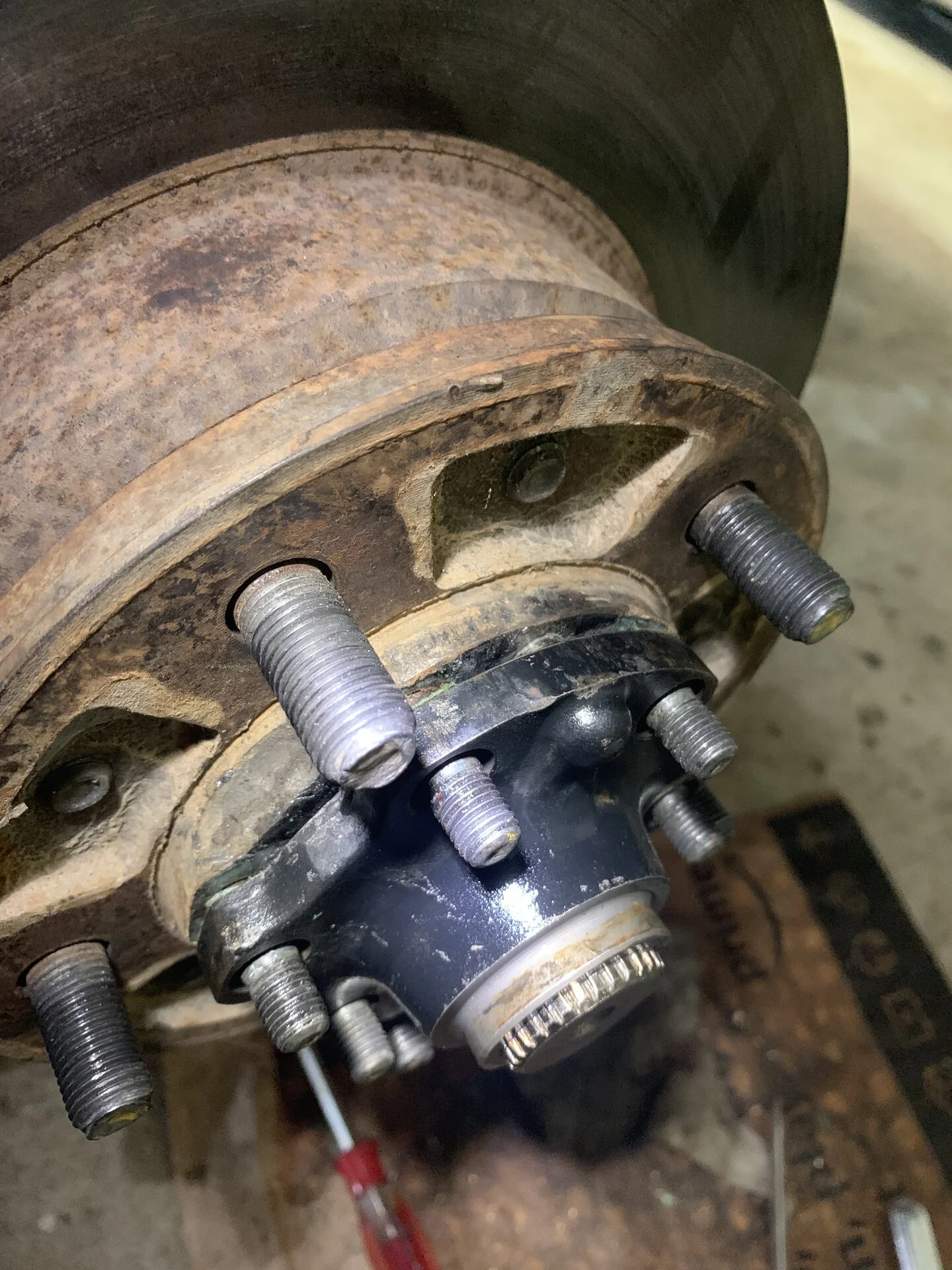

Just to close this out: finally got the other flange off. I will be replacing axles and flanges since I couldn’t get the flanges back on after completing wheel bearing and brake service. Since I knew I was replacing the flanges I tried heating them in the oven to see if it would help with install. At 400 degrees the flanges slid on easily by hand but got stuck once the axle was flush with the flange. Wheel puller wouldn’t pull axle through flange either. Thanks again for help.
