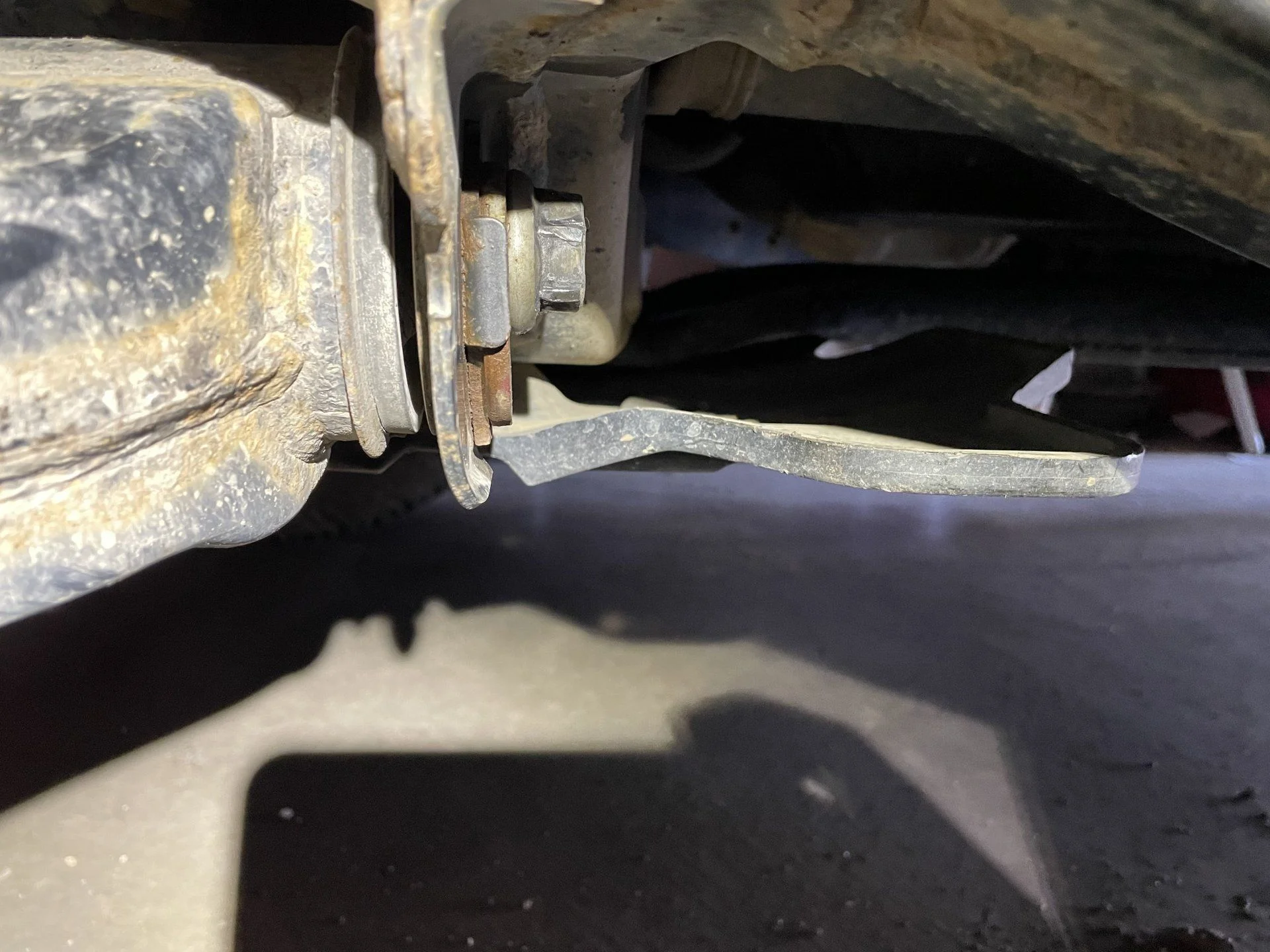

I'm sure everyone is given a pass every now and then for immediate help. If so, I'm asking for one now. I'm replacing the left lower control arm today, or at least I thought I was. The bolt on the lca bracket to the frame is not moving. The nut is off. I don't have a reciprocating saw and trying to avoid another errand for this project. Unless I missed something in the Repair Manual, I can't find a procedure to free it. All the Youtube videos show people using a reciprocating saw.
Can I use my 3lb hammer and bash the end of the bolt to free it? Or is this just a waste of time and should I humble myself and go to Home Depot for a saw.

It’s on the left front lower control arm, the rear bolt. It’s the rear bolt that attaches the lca to the chassis.
My new Dewalt 20v XR Brushless battery impact easily took off the nut. But the bolt isn’t moving - like the horrible roommate who won’t move out.

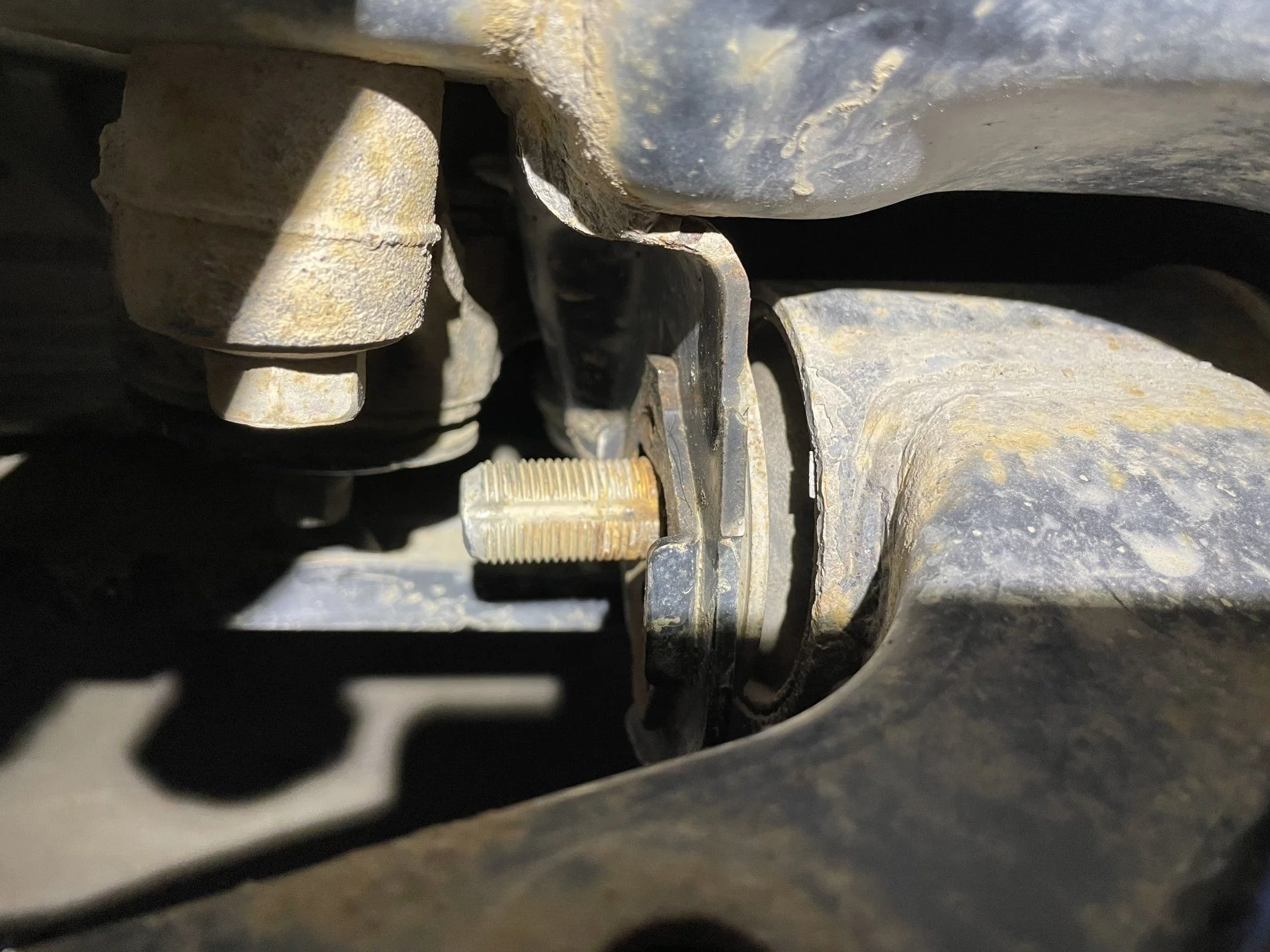

That's a good idea. I should've thought of that but I'm tired and my family is sick which is impacting my attention. The bolt needs to be replaced. I slightly rounded off one of the bolt corners sitting on a 4' breaker bar. I weight 186 (on a good day). I used the 3lb hammer and the bolt is stubborn. I don't have a long round solid bar that would fit against the bolt. Indeed that would be ideal.
I gave the threaded end of the bolt many solid hits with the 3 pounder. Nada. Nothing. Zero. Sigh.

Sooo... what exactly are we sawz-alling?
I’d be in the much bigger hammer camp first. Or even grind the head off the other side so you can get a proper swing at a punch and drive it out.
