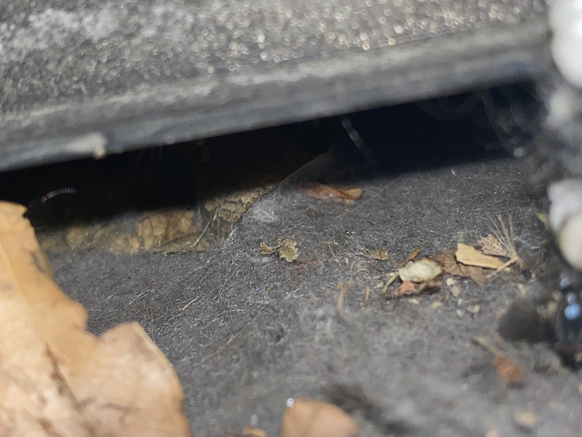

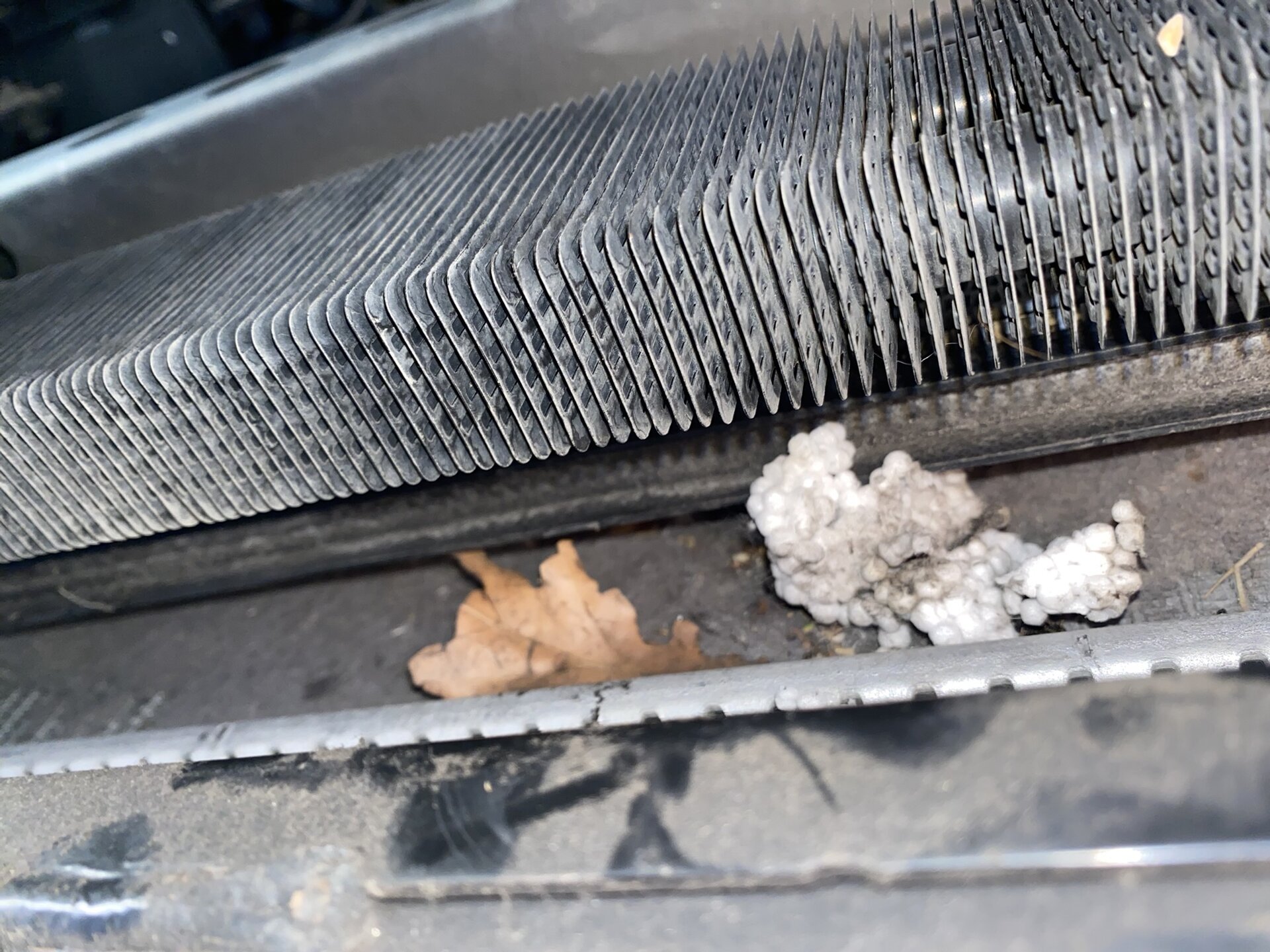

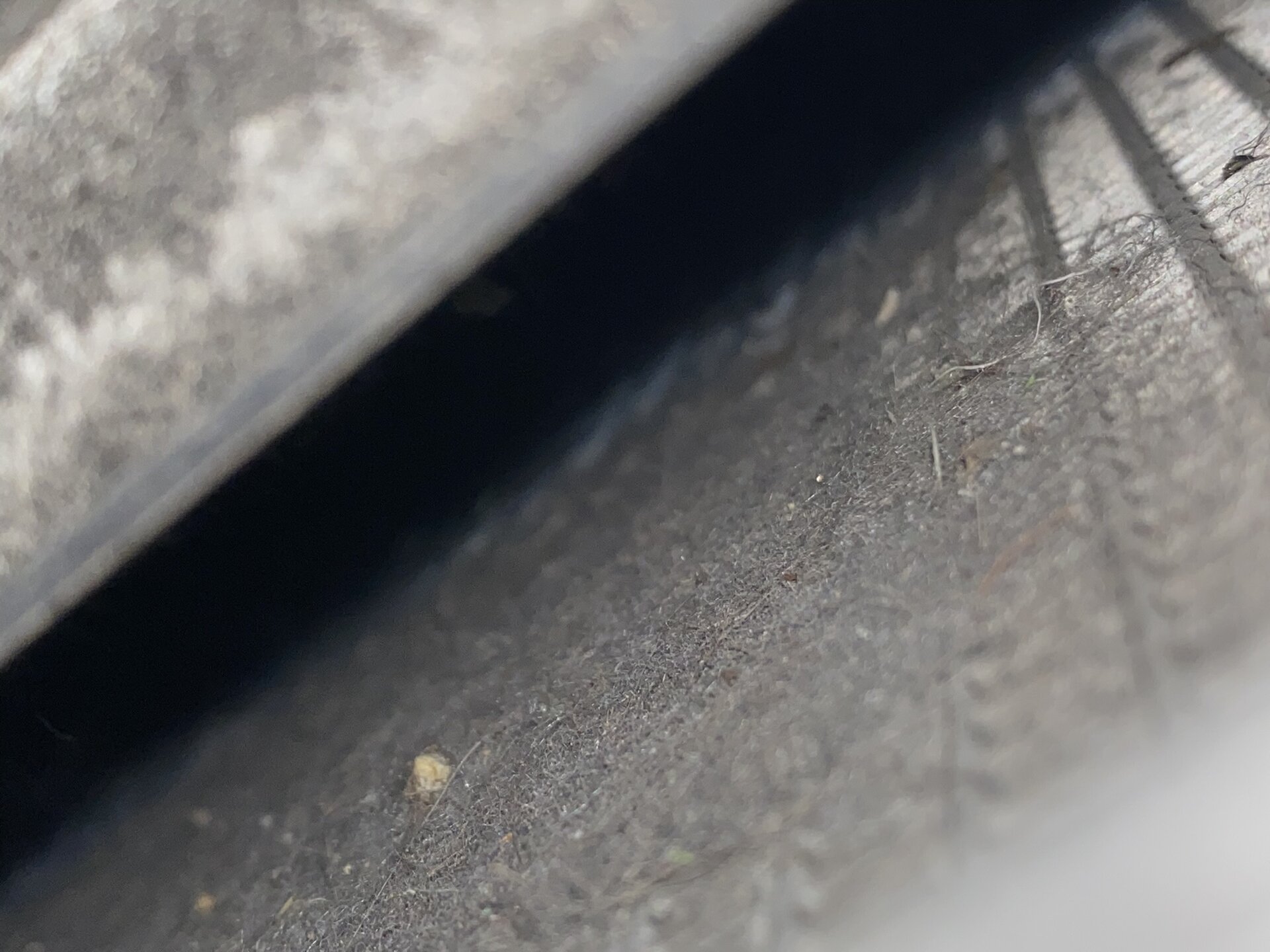

Water temp gauge is near useless. I watch through tech stream. Using a BlueDriver or OBDIImx. They're easy way watch ECT, FT and much more.
I just clean the fins on a radiator, the was installed 2 year ago, in a 200 series. It just driven in the city, by a soccer mom..
Yeah idiot lites really. Good idea to get something useful. I also washed radiator fins. Used a specialty spray. Light spray from hose.
