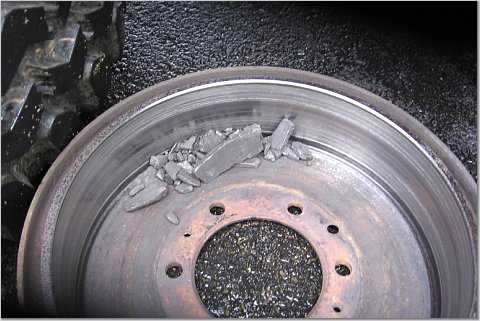

Yeah in my fsm it gives 65 and 90 as the two torque specs for the caliper bolts I erred on the high side because that's what I got off the 3FE list. It's not really that much more preload, just about 1/8th of a turn. I just replaced the rear brake today that's why the pedal was going to the floor I'll post some pics. There was no lining on either of the shoes. I think when it failed it caused pressure to push up into the master cylindar and that's why I felt I was having so many issues on the way back up from Devil's ditch. I literally had NO brakes.

Ross, Looks like you may need to have those drums turned!
I hope not, I've never bothered before. I found the reciept for the shoes and they have a 1 year warrenty from Advance Auto Parts. Looks like I'm taking them back tomorrow. At least then I'll have a spare set.
While you have the drums off, it's good insurance to have them turned. It's pretty cheap and a quick easy job. I can see the grooving, and what *appears* to be a lip on the outer ring. Without turning, the new shoes will soon be scored.
