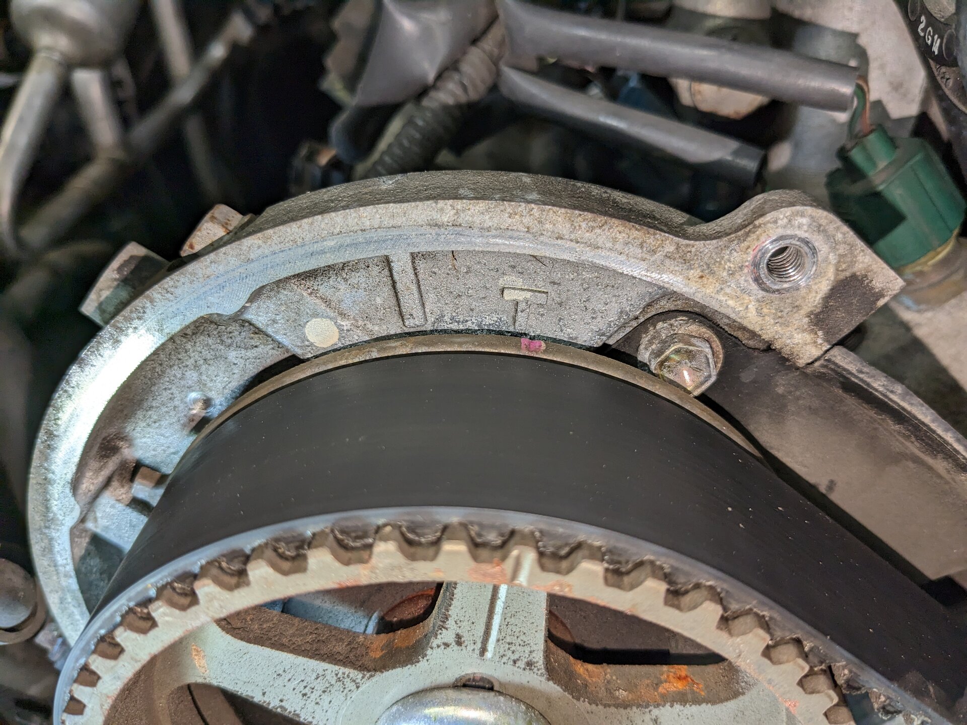

So I pulled them covers again. If the timing is off, it sure isn't visible to the naked eye. The crank mark is hard to see with the fan pulley in the way but I got the phone pretty much over the top of it. Right cam might be a hair past the T but it's not a full tooth off.

Your timing looks good. In this picture, your crank timing mark should be lined up with a raised dot which in turn lines your cam marks up with the T’s. If you set your crank at 0 then your cam mark should be lined up with the raised straight lines just to the left of the T’s.
The T location is a secondary location where you can line up the crank with the raised dot and you can remove the timing belt without it jumping.
