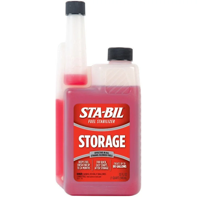

STABIL . Chainsaws, log splitter, lawn mower, weed eater power washer and motor home. Excellent results.

Well, if I have to choose between paying $30 a gallon for ethanol-free premixed gas and taking literally 2 mins to empty the tank of a tool and run it dry in preparation for long term storage, I'll do the latter. If that would not be possible, I'd use fuel stabilizer, that should be much cheaper still. But to each his own.

I usually use premium fuel in my power tools and don't really care if it has ethanol or not. If it's going to set for months then I will add some Sea Foam. I prefer Sea Foam to Stabil as Stabil just floats on top to prevent oxygen from contacting the mixture. Sea Foam mixes with the fuel and helps keep everything in solution. If it's going to set for years then I run the equipment dry. If cars are going to sit for years then I fill with premium and add Sea Foam. A lot of my stuff sits for years or has sat for years. Never had an issue with cars or power tools (2 stroke or 4 stroke) by following one of these two paths. FWIW, I've had cars sit in storage for more than 2 years with a full tank of premium and a can of Sea Foam without issue.
