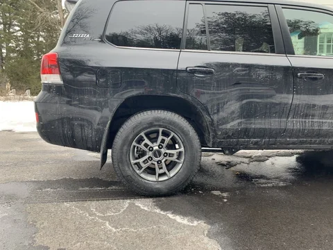

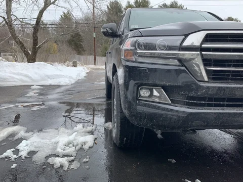

Can you post pics of your truck looks with this size Defender on?

Yes. Happy to take some pictures. IMO these looks perfect. Happy to sell them to you too. They have 20 miles on them!
Hang tight.
The tires have 20 miles on them, and you've run them at one pressure, and your judgment is that they are too harsh from this short sample?
I’ve been told I can’t go much lower psi. How many miles would you like me to drive unhappy?
To be clear - this is not teeth falling out of your mouth. This is just feeling every bump - I’d describe it more as a “sporty” feel vs plush and comfortable.
I don’t see how driving this more will change anything. I’ll play around with varying set ups and try to find a comfortable solution. Still have my Dunlop’s on the heritage wheel (bronze). Will be selling those too as I have an extra pair.
Also have the HE rear springs if that’s appealing to anyone. Less than 10 miles on those.
Hang tight.

If it was me, I'd explore some lower tire pressures and get some seat time before making a call, but it's your truck, and you can obviously do whatever you like.
I also don't think you are going to get a plush ride out of a land cruiser without compromising its utility. But that's just my personal opinion. The stock suspension and tires are about as plush as it is going to get.
Also, in your reply you added that you have stock springs available. Does that suggest that you put aftermarket springs on? That seems like a much more likely culprit for reduction in ride quality.
