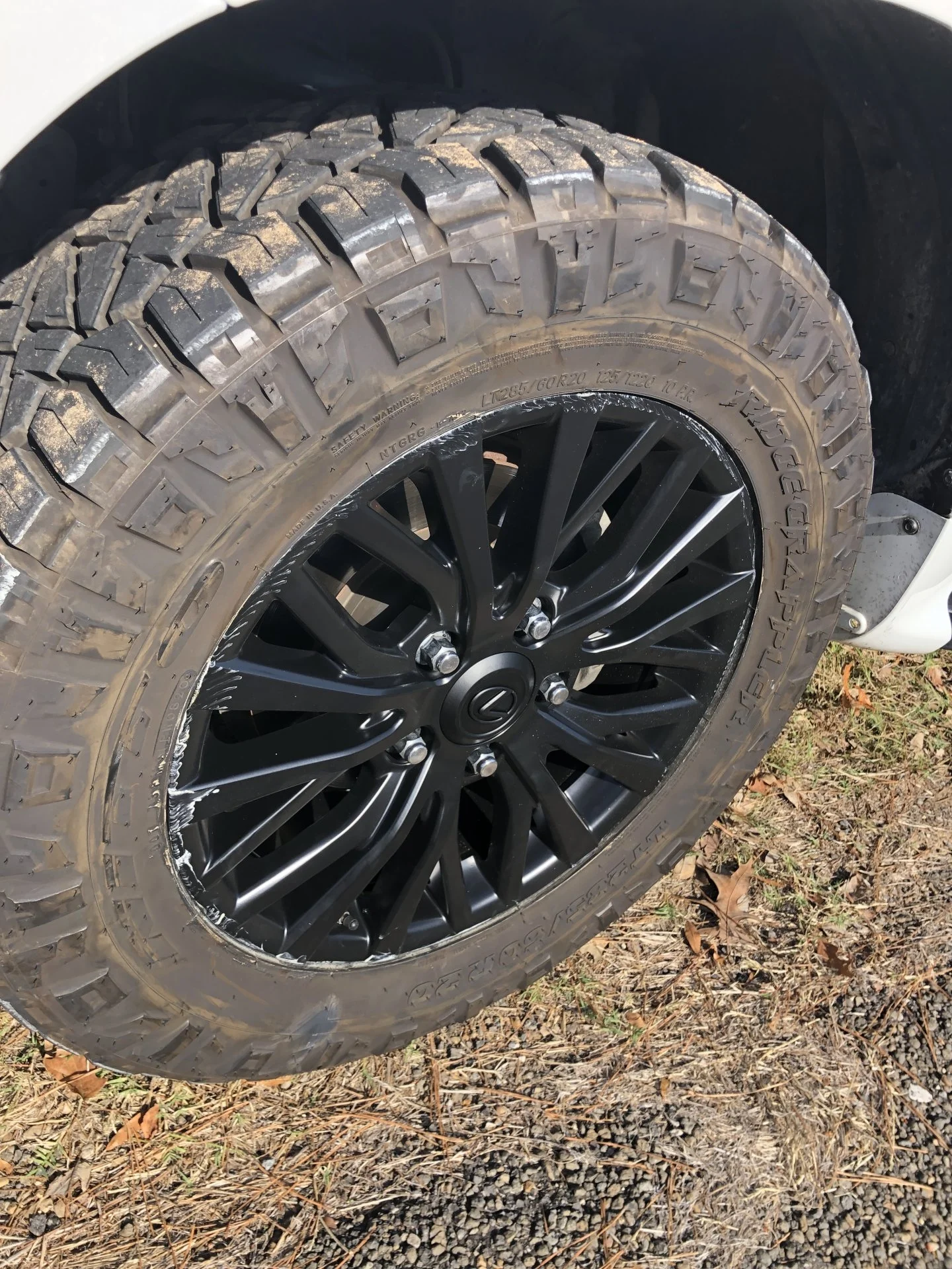

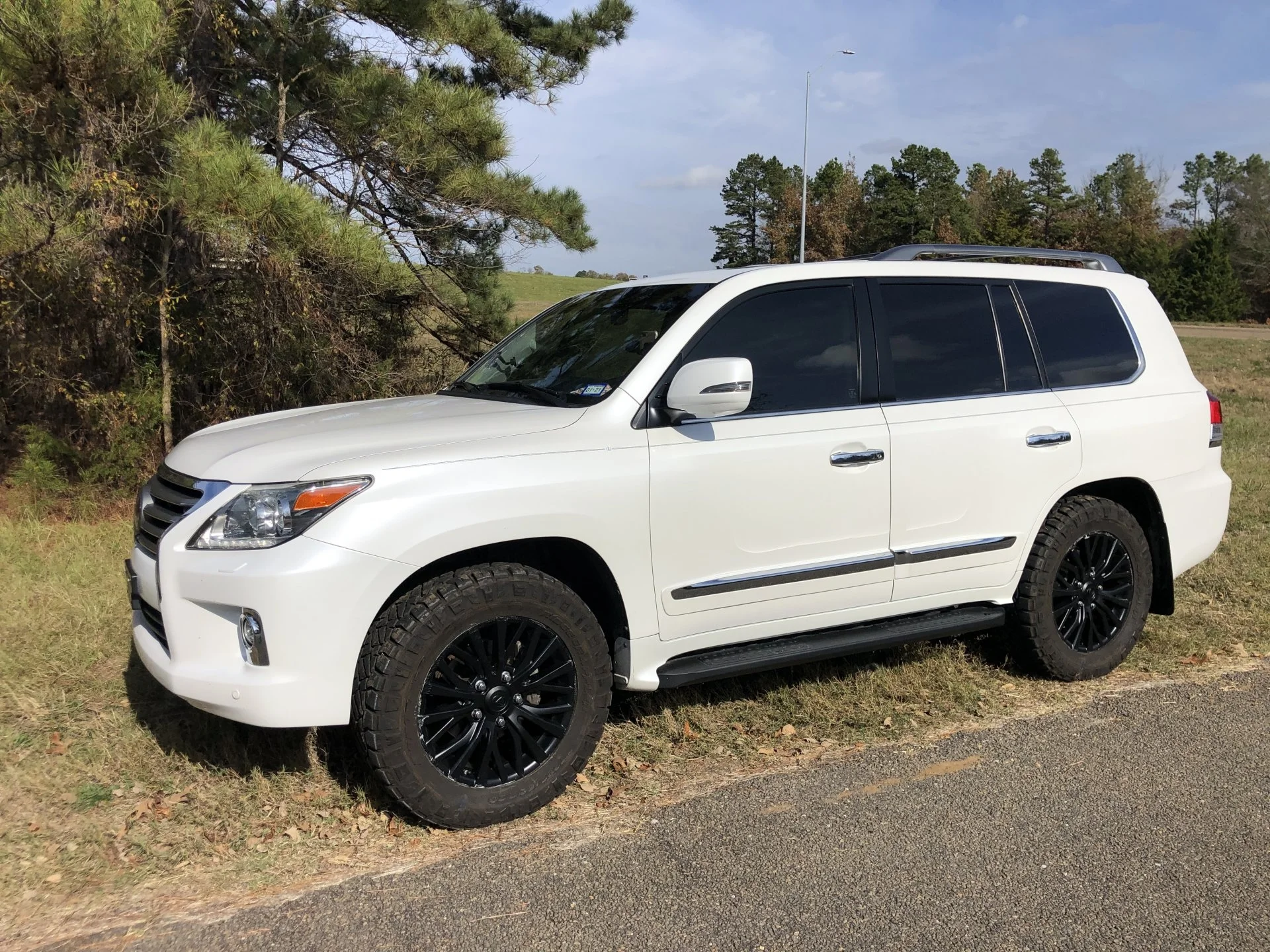

I did put a bigger tire 285/60/20. If I could go back I would run 275/60/20 just due to UCA rubbing at full lock when turning.

I did put a bigger tire 285/60/20. If I could go back I would run 275/60/20 just due to UCA rubbing at full lock when turning.View attachment 2656815View attachment 2656814
Hadn't seen that combo before, style and color. That's a pretty strong look! I like! I use to think 20" wheels were too big for off-roading, but when combined with big ol tires, and the big bootied 200-series, it's a modern bold balance that works.
I assume you're without spacers? Couple things you could do if you're interested in resolving the rub. .75" or 1" spacer (may actually improve drivability with correct geometry and wider track for the tall 33.5" tires). Or cut a small relief in the stock UCAs (info here)
