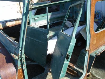

So all the doors on the 40 have a good bit of rot on the bottom. Is it worth welding in new bottom panels or shoud I toss some cash at a good set? Will prob be tailgate and tube doors this summer but I'll need to do something eventually.

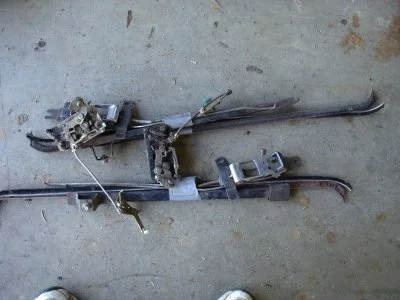

i have two doors off a fj40-76. They are in very good condition. not a plug and play, they are disassembled. if you want em, i can ship UPS. $100 each, and UPS is about $40 to midwest per door. maybe another $40 for the glass and hardware. PM me if you have interest.
the Driver doors arent completely rusted through on the outer skin but the inside bottoms are pretty tore up. The ambulance doors are about 2" short on the bottom due to rust. I think CCOT sells weld in panels. I might check that out. +1 on keeping original parts alive longer! Thanks for the offer on the doors off your cruiser, but I think shipping to AK would be pretty killer.

Post some pics of the doors so we can get a better idea of what shape they are truly in. I always vote for fixing things if you have the time and skills. It keeps another set of doors alive..

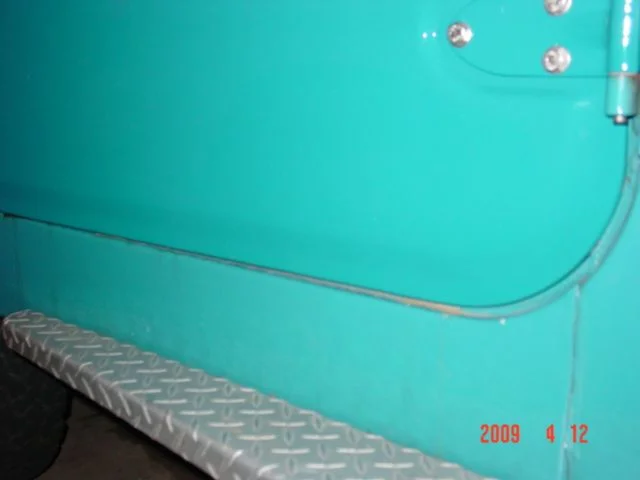

About a year ago went through the same thoughts and got the CCOT door panels. The skills needed for this job were far beyond mine, and it was expensive to have this done. They look great but you could likely find some good used doors for alot less money.
The guy that did these did a good job and I really can't tell they
have the been repaired.
