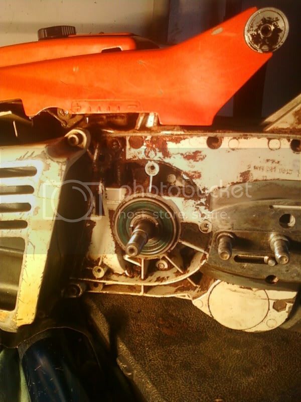

got the tool and got the clutch off and the plate under it.I take it the oil seal needs to come off next?
