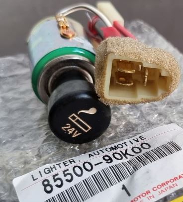

@ToyotaMatt I don't think that particular one will work for the 70 series. Not because of voltage or anything electrical. Just fitment and they have a lighted ring around the housing.
Like this for the 24V variation.

Not all 70 series are 24V
i was not aware all 70 series were 24V ?
Correct. I was just showing a photo of the 24V version. IIRC, the 12V is just like the 24V pictured example except "24V" is missing. No other difference in appearance. Never seen blue ring though.
