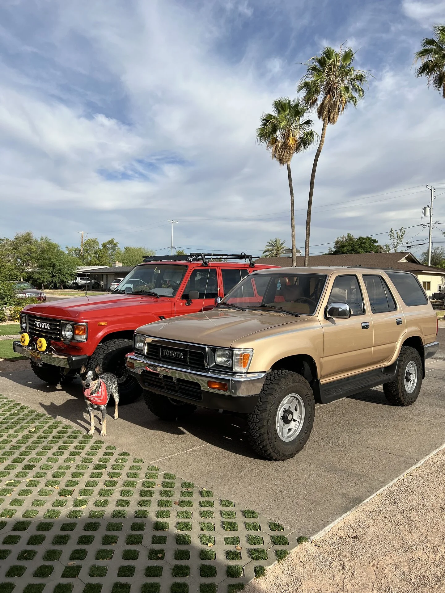

Hi all, noobie post here. I got my first Toyota 6 months ago, a 1990 2nd gen 4runner 4x4 3.0L (I got sucked in when my brother in law got the red FJ a few years ago). The steering components have free-play and I'm going to replace it. I searched the forum for some kit recommendations but couldn't find any. Any kit recommendations you have? Brands, sites, etc... to go to or avoid. OEM or light off roading ride is fine. It is mostly stock and going to keep it that way. I like this kit and that it includes the idler arm, but not sure of site or brand quality.
My 4 runner needs to:
- be my daily driver
- light off roading on forest roads to camp spots
- no wheeling
- no rock climbing
Only after market parts on it are:
- after market torsion bars that raise it to ride flat
- OME shocks and stabilizer
- 31" MT tires

First Welcome to Mud :flipoff2::flipoff2::flipoff2:(official salute of MUD). That is a beautiful 4Runner you got and that red 60 is stunning (don't call them FJ) you can call it 60 FJ60 or just Landcruiser FJ is for the FJ cruiser. Please save your money and get good quality parts there is a reason why they cost that low I don't think you want to re do all that after a few years I just recently did my entire steering components on my 93 pick up I got MOOG parts from Rockauto they also have a rep here on MUD that gives you 5% off on your purchases. Keep posting and ask if you can't find it on the FAQ.
