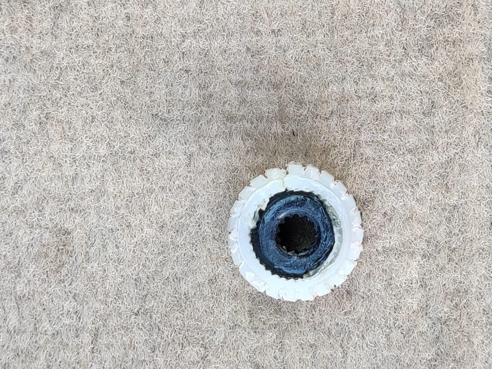

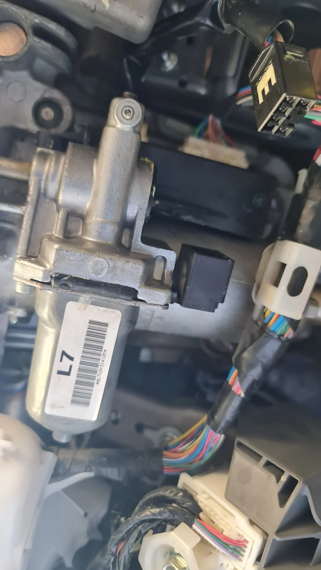

Hello! I've got a lc200 2013 and my steering column is unable to move in and out. It makes this really loud noise on start and then stops after a while. So i went to the mechanic and he found the gear for the telescopic motor broken.
I saw some threads but it was a different issue, theirs were either the motor burnt or something else. Any idea where i can replace this little gear? Any help is much appreciated as I've been trying to find in scrap yards, ebay and so far nothing! It's driving me nuts.

Haha thats the biggest problem. Because there are so many land cruiser out there having this problem, everyone seems to be finding for the same part! You go back to toyota and they tell you to replace the whole steering column which i find really ridiculous. My mechanic managed to pull out the connection for that motor as it was making a really loud and whiny noise. So for those guys who wishes to have it disconnected, I'll try get a photo of the wire connection and see if it can be done at home. In the mean time im still waiting for different garage to find this part. I managed to find one from Ebay, but it only suits a American LC while mine is a Japanese LC. Anyone knows if its the same thing?

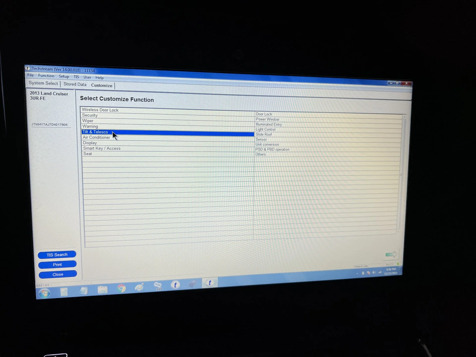

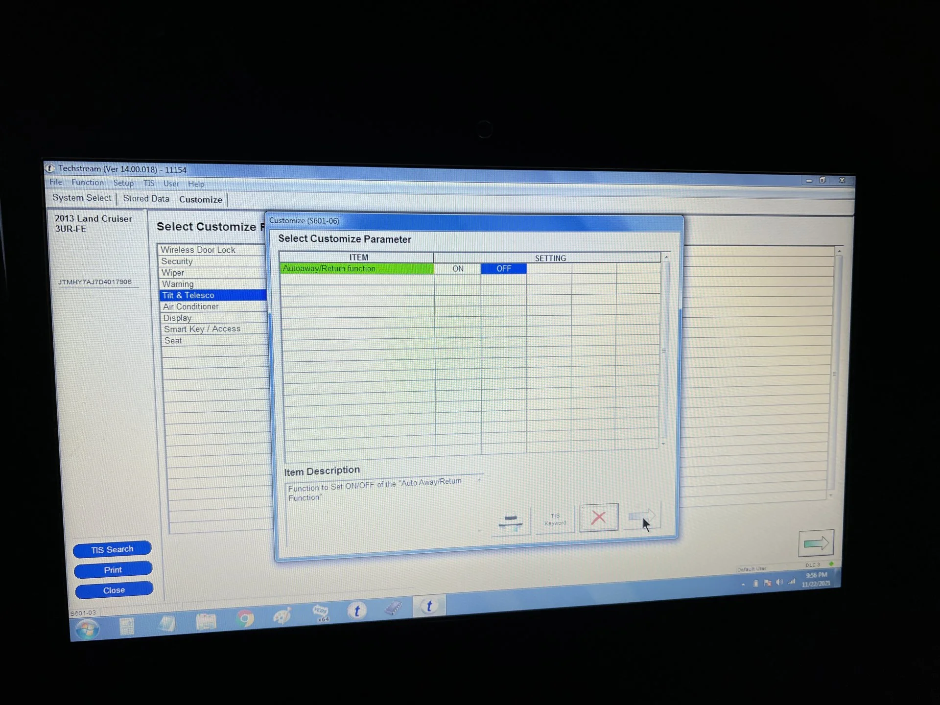

The following is for a 2013 cruiser. Not sure whether other years are the same, but my gut is they are similar.
Connect to the vehicle with techstream. Enter “customize setting” button/feature.
Click on “tilt & telesco”, right arrow (at the bottom right)
“Autoaway/return function” should be set to Off, then green arrow (bottom right of that window).
