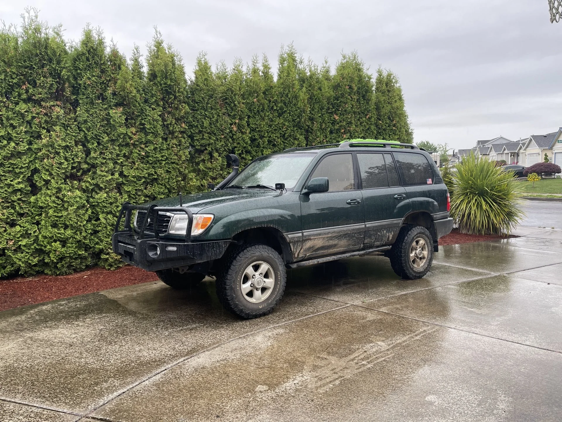

I went with the 2” Ironman 4X4 kit. I cranked the TB’s a tad more and added a 1” rear spacer and it has been working pretty damn phenomenal so far.
