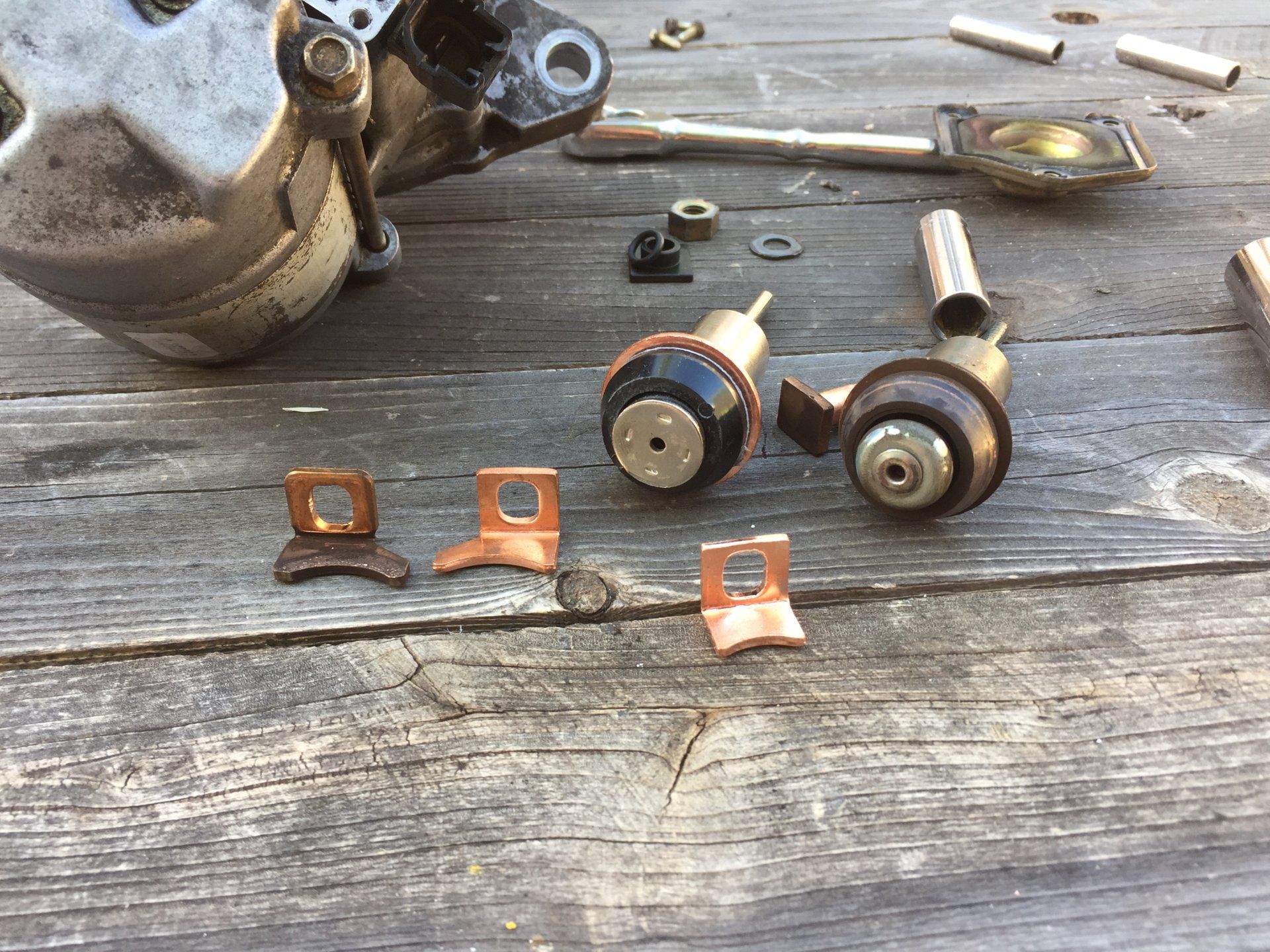

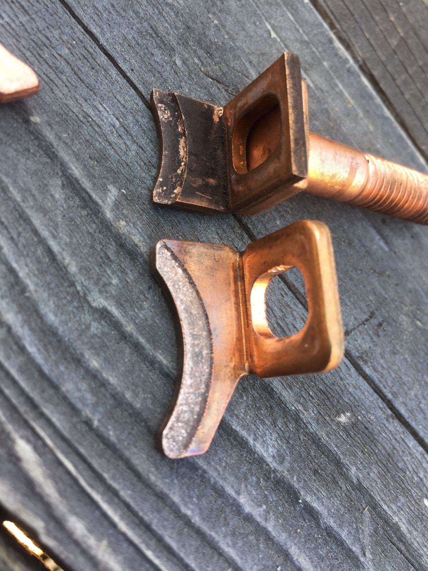

got around to pulling the starter, not so bad except for that top bolt.... anyway I just opened things up and my rebuild kit seems not to match up exactly. The plunger looks a little different on the head part, not worried about that but am worried about those solenoid things. Same size just inverted, will installing on the other side cause problems?
Because I’m in a crunch for time I’m just gonna put the new small solenoid in seeing that it’s worn pretty well, clean everything up and use the (worn but not tooooo worn) larger solenoid. Put in the new plunger and hope for the best. If it works but still clicks I’ll just buy a remanufactured one.
Solenoid things? The plunger doesn't look like it has the length to make contact. The copper, L-shaped pieces in your photo are the contact plates. They look OK.

Regardless it worked lol. Fired up on the first crank
