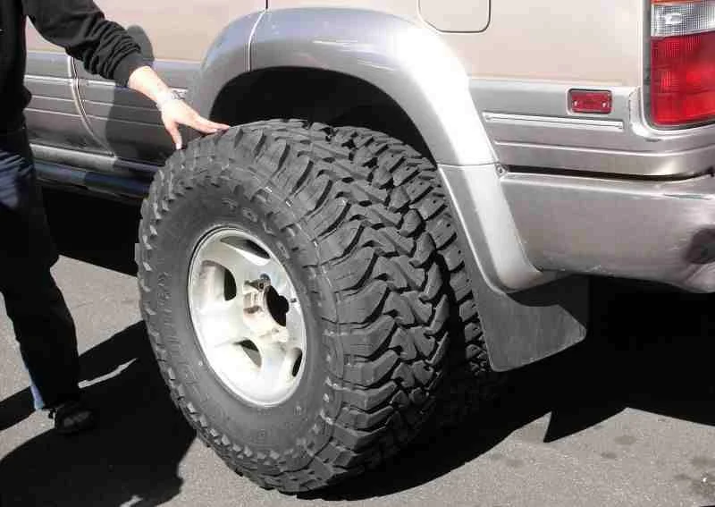

For Sale:
Toyo Open Country MT's. 35" (315/75R16). Used twice. Never off-road. Low, low miles.
attachment.php

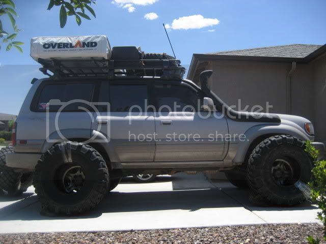

Will 38.7" tires fit on an 80 ? ? ?
Its a 38.7 x 13 x 16.
Striving for this result:
:D :bounce2: :D

For Sale:
attachment.php
-Mike-
