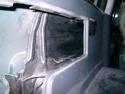

Since I have 2 Labs that I regularly haul around, my rear compartment has to be absent of anything chewable... even the seatbelts are removed.
Since the rear compartment where the factory tool kit was a little small for what tools I wanted to include... I was trying to come up with an area to store a little bit bigger tool kit...
