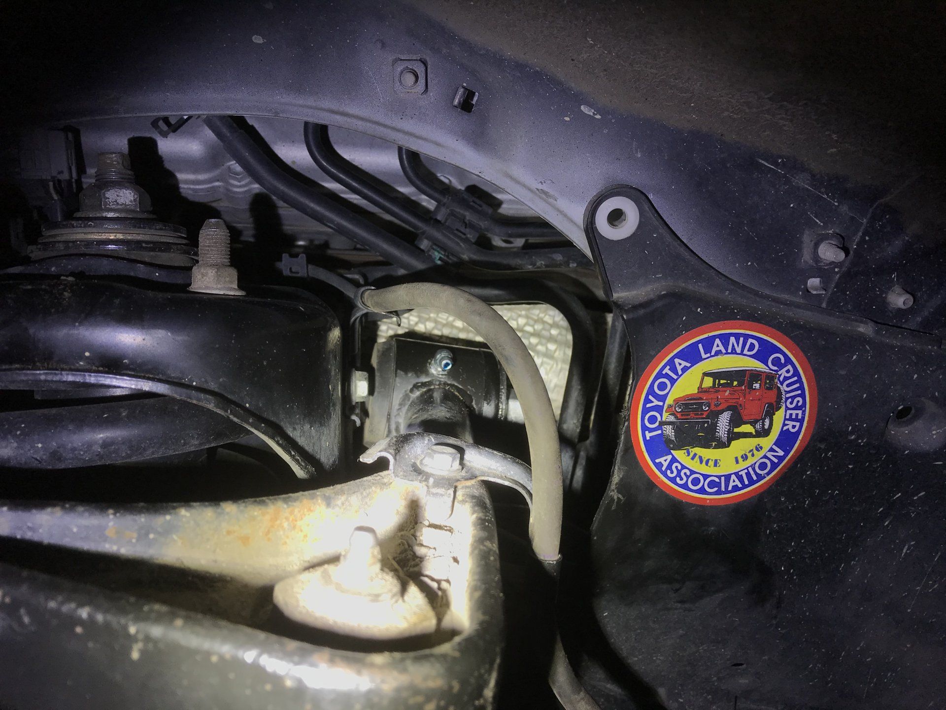

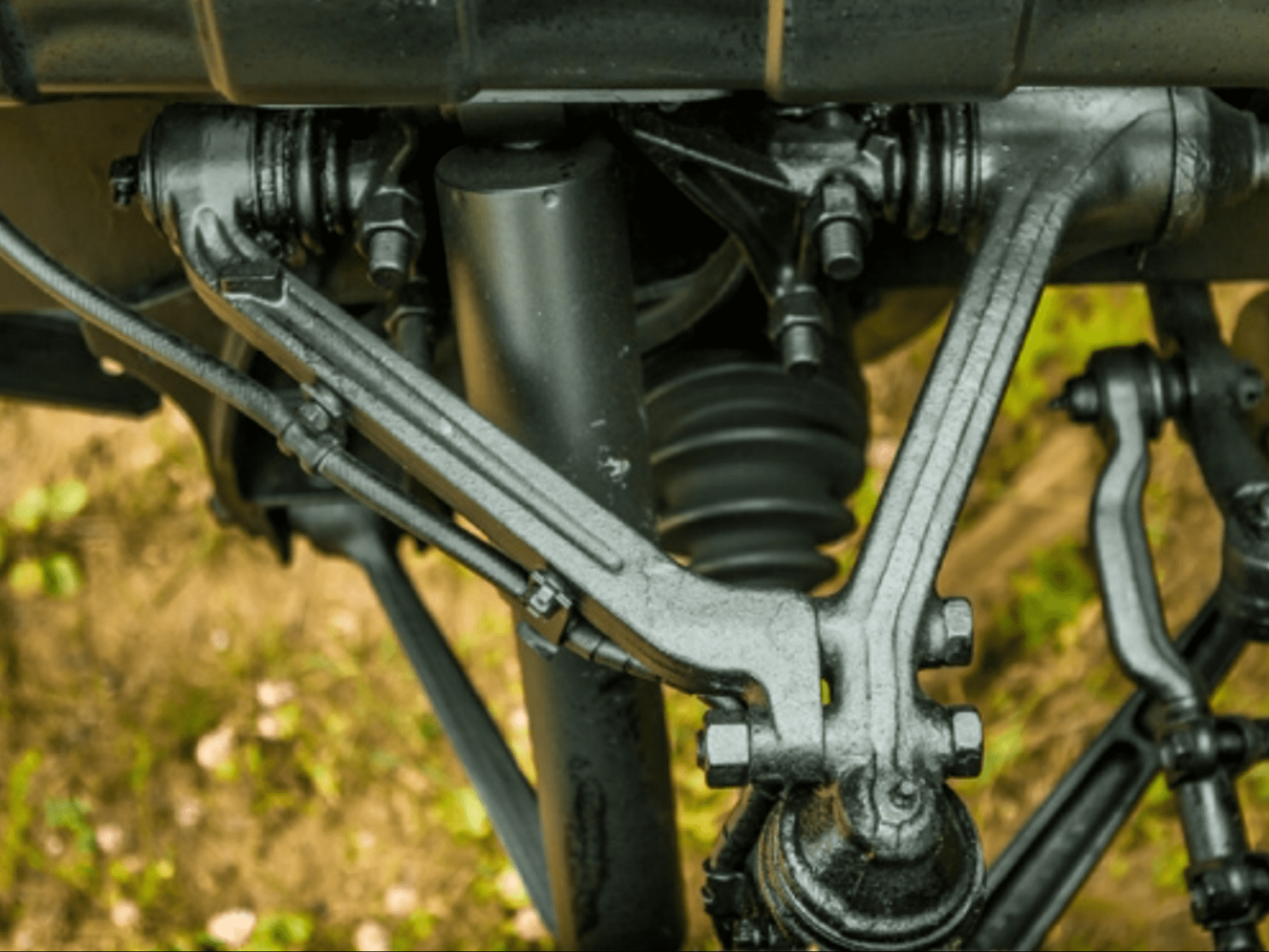

Torsion bar, MegaCruiser. Coaster also.
Torsion bar is out of frame on the right, acting on the short upper? I was looking for one but had it in my head the right side was the front of the vehicle.
