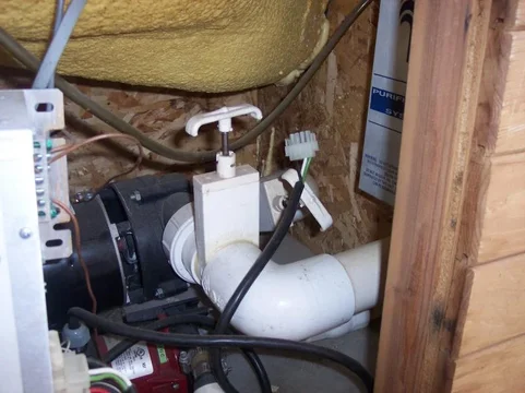

OK, this house we bought has a 6 or 7 person spa/hot tub out back. The problem is that I don't know crap about these critters.
Can anyone tell me a general 'firing up' procedure??
Can anyone ID these valves by the pump and tell me what they're for? Any help would be appreciated!!!

Valves are so you can service the pumps without draining the water. Which for a hotub seems pretty silly. Most of the new ht's I've seen done use the valves anymore. Just fill it and plug it in. Set temp to 99-100 and enjoy. Then check ph weekly and adjust.
Could be the heater. I would assume some people unplug them so someone doesn't plug the hot tub in without there being any water in it and fry the heater. Smart move. Or it could be the ozonator. Which I hate those things. They never last.
Thanks, I understand the red handled ball valve, but what are the other 4 white T handles?? They only go up and down.
What's the connector that is unplugged?
I didn't even notice that until I posted the pictures. I'll take a look tonight.
Those are valves as well. Most likely used to shut the water off to the pump so the pump can be replaced.

Looked tonight. It's actually the Ozone plug. WTF is that? does it need to be plugged in? Turns out the tub has a completely separate breaker just outside of the enclosure.
It also has a leak from under the black coupler on the output (r) side of the heater (see 1st pic in Post 2).:mad:
Its part of the water purifcation, thats all
Oh, easy enough. Since my 12 YO wants to have a hot tub party this weekend, I have a pro coming over today to check it out. He told me over the phone that the tub is around 14 years old. Said it might need a new heater unit. Yippee.
