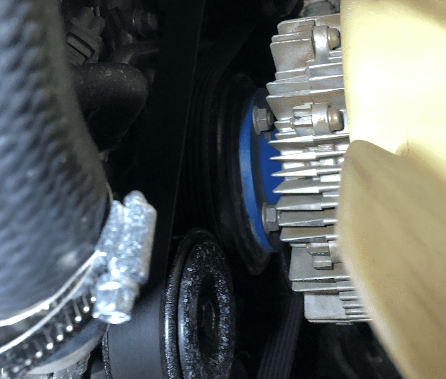

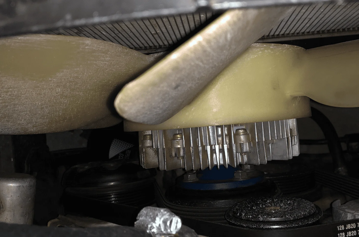

Hi, I probably will change the fan clutch when I replace the radiator, but I just saw the mounting of the fan clutch is "blue" as pics below.
1. does this fan clutch seems aftermarket? (because that blue mounting)
2. do I need to change the fan also, because it looks very bad, all over those white scratching
3. will this "Aisin FCT-021 Engine Cooling Fan Clutch" from amazon work as OEM? Aisin FCT-021 Engine Cooling Fan Clutch
Thanks for any suggestions!

The AISIN Fan Clutch is the preferred unit to go with, or you can go Toyota OEM, which is the same thing but for more money. The AISIN Fan Clutch will have a blue mounting plate just like the one in your picture. The fan does no appear to need replacement. Inspect it more thoroughly when you remove the fan and fan clutch. Fan clutches can be R&R'd and don't necessarily need to be replaced. Are you certain yours needs replacement? It does not appear to be that old from the pictures, what mileage do you have on the truck?

The bearings fail (stays fully engaged) which is one reason to change. Another is the thermostat coil on the front gets corroded and doesn't respond as quickly. The silicone fluid inside looses its properties over time/miles and will cause the fan to slip more and cool less- this can be drained and replaced.
Generally speaking AISIN recommends replacing the fan clutch when replacing the fan bracket- which is a preventive service consideration during timing belt service.

I am not sure if the fan clutch needs replacement. I plan to do this because I have to change the leaking radiator then it will be easier to change the fan clutch by the way.
My truck has 176k, and the clutch probably been changed at least once because that blue AISIN mount just learned from you.
What is the word "R&R'd" meaning?

That’s an Aisin (OEM) fan clutch, which looks to be relatively new. I wouldn’t replace it yet...unless it fails the fan clutch tests.
