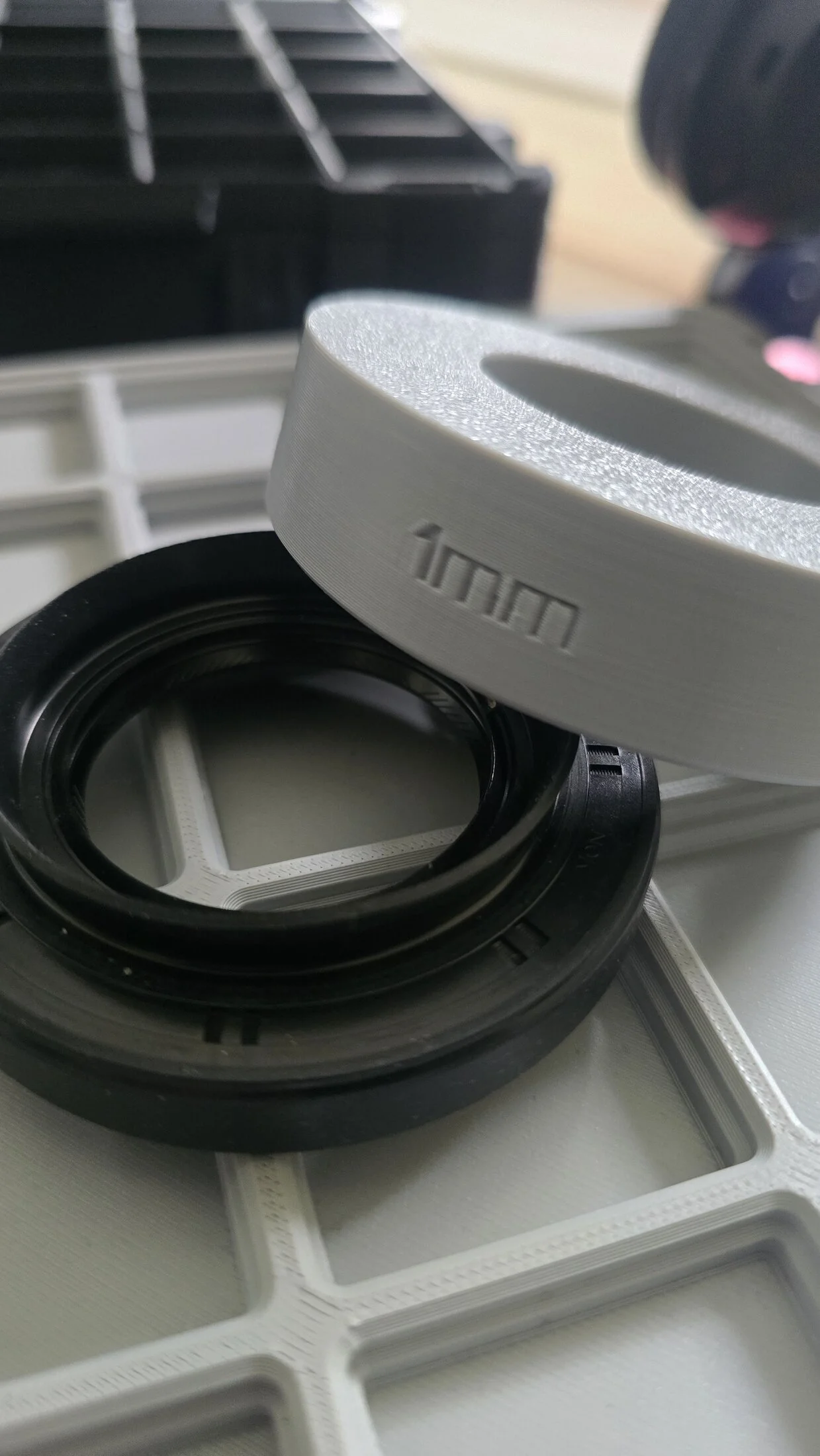

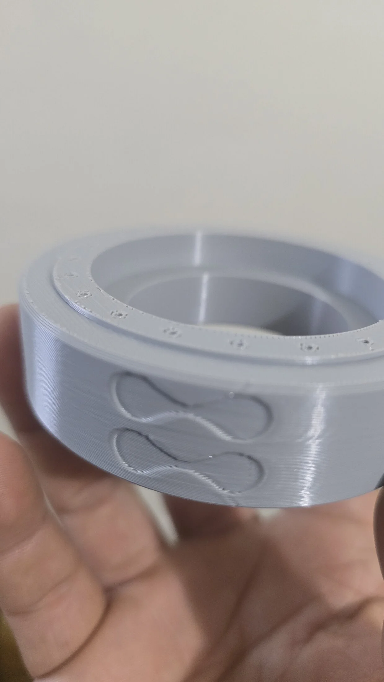

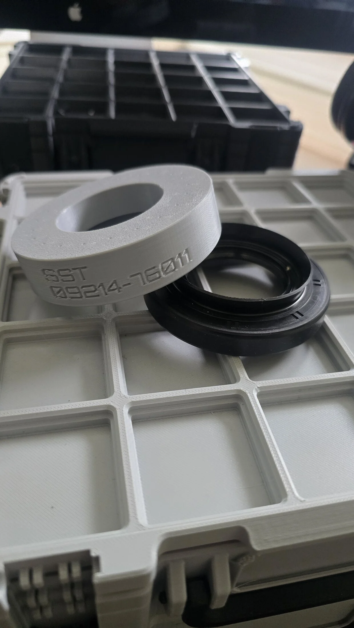

SST 09214-76011 pinion seals and crank seal driver..
Does it have a step, for the pinion seal you don't want it to be flush and you don't want it to go in too far so the output flange can have a good seal and not let debris get into that cavity.
Yup this has a 1mm step.
You can order with more or less of a step if you want.
