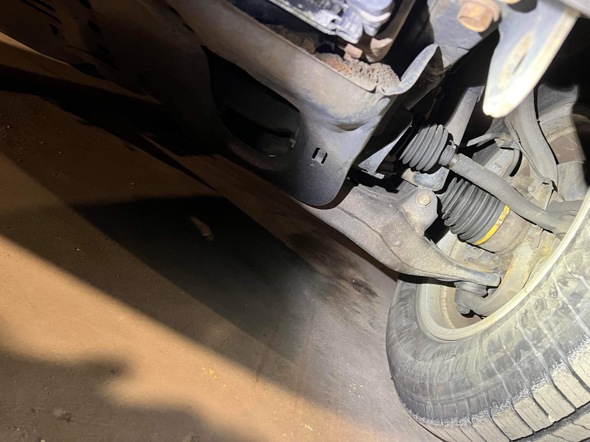

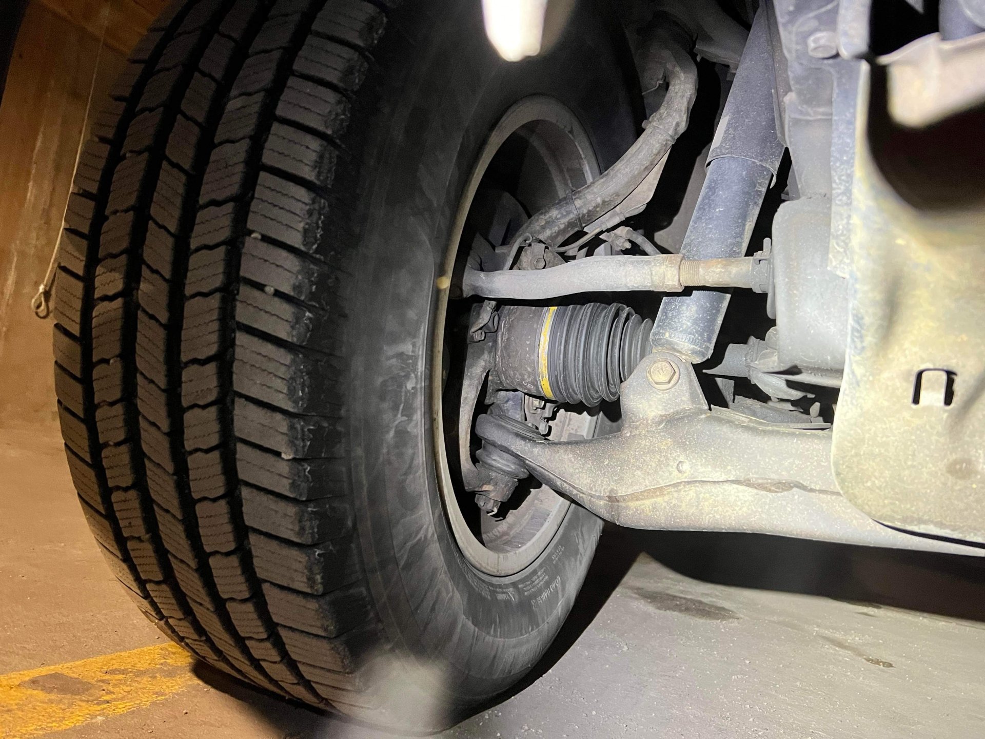

These new FDS, outer CV has yellow band.

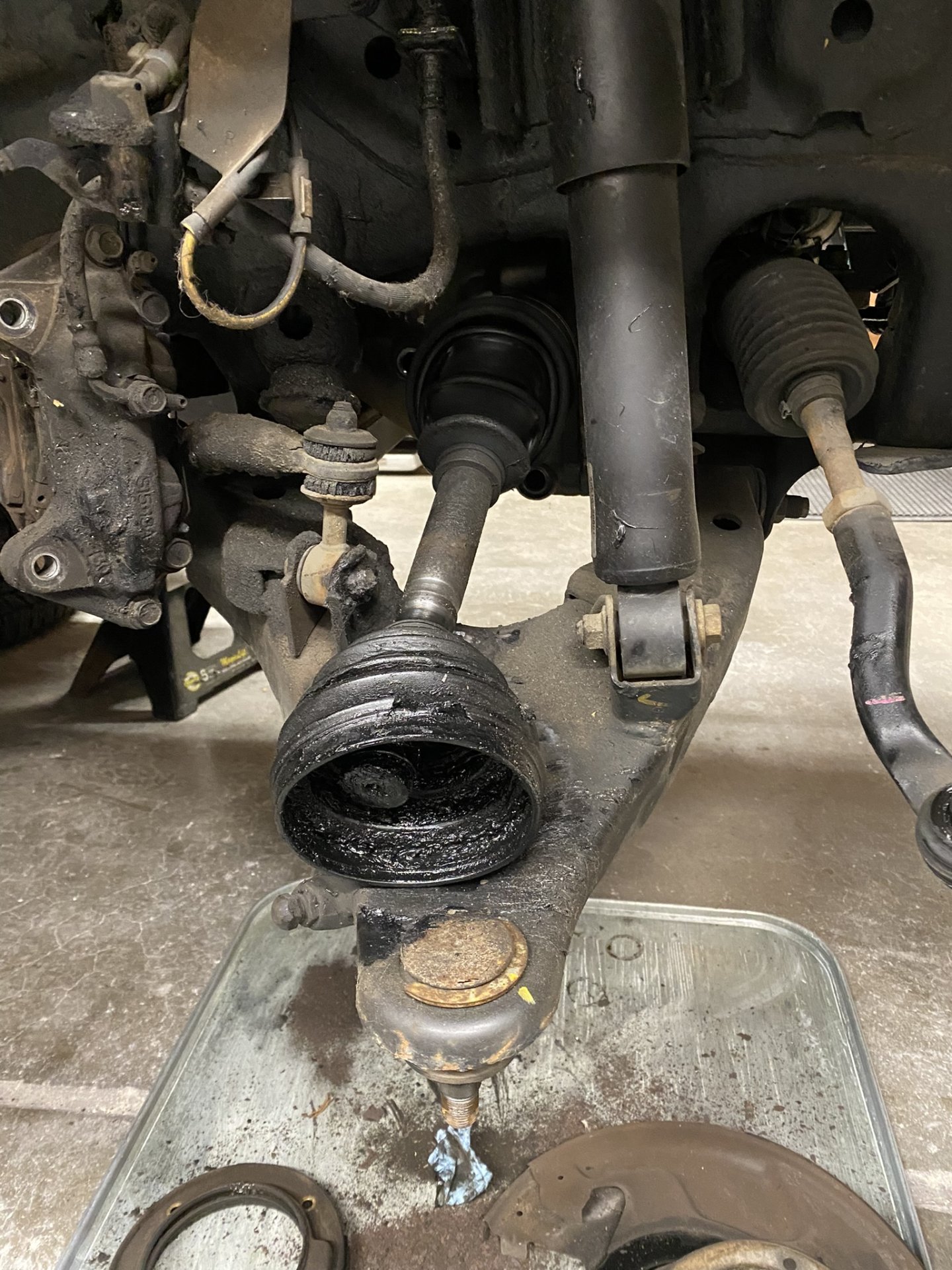

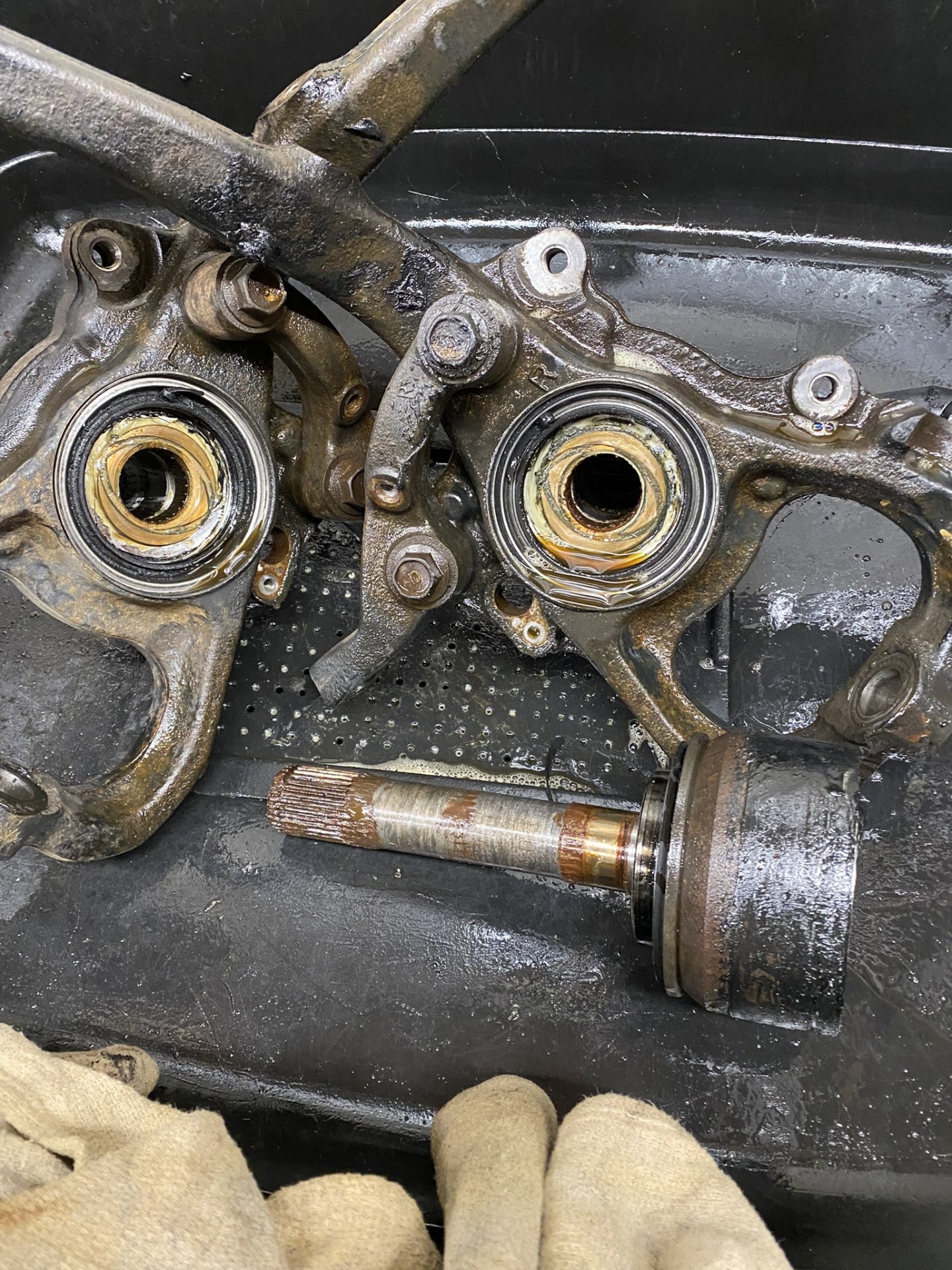

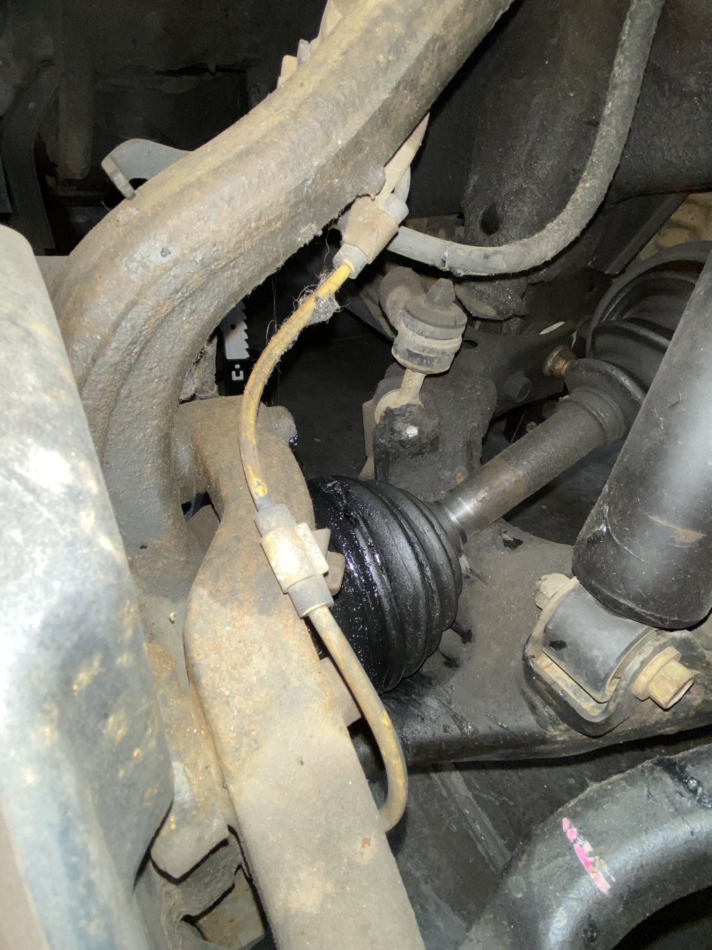

I'm R&R a busted FDS today. Which I found FDS to be aftermarket POS. Also found a very poor wheel bearing service. One in which wheel hub cavities were not repacked with grease. Bearings were burning up.
I found "Nothing correct" with the last wheel bearing service, on this 100 series. Hub flange glued on, lock washer reused and barley holding on. Snap ring loose from being reused with way to wide a gap, axle bushing & bearing not lube, chisel used on adjusting & locking nuts, wheel bearing loose, grease cap loose seal allowing water entry. Worst of all. wheel hub cavity not filled with grease, so bearings burning up. Had this rig been on long HWY drive. Likely hub and axle would have supper heat and fused to each other.

Update with some very good news-@2001LC's amazing technical know-how got me and the Cruiser out of the mountains and back home safely, until I can get the front driveline properly fixed. I cannot thank him and everyone else on this forum enough for the insight and knowledge. Just as he originally suspected, the culprit was very stripped splines on both the hub flange as well as the axle-the axle groove on the FDS was completely worn away, making it impossible for the snap ring to do its job.
@2001LC traced the issue back to the front passenger side wheel bearing-I've owned the Cruiser for about 8 years, though it has been in my family since it was new, and I cannot recall ever having the wheel bearings serviced. Though there was evidence of the wheel bearings being serviced at some point in the vehicle's lifetime, it was done improperly. Though it wasn't as poor of a job as the one in post #7, it was still enough to result in a bit of play in the front axle that snowballed for likely 10+ years and hundreds of thousands of miles until it finally gave up last night. Needless to say, from this point forward I'll without a doubt be much more on top of making sure those wheel bearings are serviced, and properly. Again, I cannot thank @2001LC for his expertise, as well as the insight that everyone provided into the source of the issue-makes me so glad to be a part of the fantastic community here.
Snap ring, was found in the grease cap. It's retaining groove in axle was eaten away. bye bye front drive shaft (FDS).
Actually Hub flange splines, were only stripped at inner few mm of splines. Seem FDS outer axle pulled inward, likely during a turn with bump or dip in road, as lower control arm (LCA) dropped (normal in driving movement of LCA). At that point, drive (forward or reverse) would have been lost without CDL on. But as it was driven with CDL on, axle must have pushed its way back out, catching remain splines in hub flange. Hub flange looked like it had been replaced before, but that hard to say. I suspect this rig had a FDS replacement, if no wheel bearings service in history. Because at some point, someone did pull wheel bearings on PS for sure. Which may have been during a FDS (AKA CV) replacement. Which if no wheel bearing service in first few one or two hundred thousand mile, would damage FDS.

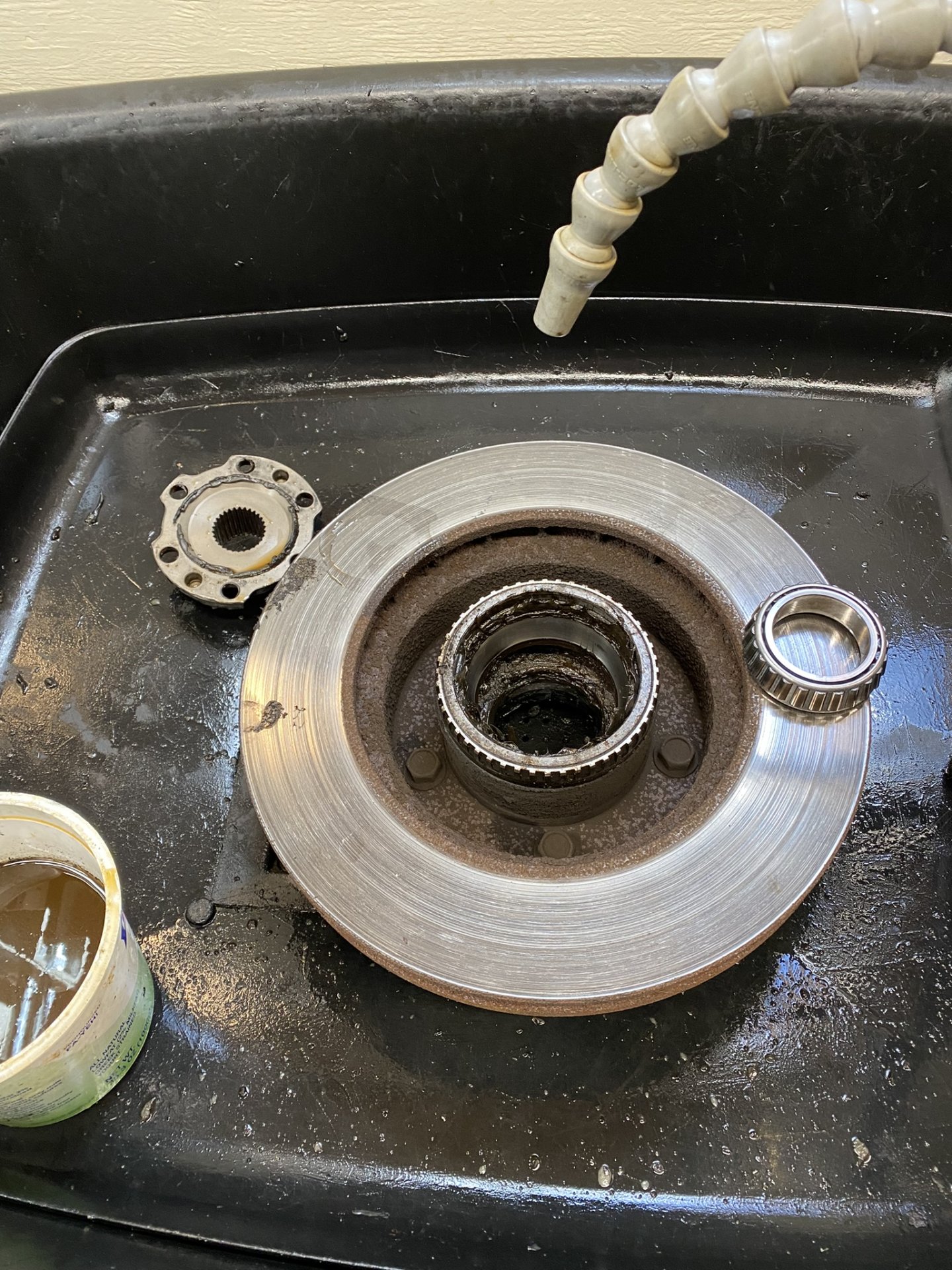

His wheel bearings had been service at some point. Several signs of this. Number one being; The lock washer was re-used. Two previously bent tabs, had been hammered out (straighten). BUT THE LOCK WASHER was NOT LOCKED on either nut. The lock nut, had come off the spindle. Adjust nut was only a few thread from end of spindle.
What I'm pointing at, is the lock nut as it sat, once hub flange removed. Lock nut was just hanging on the axle. Wheel bearings were walking off. The wheel hub was wobbling and thew off the hub cap from right front wheel. The brake rotor was wobbling, hitting cast-metal of caliper.
Lock nut was off the spindle. Behind it was lock washer with not one of the tabs bent over the adjusting nut or locking nut.
Hard to see in picture. But the outer~20 mm edge of rotor has been ground down ~0.5mm. This metal to metal pound as wheel wobbles, can separate rotor from hub. We've seen a few pictures of this in mud, where wheel fails off. VERY VERY DANGEROUS
We tighten the adjusting nut, after checking to make sure wheel hub cavity was packed with grease. Put a new claw washer on, as old had already been flipped at least once, and both side badly scored. Set breakaway preload at ~10lb. Install new lock washer. We also had to replace lock nut, as threads were damaged. But we could NOT install a snap ring. As nothing short of new FDS was going to hold a snap ring. Since axle snap ring groove was gone. Eaten away from improper wheel bearing service.
