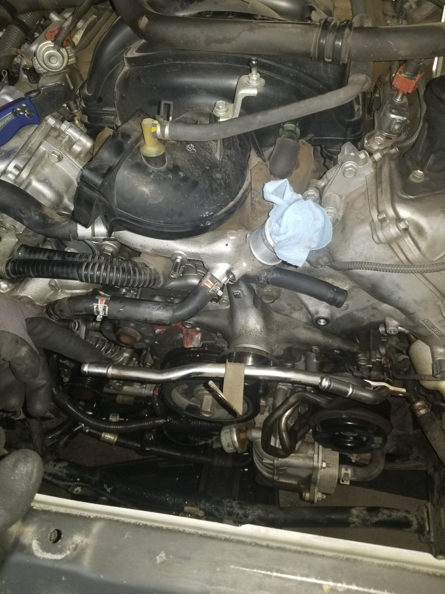

I am in the middle of a water pump job on my 2013 LX570 and am working on all the "while you are there" parts. Currently I am attempting to replace the fan clutch pulley bracket (see images). However, the hard lines are obscuring a 12mm bolt and the single 14mm is really on there. For reference, I've disconnected all of the mounting bolts for the hard lines (although some hoses are still connected) and I hit the 14mm bolt with my 1/2" stubby impact wrench. No movement at all... Has anyone replaced this component successfully? Part number is 163800S010 if you want to reference a diagram.

The initial thread and the one it linked to helped. I guess I'm stuck removing the A/C condenser to get to those hard lines... whoever packaged that deserves a lashing. The 14mm bolt on the fan bracket seems stuck. If my stubby cant get it off I worry about twisting the bolt head off with a breaker bar... the truck has always been in the south so not sure why it would be so tight.

Coolant lines which run to the a/c compressor are in the way. I'm going to unbolt it or undo hoses tomorrow.
The real problem is that 14mm bolt which took over 200 ft lbs and still didnt budge.
*Edit* penetrating fluid and breaker bar did the trick

So I found a way to do this without moving the a/c compressor or compressor pulley. Basically I disconnected any mounting bracket bolts tied to the hard lines running to the oil cooler from the thermostat housing. Then I disconnected the two hoses running from the thermostat housing to the two hard lines. This combination gave me enough room to swivel the hardlines out enough to get a box end 12mm wrench on the lowest bolt. The 14mm ended up being removed after being soaked with penetrating fluid overnight and a breaker bar.

Any special combo of tools to get at the lower hardline bracket bolt by the compressor pulley? I've been at it gingerly with a box wrench, hoping the bolt doesn't fall down in between oil filter interface and compressor. Is it the same length as the other two above it? Any tips for this one would be helpful. Hoping to avoid unbolting the compressor....
I loosened but did not fully remove the bottom right headline bolt. I couldn’t see how I would ever get it back in if I took it out. That got enough movement in the hardline to complete the work on the fan bracket.

I did take it all the way out, which made for plenty of access to the fan bracket bolts once the hardline was out of the way, easy swap!
However, fishing that sucker back in there took me an hour. Snuck it back in there with a smaller pair of needle nose pliers than before (floss lasso still in tact), and just had to repeat the process of lining it up and twisting enough for a thread to bite. PHEW... 7/10 not recommended. But better for me than to have had to unbolt the compressor.
