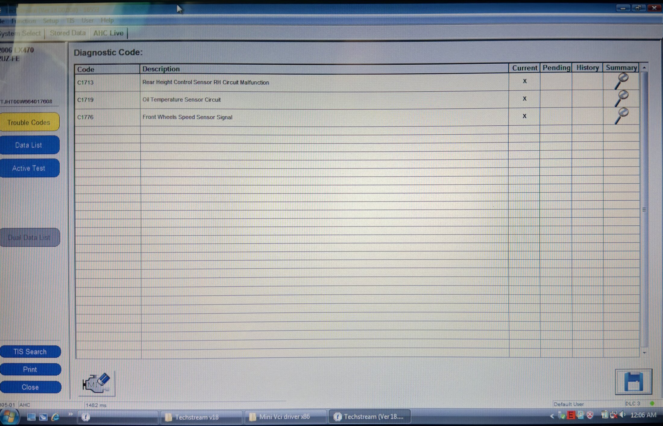

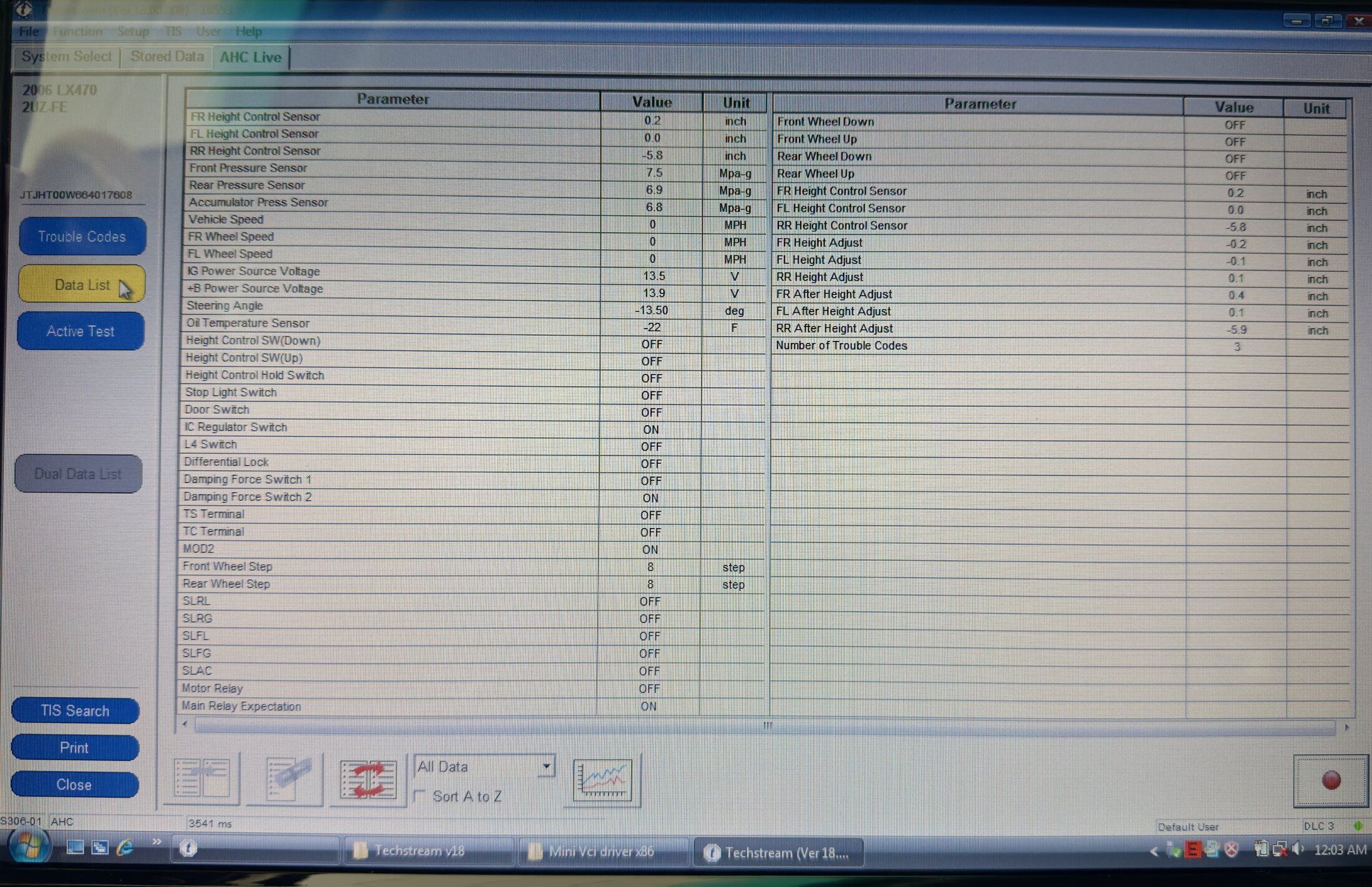

After getting Techstream up and going this afternoon, I was able to get the following data on the AHC system. This was done with the temp sensor unplugged. I haven’t received the replacement AHC switch yet, so I am not able to rule that out as a contributor. Regardless, it appears I at least have an issue with the rear height sensor, as well as the front speed sensors.
Before I connected to Techstream, I cross leveled the torsion bars, as my passenger side was 1/4” higher. I lowered it to match the drivers side. I was going about this in the same method described in “ABCs of AHC”, even though I clearly have some sensor issues.
I’m open to advice on how to proceed from here; ie, if it’s worth trying to make sensor adjustments at this point, OR,
cleaning sensors and hoping that helps; or should I begin with replacing the malfunctioning sensors.
I’m open to advice on how to proceed from here; ie, if it’s worth trying to make sensor adjustments at this point, OR, View attachment 3710693cleaning sensors and hoping that helps; or should I begin with replacing the malfunctioning sensors. View attachment 3710694

I can confirm that the front left speed sensor is inop. Driving around the driveway hooked to Techstream showed speed on the right wheel sensor, and no movement on the left. This also apparently correlates to the ABS, VSC Off / Trac Off lights on the dash. I read several other posts stating those lights were triggered by a faulty speed sensor. (Techstream didn’t identify any issues specific to ABS either)
Whether or not the speed sensor has anything to do with the AHC not working correctly - that’s yet to be determined. I suspect the rear height sensor is completely gone. Adjustment of the linkage produced no change in the numbers in Techstream.

Either way, it sounds like the lack of feedback from the front left wheel speed sensor is causing some sort of fault in the AHC. From what I was reading in a separate post about speed sensors, they tend to kick on the warning lights for ABS, TRAC OFF, and VSC OFF when the sensor or wiring goes bad.
Loosening and sliding the rear height control adjustment had no effect on the live numbers in Techstream, either.
