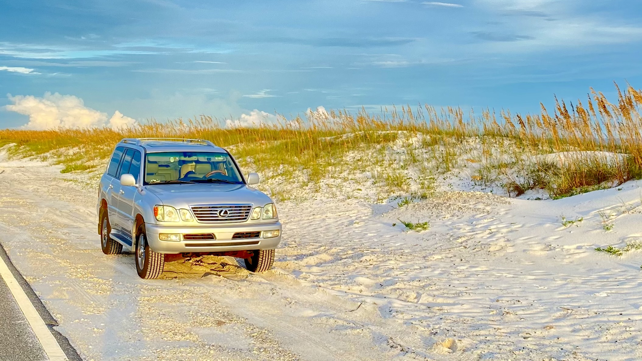

I should reiterate that it is my wife’s vehicle, and the family is currently dependent on it for daily work and kid hauling. So selling is currently my last resort, at least for the moment. I think this AHC issue can be tackled, and certainly without replacing the mechanicals of it. It has to be something electronic. And I agree with others that the system, when functioning correctly, is in fact superior to the standard LC suspension.
But, if it comes to that point, I will keep you in mind. I don’t know if Silver is your thing or not.
