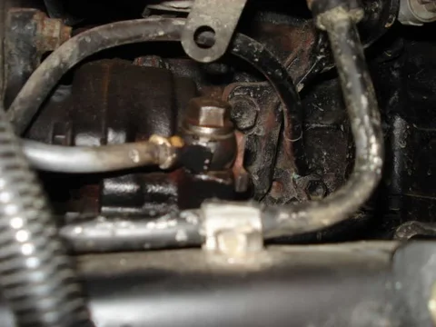

I recently made a costom power steering line from my pump to my steering box. I soldered a new galvinized line ( generic brake line/pipe) to my banjo fitting that attaches to my pump. It worked fine for about month, now I have a minor leak, which seems to be coming from my soldering job. I wonder would silver solder be better, was the galvinized line no good, or just a poor soldering job? Any input would be appreciated.
I used a 3/8 line to my 10mm (i think it was 10mm) banjo,was a little loose but I was able to drill another 4mm deeper into the banjo for a snug fit.

silver solder is a lot stronger or you can braze it. what kind of joint is it that you soldered? slip fit , butt joint this is were you get the strength. if you can make it a slip fit it would work the best.
kyle
Well I pulled the power steering line apart the other day, there doesn't seem to be a good way to drain, other than all over the place. Cleaned and preped the banjo, then soldered back together again with silver solder. With a oxy/accet mix the material had to be glowing bright red to melt. Back together and all is well :D.
The joint is a slip fit, with the metal line sliding into the banjo.
