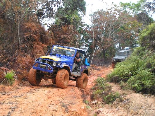

I thought the secret here are not the SO job .. are the wheels and there backspacing maybe to have one idea ..
38.5 X 14.5 SO + OME 2.5 + SR
