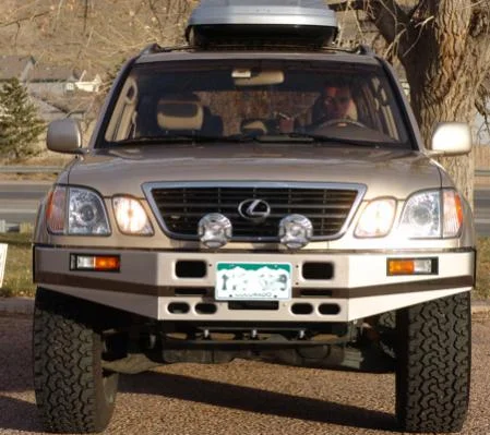

Slee blueberry to match my Slee rear is on my list of purchases in the future. I like the look and you can't beat the quality!

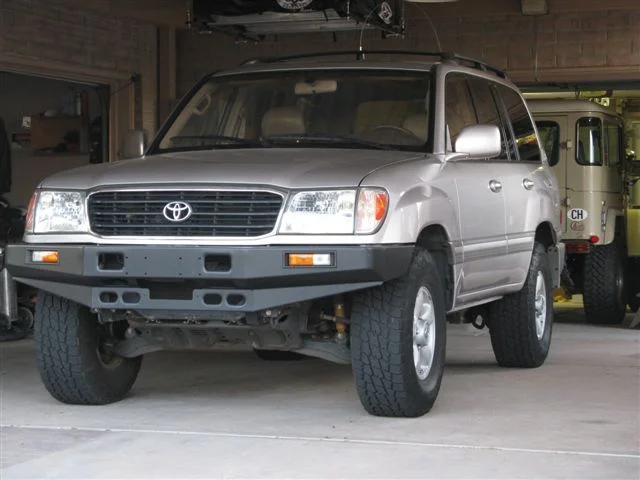

Bump-It Offroad with hoops, LED turn signals, shackle mounts, and tabs for RIGID LED bar in center hoop on LX470
Another version of BIO front bumper. This bumper has better approach and departure angles than most of the others on the market or at least when I bought it. The Slee blueberry also has great clearance.

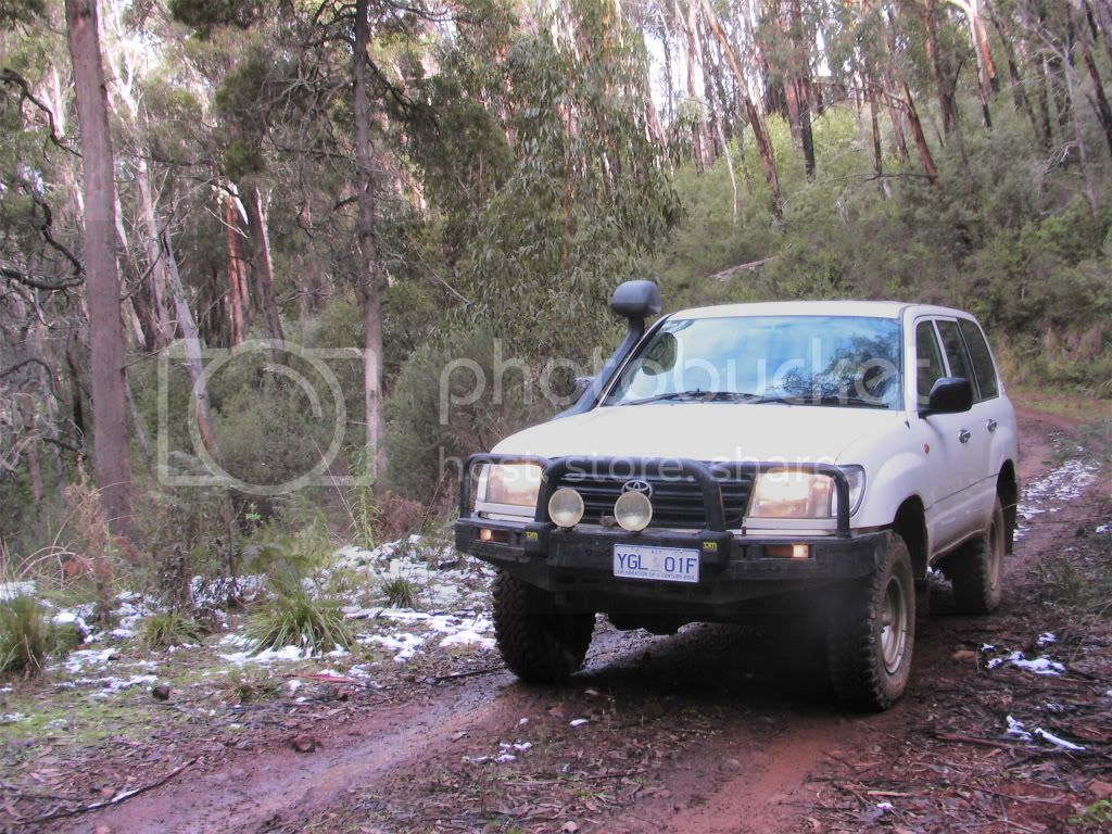

I have the 03+ arb on my 2000 LC. You have to cut off the frame horns. But you have to do that on the 03+ LC as well. It is really no big deal Took about 20 seconds with a sawzall. The holes you drill are to pin the bumper. Again it is no big deal. It is a feature of the bumper design and has to be done on all years of LC's and LX's.
If you are in deer country it is a great bumper. If I were doing it all over now... I might go with the Slee. It has really grown on me.
I have an ARB deluxe, and I'm torn: the Slee BB looks really, really nice, but the ARB....there is something to be said for all that protection......looking down over the hood & simply knowing that anything coming at you is going to lose, especially with kids, is a very secure feeling.
