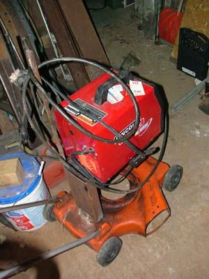

TCLA_paul made a nice cart too
:hillbilly:
attachment.php
BTW chicago's thread is at https://forum.ih8mud.com/showthread.php?t=112530
