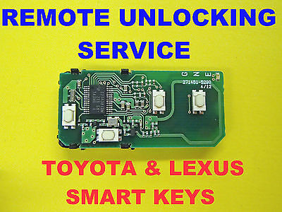

There is an ebay seller that will unlock for about $20.
I have used them twice with success.

There is an ebay locksmith that unlocks for under $20. A return is probably your best option.
