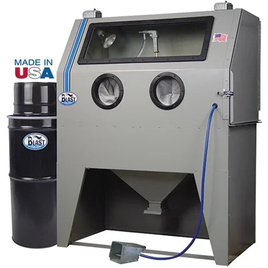

I run one of these:
With one of these:
It does 17.2 cfm at 175 psi and cycles frequently while I'm running the blasting cabinet.
I've got the run of mill Chinese (Harbor Freight) 40 lb. (?) floor standing cabinet. I run it with an older 5 HP 60 gallon vertical that I bought at Grainger which I believe is a Speedaire. If I'm on the trigger constantly the compressor can't keep up (pressure dependent - with the regulator at 80 PSI for glass bead work it might keep up.) With breaks to change or inspect parts, clean the glass, clean the dust filter etc. the compressor can usually keep up. Blast cabinets are air hogs plain and simple. I don't think the size of the cabinet that a hobbyist will have comes into play. You've got an open 1/8" or 3/16" orifice flowing full that's all there is to it.
Yes, and going for a smaller orifice is only going to increase the amount of time it takes to accomplish anything. The cabinet size will limit the size of the piece you can put into it, but the orifice size is like using a paint gun versus an air brush.
