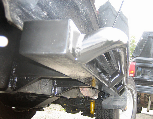

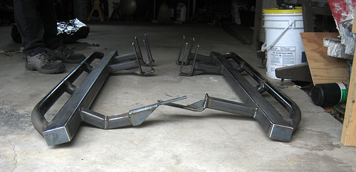

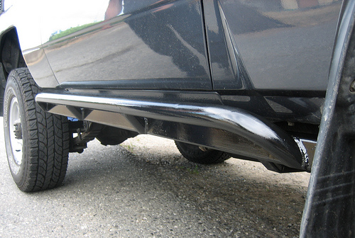

cant find a photo of the mounts but it hast the pipe on the rh out side of the chassis but i still used the u channel to mount. front was mounted off the cross member bolts
mint a troopy with rear flares i love that look
You could try Cheezy Racing. I've seen there stuff on a GQ but not sure if they make
cruiser stuff. Good quality and solid. Maybe find a mate who can weld:)
wouldnt go them, they are over east and cost the earth, got a guy who can fab it up, was just curious as to how to mount it, oh well
cant find any more photo's (not mine, i just made them for him)
but i used 50 x 50mm angle bolted to the front two bolts of the GB x member then welded bent pipe to support the main rail.
the middle and rear supports are standard U brakets .
it was very close to the exhaust but with 5mm of spacers under the exhaust rubbers it has about 12-15mm of clearance.
