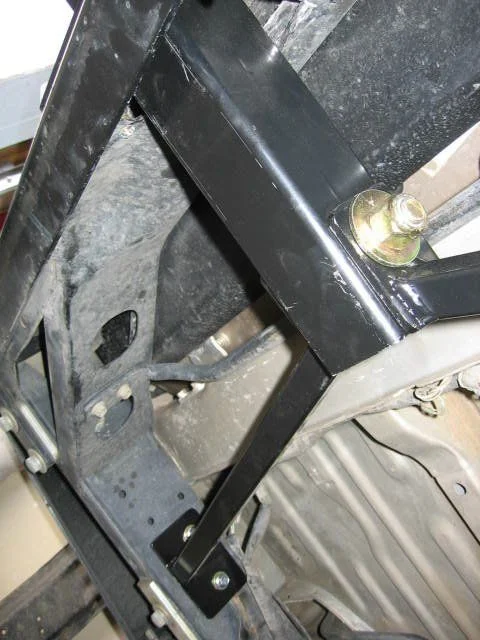

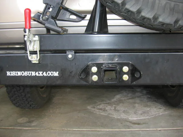

The hardest and longest part of the job is cutting the hole in the crossmember. Since I have a fairly new bumper, it already had a cutout for this receiver.
I elected to cut the hole with the bumper on. The die grinder can't get the corners without cutting through the bumper, so I used a drill to make enough notches around the corner. The other option is to remove the bumper and cut the slot, then you don't have to worry about cutting parts of the bumper. The die grinder and drill method worked just fine for me.
Next, you have to cut a hole in the backside of the crossmember. You want it wide enough you can get the nut plates in and hold while you thread the bolts. You also need to make sure the hole is tall enough. I cut the hole and then there was a 1/4" lip preventing the receiver from fitting properly. The crossmember and you are at an angle, so its easy to mis-judge (at least that's the way I see it!)
Once you get the reciver in, install the two side brackets. They mount to were the spare tire plate was. Then tie the brackets to the reciever and tighten everything down.
Using the holes on the front plate, drill the holes using a 1/2" bit. I don't have a drill doctor and it took me two bits. If the drill stops chewing, time for a new or sharper bit.
Then hold the nut plates while threading the bolts. This was easiest from the bottom so you could see both sides.

Rich - The hitch pictured above is clearly stated not for towing. If you look on Slees site, it says, "It allows for the use of 2" accessories like bike and ski racks. This receiver is not rated for towing" Christo wouldn't even sell it to someone who wanted to use it for towing.
The one I installed, is also stated not rated for towing, but it is beefy enough it could be. In my opinion, it's probably as worthy as the OEM hitch that I took off, only it has not been tested. BUT, Slee's site again clealrly states that it is not rated for towing.

No problem with your opinion. I admidt Buckey rubbed me the wrong way. I do not intend on towing anything like what you have done relative to 7500 pounds. I do not intend on towing anything with a GVW of greater than 2500 pounds, and more like 2000 pounds. i.e. a small pop-up camper. 4 1/2" bolts through the crossmember and two beams out to the frame attached with 3/4" bolts is more than stout enough for my application.
I thinks this is much stronger than the hitch that is welded to the tube bumper on my 40.
I am an aerospace (or use to to be) engineer who dealt with structural integrity as part of the job. I admidt that I am a EE and not an ME, but working spacecraft for 20 years, your skill base broadens. Am I basing this on an educated guess, yes.
BTW- The cost to actually take these through the official ratings test has to be expensive and running a business you need to understand return on investment.
Christo properly cautions people on his web page and in person. I am sure Christo would be grateful to anyone who could help rate this. Slee off road is not set up for that.
I need this hitch and am glad Christo came to the market with it and I am fully aware of the disclaimers that come with it.
