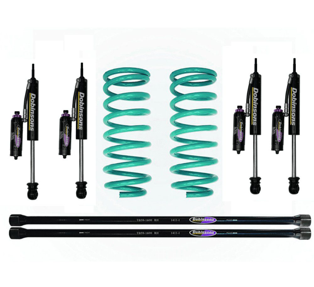

If I was going to buy a “lift kit”, I’d get Dobinsons.
Why dobinsons?
Dobinsons is top flight stuff. If you’re not adding too much weight to your truck I would recommend their progressive rate coils. Really plush ride compared to my buddies Ironman coils.
My suspension is a complete mutt with 3 different manufacturers in there.
I've been happy with the Eibach pro kit. A good medium between stock and OME. I think you can get the shocks and springs for under $600 + Freedom UCA's and Sway Away TB's your in it for $13-1400. Great on road manners, firmed up but not amish buggy "OME".
The "floating" part makes me think you'll be happiest with a set of shocks that include remote reservoirs. Slee obviously sell a set, so do Dobinsons, etc. The extra capacity combined with a lower tire pressure...you'll float. At least as well as a 5-6 (or 7) thousand pound truck can float :cool:
I've got the Dobinsons and I'd never go back to a simpler setup.
AFAIK Dobinsons just released a set for the IFS trucks. Slee's stuff is also great, although I don't have direct experience with their shocks. I haven't had any of the Foamcell Pro shocks either, but from general sentiment here they seem pretty good.
