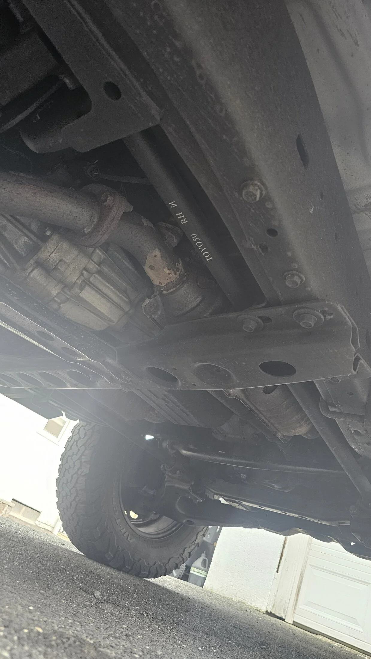

Treated with fluid film, 265k miles

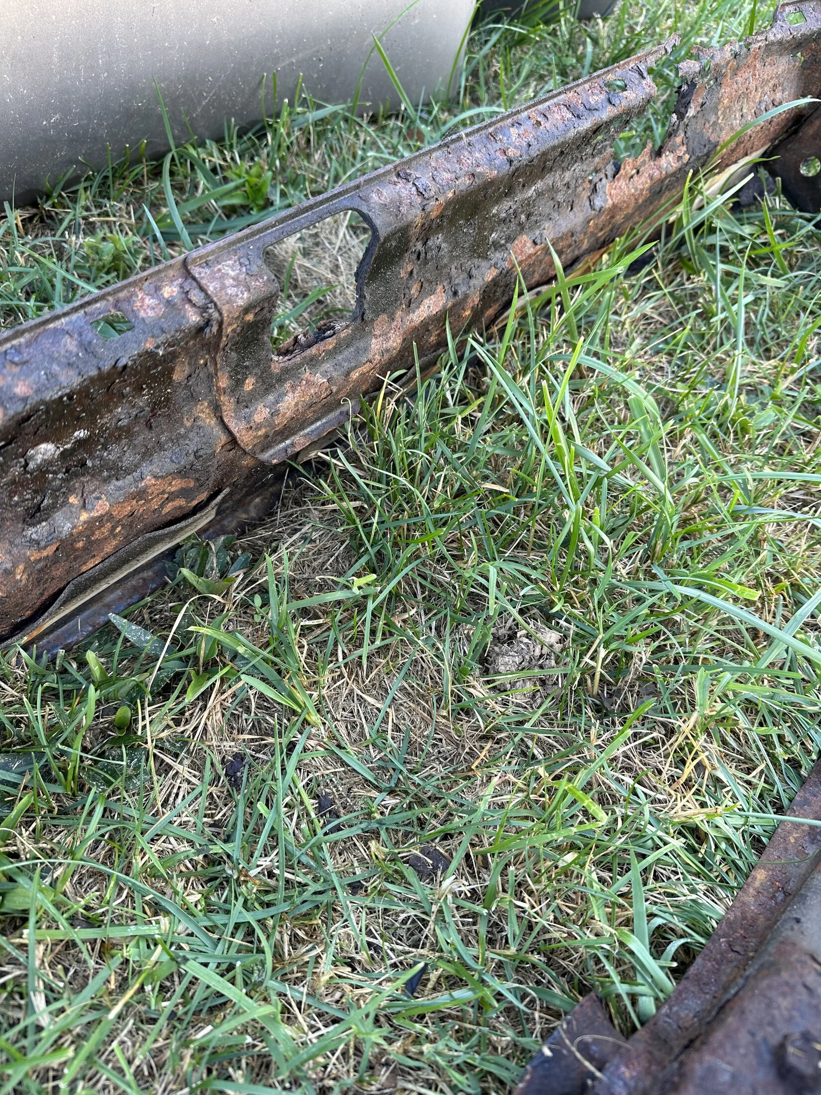

Not treated with fluid film, 275k miles
Both vehicles are in the same state. The one that is rusty started with some rust that was not treated. The one that is not rusty, started with no rust and was treated before it saw any salt. The mint condition one will last forever. The rusty one runs and operates perfectly, but the frame is disintegrating underneath even with fluid film over the past five years. The rust slowed or stopped everywhere it was treated, but the rear bumper above was an example of an area that didn’t get ever pulled off and this vehicle likely had its ass dipped in the seawater before my ownership. Interestingly, the rusty vehicle lived on Guantánamo Bay….so probably had an interesting life.

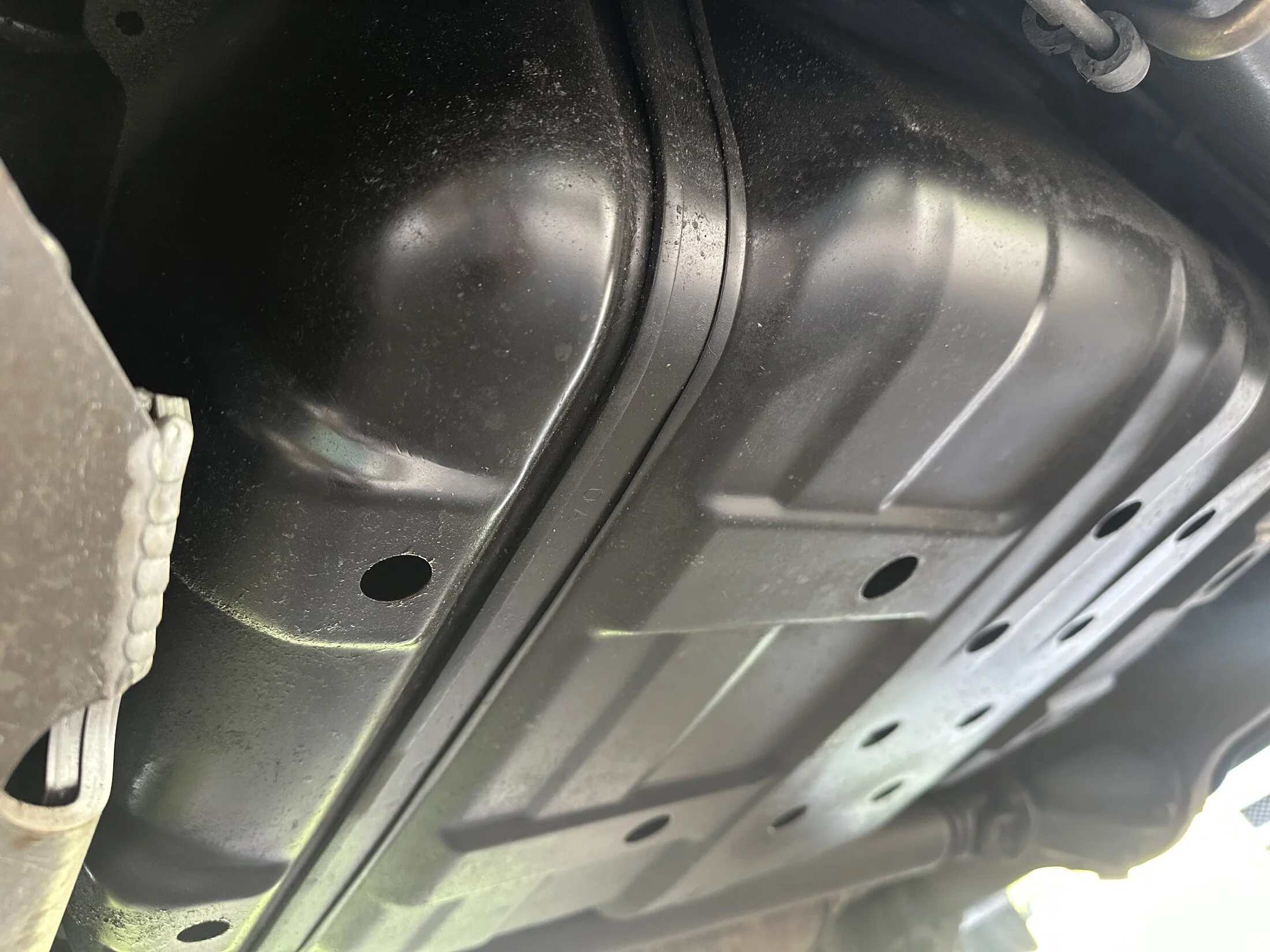

I got my 100 from California and I have used their undercoating since 2022. The picture was from this winter with last year's undercoating.
Supposedly they use Carwell T32 undercoating.

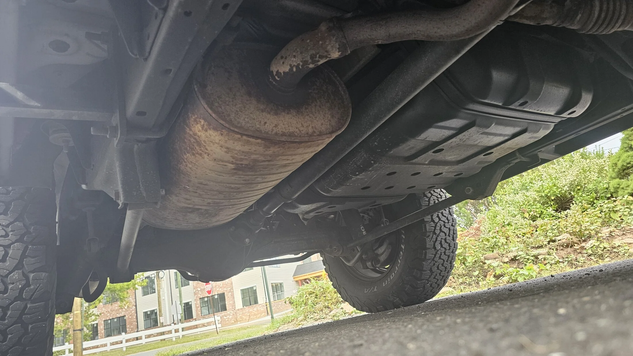

Surface shield is good stuff, I keep all my Toyota's protected with it.
I live near the beach, and my 3rd gen 4Runner (3rd gens T4R are famous for rusting in half) is still rust free because of the surface shield protection. I re-apply every 2 years or so.

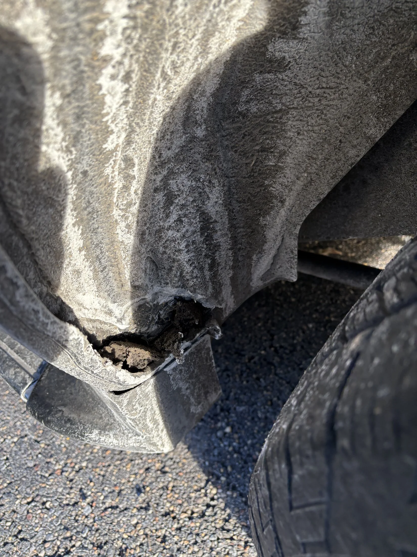

This morning, being disgusted by the crust of salt on my LC, I wanted to point out the spot that is super easy to miss when undercoating. For those in the south that just got pounded with snow - if they salted the roads, be sure to clean this spot in front of the rear wheels out when you wash up. I can feel the rust happening in this pic…
