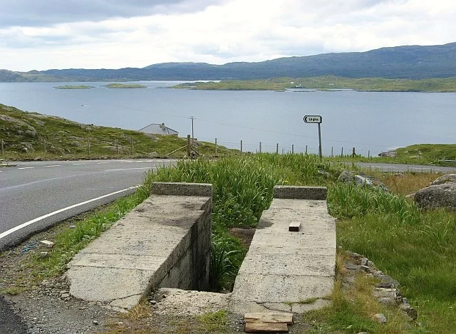

I have another potential idea, but this depends on where you live. If you can get access to one of these - your problems should be solved:
