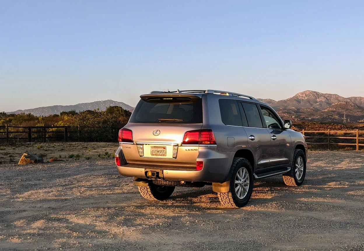

Just run a normal spare. @TeCKis300 has a 12.5 LRA and ran a 33 x 12.5” spare underneath.
Certainly an option. The original spare fits; I was looking for improved ground clearance.

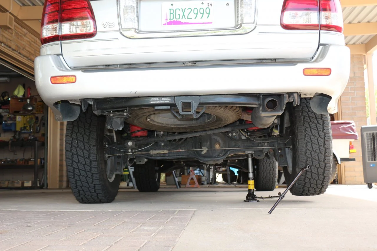

Like this.

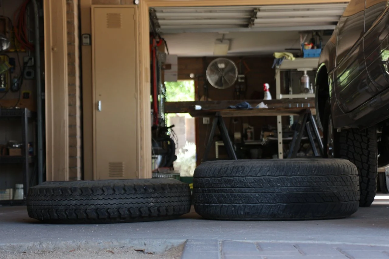

Not mine. Pics are of a 100 with the 79 series split rim

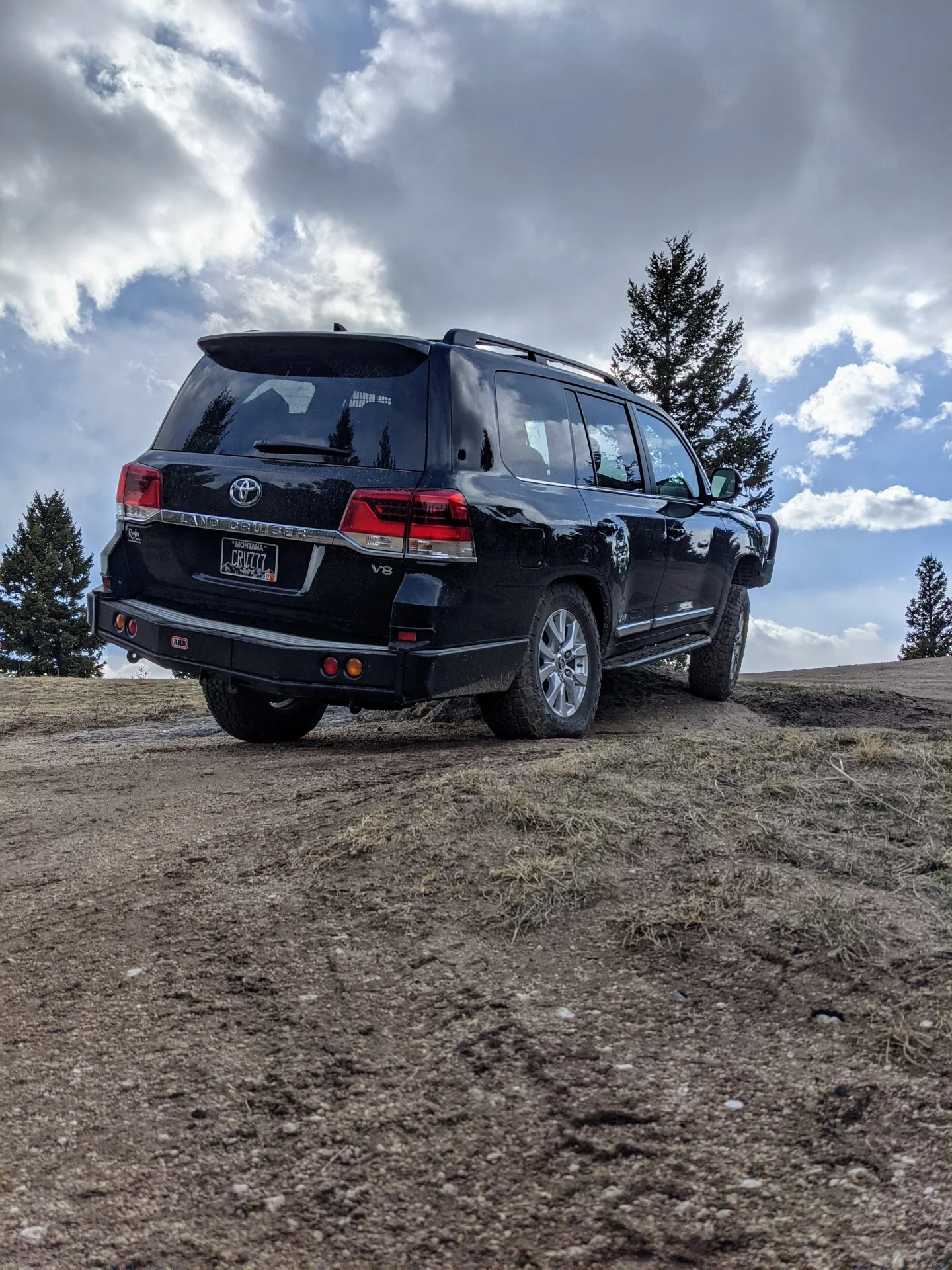

Not the skinniest, but here's what a 275/65R20LT (34.1"x11"), looks like under the boot with an LRA 12.5 tank. It's about what stock is, or maybe just a hair lower.
I previously had a 305/55R20 (33.2"x12.3") and was not happy at how much lower it hung in the rear. I believe any of the smaller wheels or narrow tires should fit fine. Though not sure a 16" wheel can work for the 200-series front axle because of brakes.

Confirmed. The 16" Toyota split rims do NOT fit on the front or on the rear.
