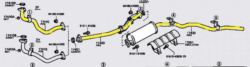

I was crawling under the beast today after a long run in the hills checking things and noticed that the (non stock) muffler is starting to show signs of age. The seams are rusted and I would give it a year until they give out in areas. So For a FJ45 with the long run from the front to the rear, no CAT, and stock engine, anyone have a brand name or info for a close to stock replacement. Want to keep the back pressure within the engineered base line.
Thanks
No were in Idaho. Went to a few places today Discount muffler, and Midas, and it seems as no one really does the matching of the muffler to engine size and RPM to get a match flow any more, just "this will might work" kind of replies.
With the pipe length/size from the exhaust manifold to the rear tip outlet, that's a bit over eight/nine and a half feet and two small of a muffler will create trouble for the engine in time, and to big or free flow can do the same. I got this info from a guy that use to race cars for years and he tells me it is a bit of math play when it comes to the correct muffler for an engine regardless type. High altitude to sea level to 100 degrees to below zero the engine needs to breath right, that's his words. He say that the manufacturing companies put lots of work an money in the old days into getting the correct muffler for a car / truck.

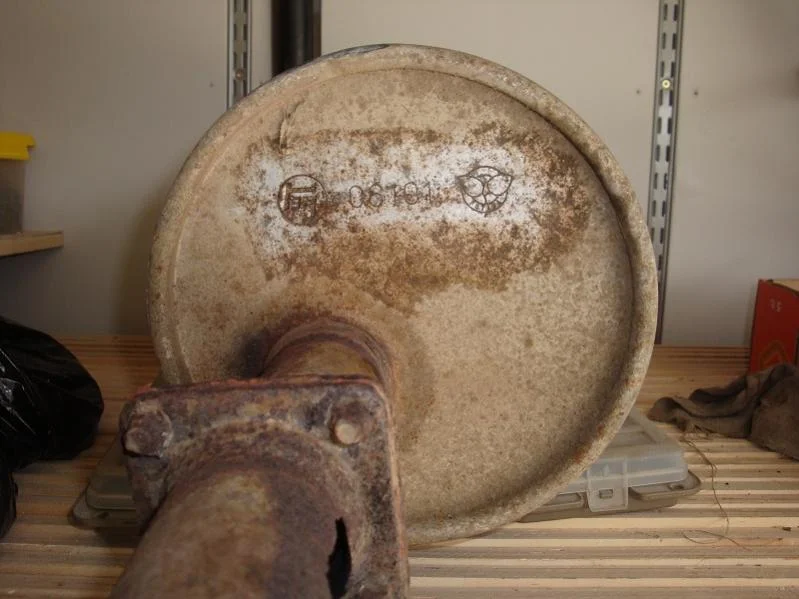

1977 Stock Muffler
I replaced my stock muffler recently.
Not sure if this helps, but the [STRIKE]circumference[/STRIKE] diameter is 8 3/4" and the length is 19 1/2".
I kept the muffler for reference if there is any other info you can gather from it.
:cheers:
