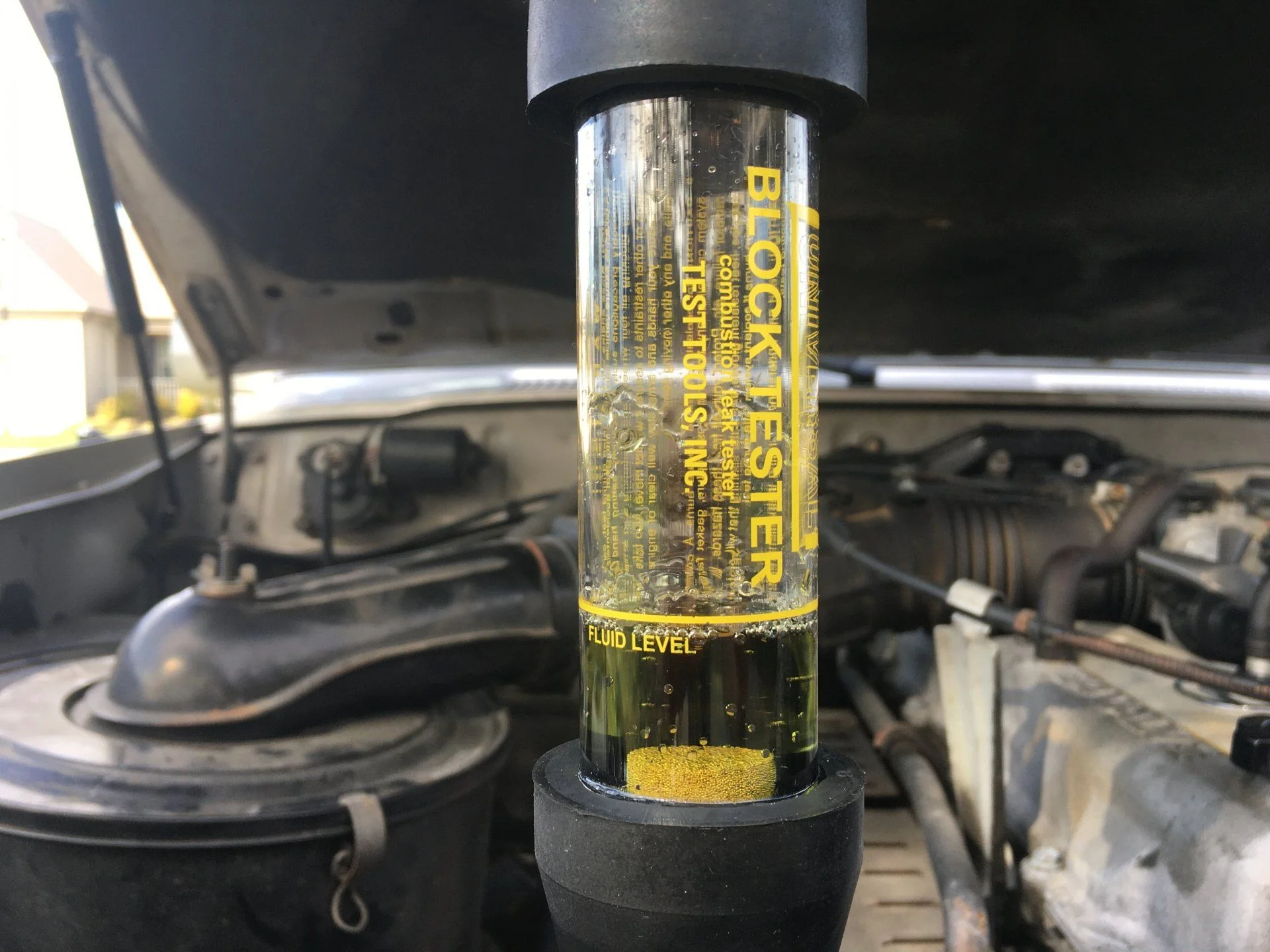

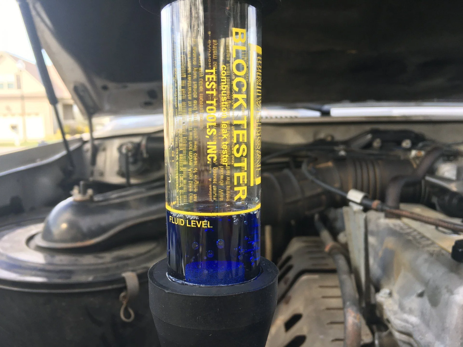

Just finished the test.

That's true. The truck started stumbling this past weekend. The truck's CEL came on as I was driving home. The code came up as a P0306 code (misfire in cylinder no. 6) and I thought it might be a bad spark plug or any host of other things. I pulled the no. 6 plug and it was wet with mostly oil. I initially thought that its valve cover plug seal had gone bad, that maybe I damaged the seal surface when I put the new one in. Then I saw that the coolant overflow tank was completely empty, the radiator coolant level was very low. The coolant had an exhaust smell to it; I immediately checked the oil fill cap. Milkshake. Ordered the block test just to by 100% sure.

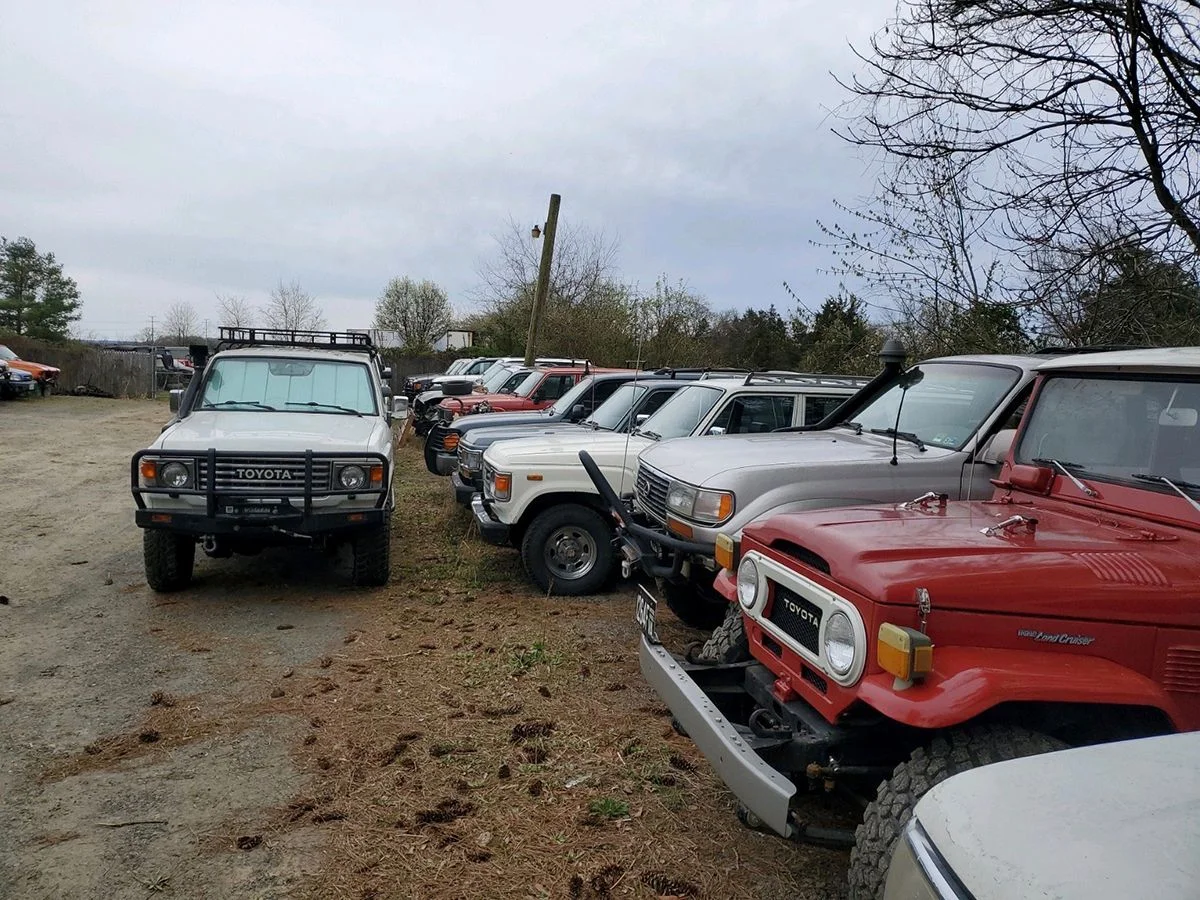

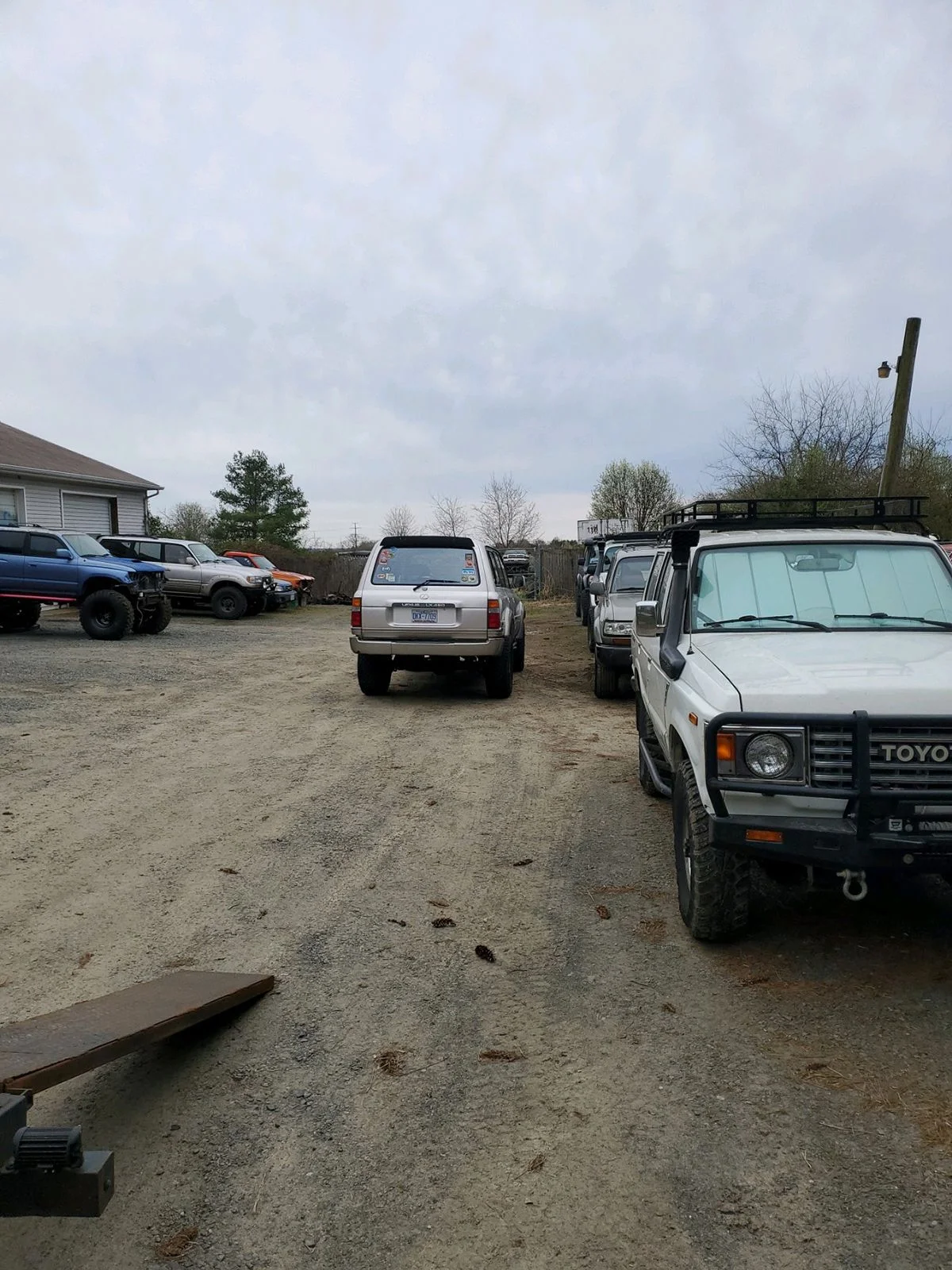

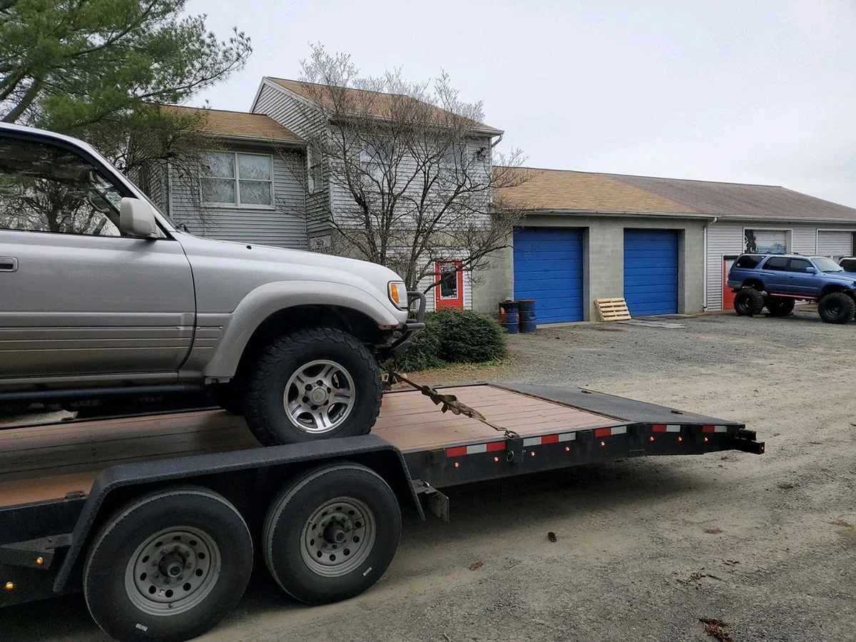

Today the truck was dropped off at Ryan's place up in Bealeton, VA. Shout out to @OTRAMM
I can safely recommend the guy that did the vehicle hauling. Da Kine Hauling out of Williamsburg, VA was recommended by Ryan and they did a great job. I didn't come away feeling like I was pinning a hundred to the truck and wishing it luck. The guy snapped some photos of the drop off and made sure to show that he had arrived safely.
View attachment 2628008View attachment 2628009
From what I've seen and heard, your truck is in good hands with OTRAMM. Solid choice for LC work. Hope you get it back soon.
