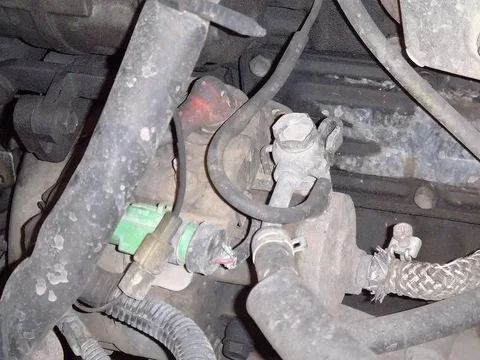

pull off you vaccuum pump, see if it is frozen or if it's your alternator.
Pictures
There she is.
