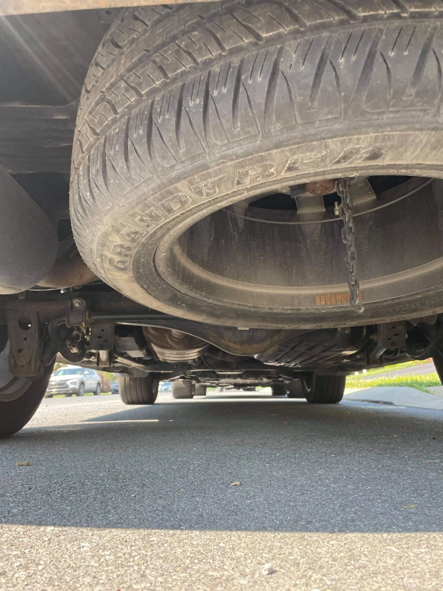

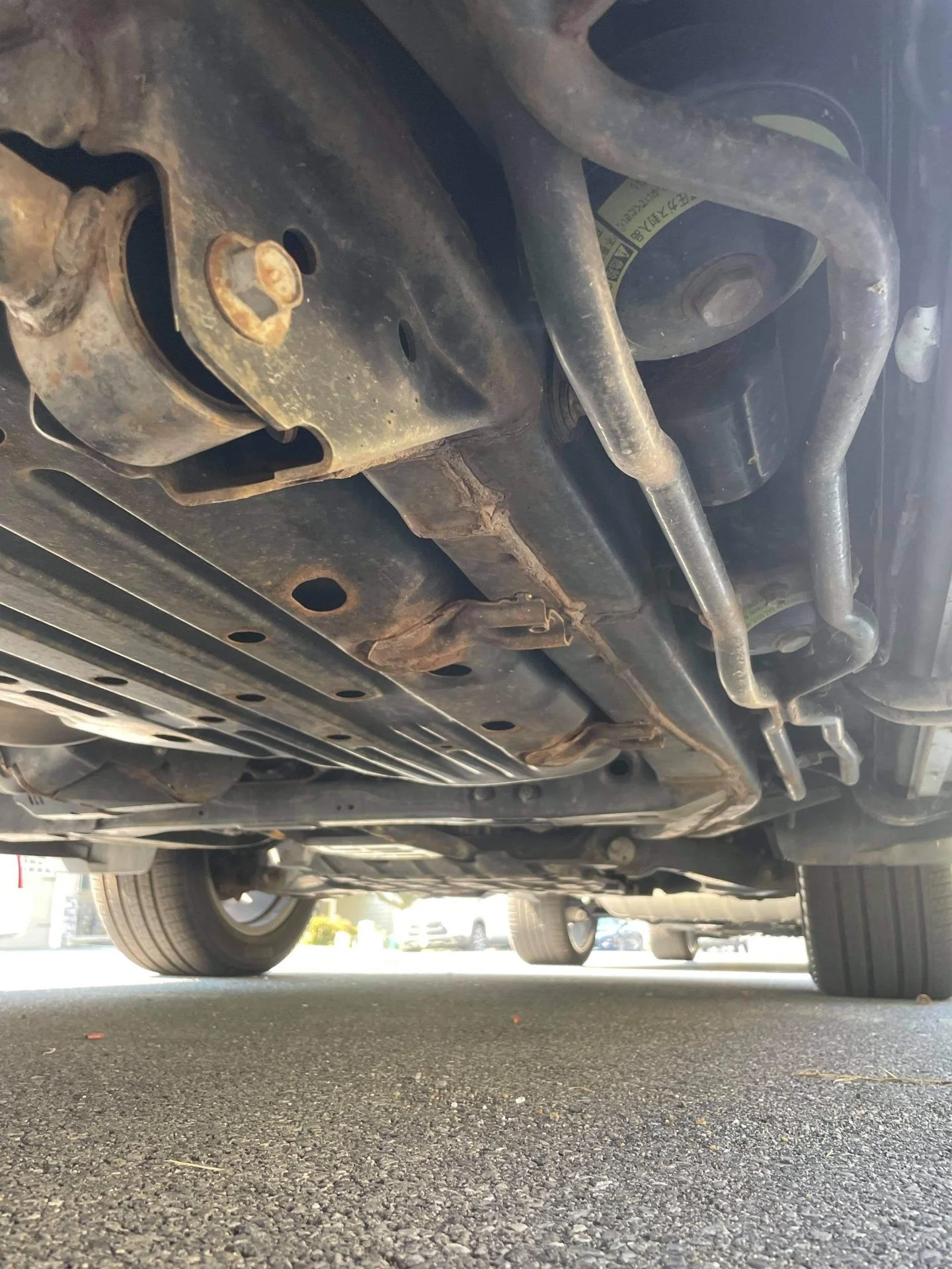

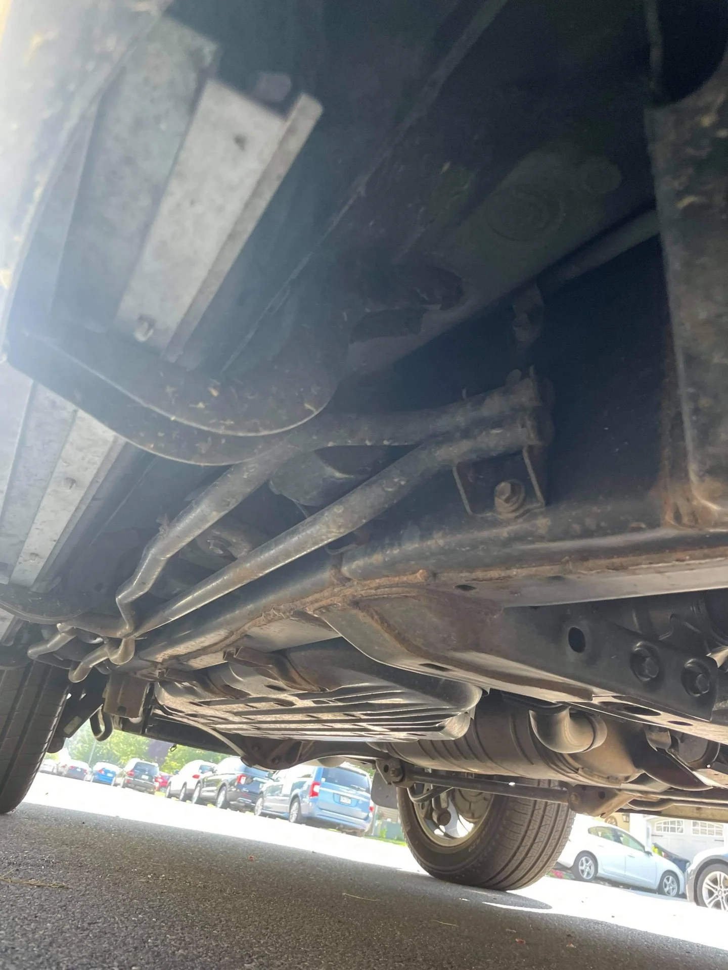

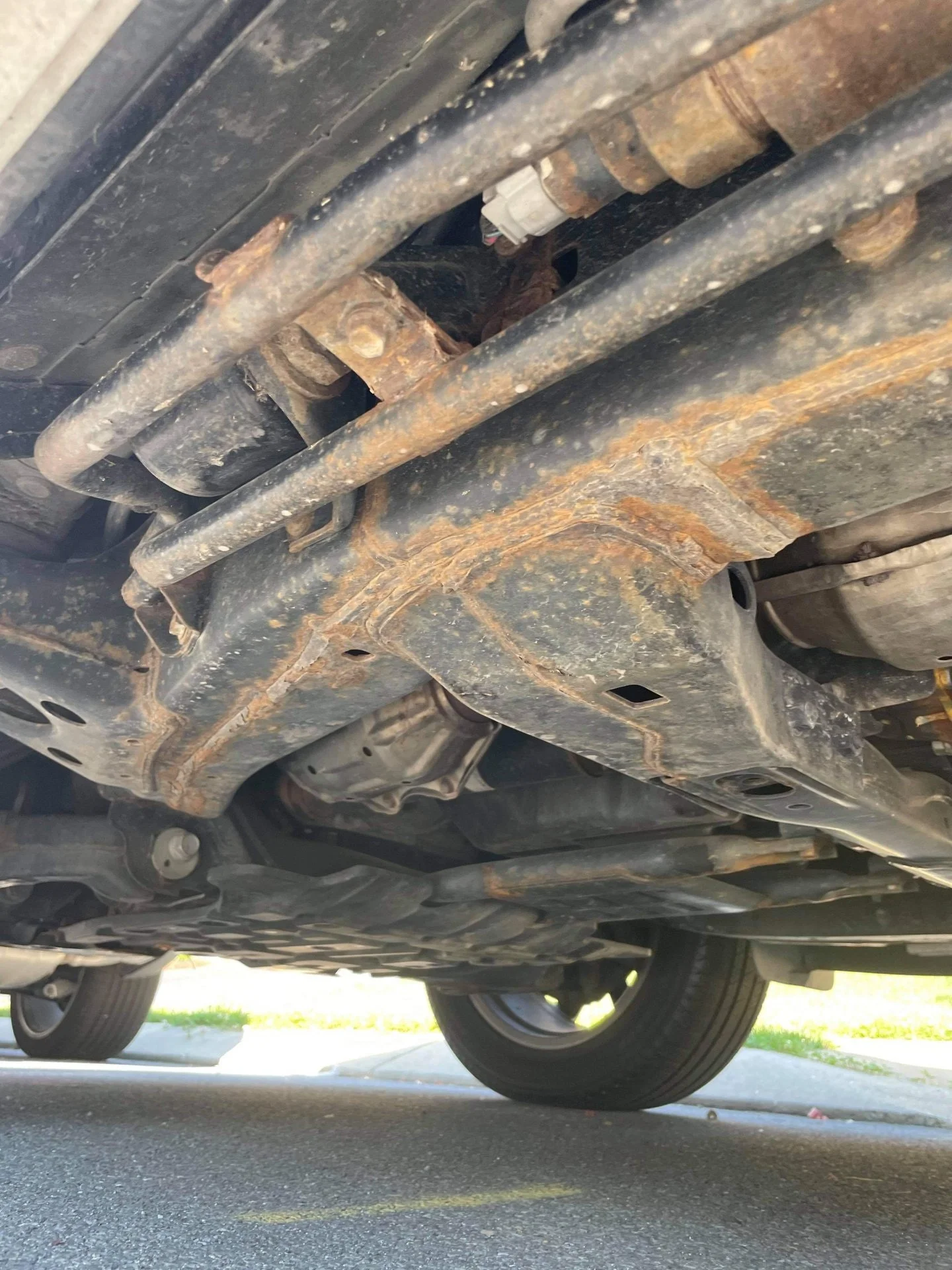

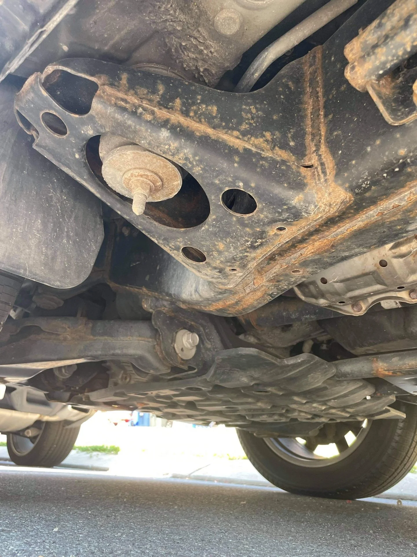

Hey guys I’m in the market for a LX570
I know the market is high now but my current car is giving problems and I need to get a car ASAP for the family.
i found a 2014 with 95k miles for $39k
Car seems good all over but I’m not sure about the undercarriage can anyone give me they opinion if it’s ok or too rusted.
It doesn't look too rusty to me. Looks to be surface rust but would be worried there may be some rust hidden in the body or under some of the skid plates or in the frame that I am not seeing. If bought, definitely clean the underside well and apply a rust preventative treatment like fluidfilm regularly to help keep it form getting worse.
I'd make the decision on things other than that rust. Its treatable and not a dealbreaker. You don't indicate where you live, but get it coated in Fluid Film or your favorite preventative right after you buy it.
It looks pretty clean to me. If you’re worried about it, maybe pay someone to clean it up and then apply a fluid coating

This. Rust is a non issue. Regular oil changes? wear and tear on interior parts? Accidents?

I live in the south and always try to avoid cars north of Tennessee if possible. I would say that for the area it's in, that's not a lot of rust relative to what I have seen on other vehicles. But it's slightly more than I typically see on a southern car with similar age and miles. As others have pointed out, it appears to be primarily surface rust, which even the southern vehicles get a little of, and would be treatable. As for the unseen rust, that would be tough to say, but I'm sure it has some.

That's more of a slight patina than rot. Normal for the east coast. I bet the tow area is starting to flake and the transmission bash guard is on it's way. As stated above just start treating it every year with fluid film or woolwax. Every season. It will last long time. This is not just for a LC. Any vehicle in the rust belt should have the underbody treated every year even brand new if you expect it to last. If your leasing who cares?
